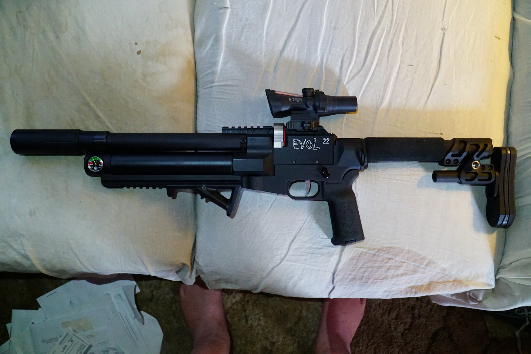

Well the EVOL arrived today and I am beyond happy with it. Shooting right around 42 fpe ootb with JSB 25gr. Sending the 20.2 NSA @ 930 fps.
Reg seems to be just a touch under 2000psi and with a 4000psi fill I'm getting 4 mags worth.
The trigger is sublime as expected.
Sound wise it's got some pop, but much quieter than the EVOL mini I had a while back which was pre STO insert. For its size the STO insert does an excellent job.
A little disappointed with the DonnyFL adapter. With the adapter on I tried a variety of different moderators and without fail the shots spread out a bit. IMO the DFL adapter should have an air stripper cone to redirect the air back into the shroud rather than just an empty space with a flat end.
Too rainy outside for some portrait shots..... LOL. Kitchen table will have to do.
Want to update on the DFL adapter. It doesn't seem to have much effect on pellets, but does impact the slug accuracy a good amount. Will be nice when I can stretch it out - but the EVOL does not appear to be a backyard friendly kinda airgun (at least for my definition) so will have to wait for a range trip.
@ctshooter Not sure how much the moderator design differs between the Evol .30 and the Mini, but in the thread below Dana provides and explanation concerning the Evol’s shroud and moderator system design and how using a Donny FL adapter disrupts this design. See posts #21-#23 https://www.airgunnation.com/threads/american-air-arms-30-evol.1270284/page-2#post-1291436
