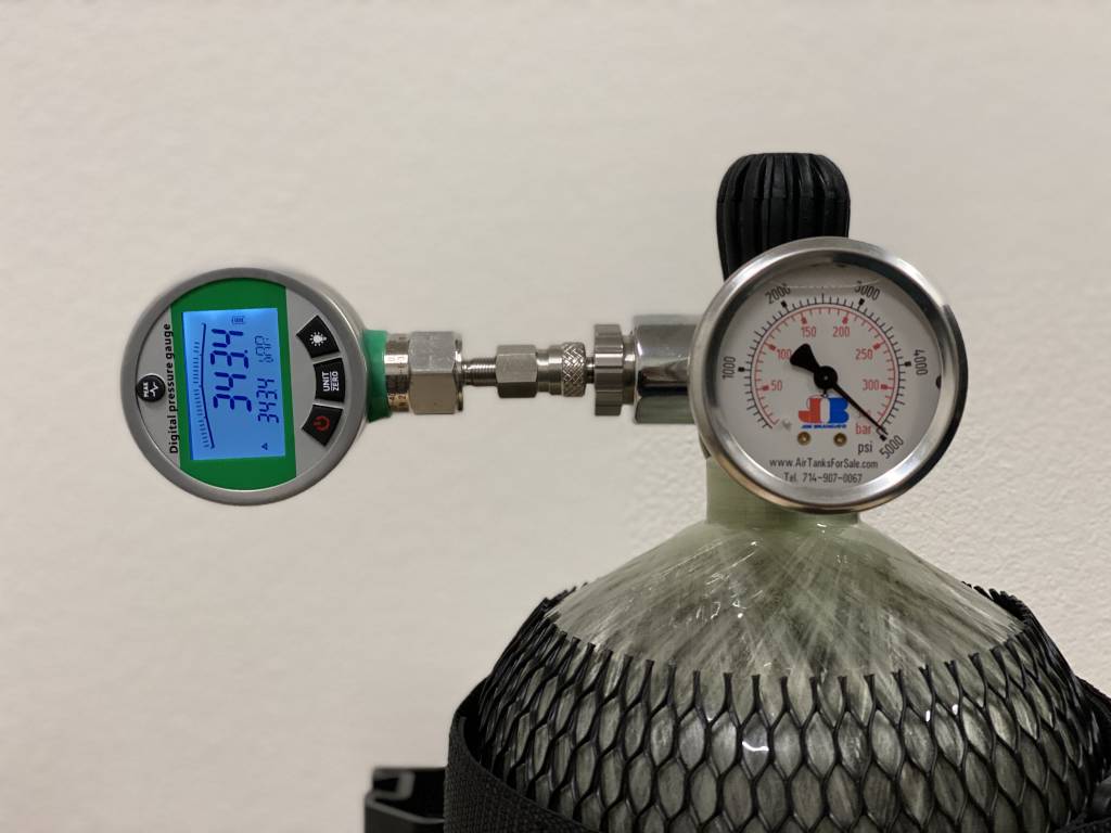

Tonight I filled my 'Great White' (9L) tank from 272 bar/3945 psi to 352 bar/5100 psi, shut down 30mins for tank cooling(not for Yong Heng). Then I filled the tank to 355 bar/5160 psi. So overnight the tank pressure will still hold at least 340 bar. I live in south California, tonight garage temperature was 27℃/80℉.
My Yong Heng is hardcover version, as manufactory call it 'standard version'. I always fill my tank like this over 1 year, never got any problem. I talked to the designer earlier this month. They tested that it can reach 6000 psi and under 75℃ is normal working range.
After 4 hours tank pressure dropped to 4979 psi/343 bar
where can one purchase the digital guage u have & how much ? thanks
