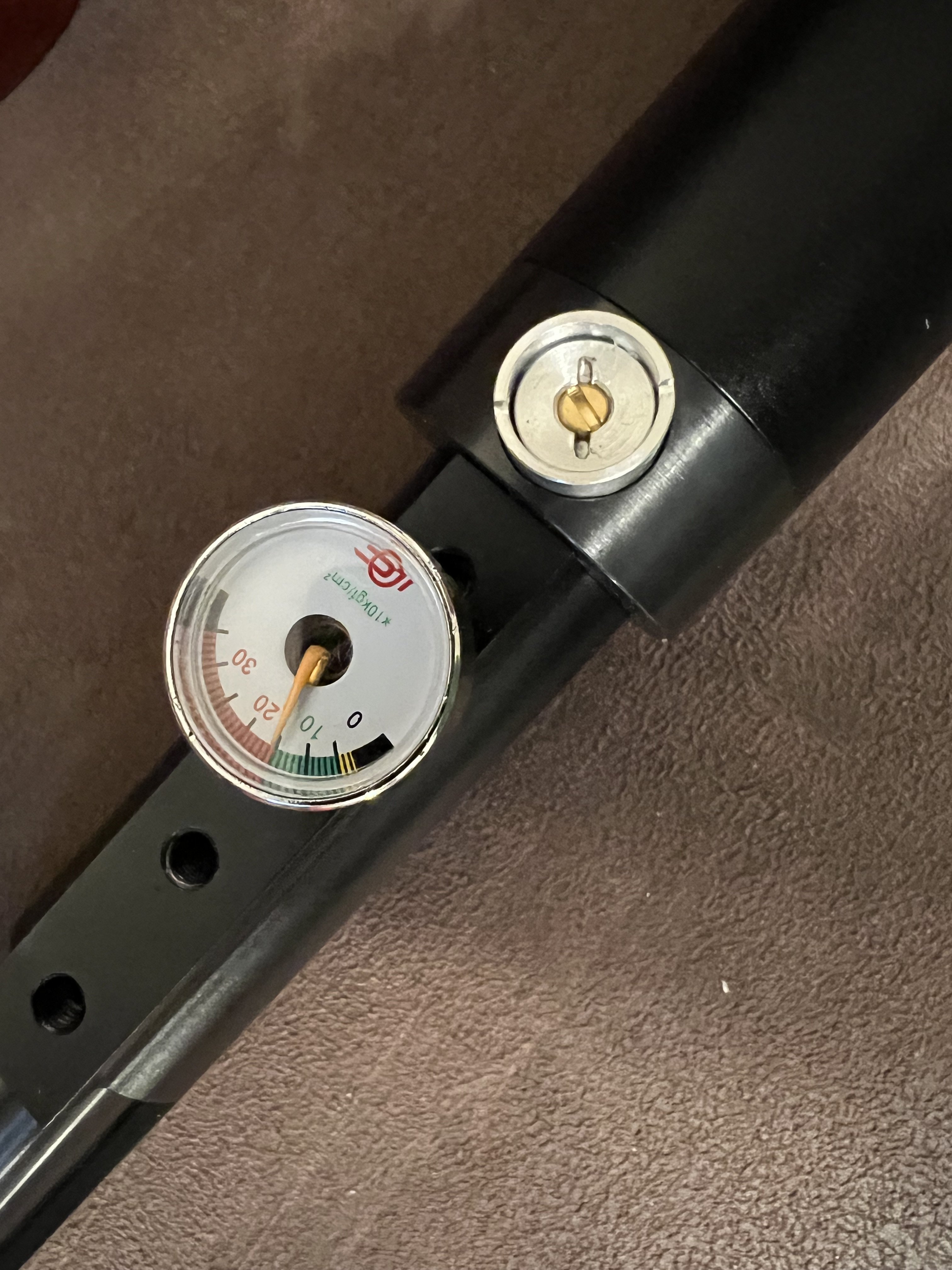

Here is a photo from the regulator. (Borrowed from another thread :), mine is all brass, but same setup)
I think the regulator can be unscrewed somehow by turning the inner or outer steel parts. Not sure how yet.
