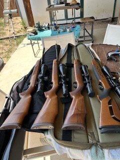

Great choice, I have four of the HW95 variants, a 95 in .177, Beach stock, a 95 in .20 in a HW walnut stock, a 85 in .22 beach stock and a 98. in .177 I love them all. I have a Tinbum full power kit coming for the 98 should be hear next week, Ill post about when I get it installed. I also have a ARH adjustable kit I'm putting the 95, .177 tomorrow, comes with 3 spacer from sub 12 to full power. Im going to put 2 spacers and see how it shoots.
Great rifle choice, welcome to the rabbit hole. I, like many others have a couple of HW95/R9 rifles. They are very accurate with a light hold and work well off of a bag with a slippery surface like a cotton handkerchief.
The stock iron sights are awesome, I can hit cans at 50 yards with them. However, a BKL 260 droop mount and a Hawke Airmax one inch 3-12x44 scope are a great choice for optics.
Try the H&N Field Target Trophy .177 452 and 453 head sizes. I was hitting quarter-sized spinners off of a bag at 55 yards with mine this weekend.
