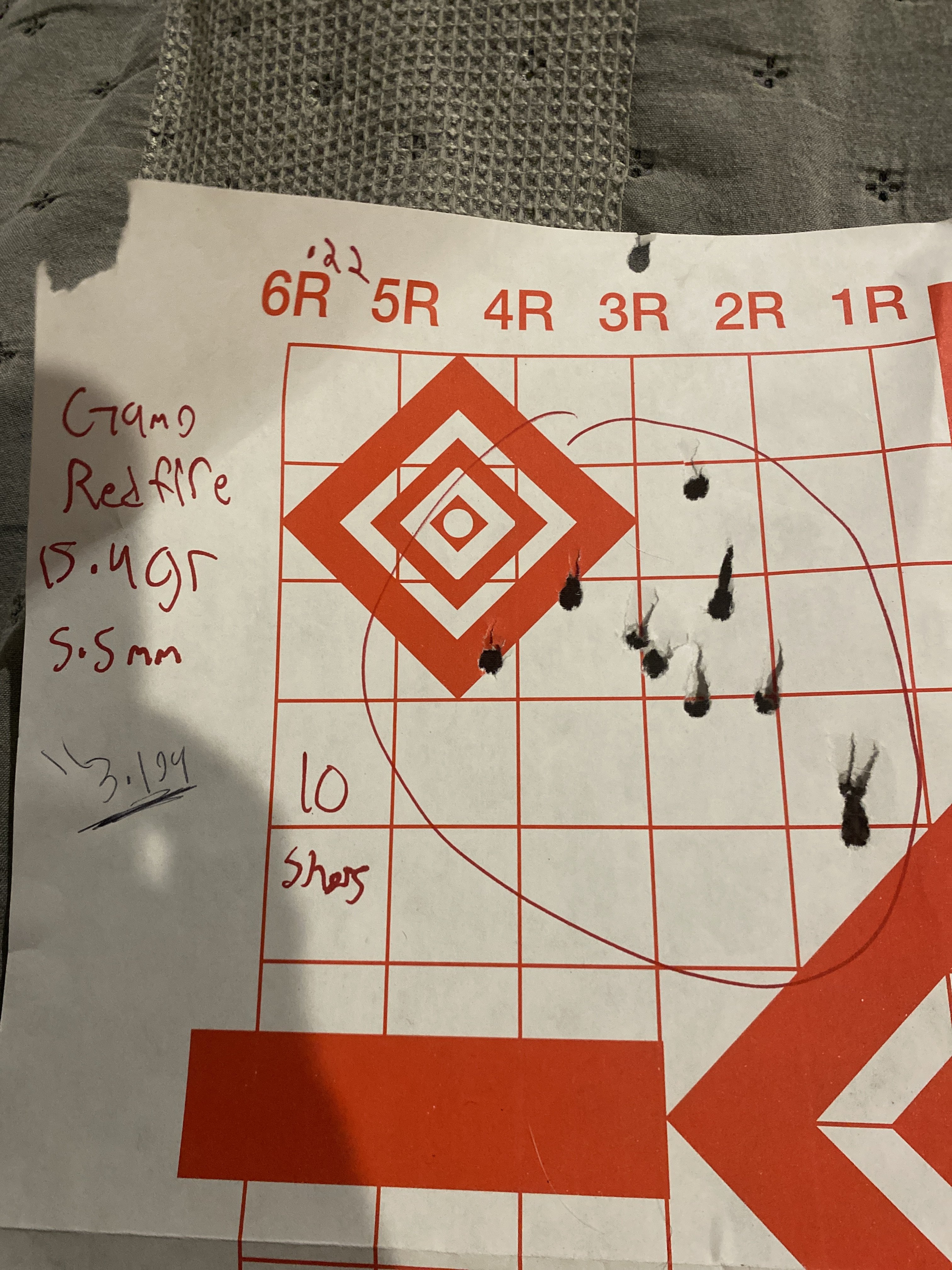

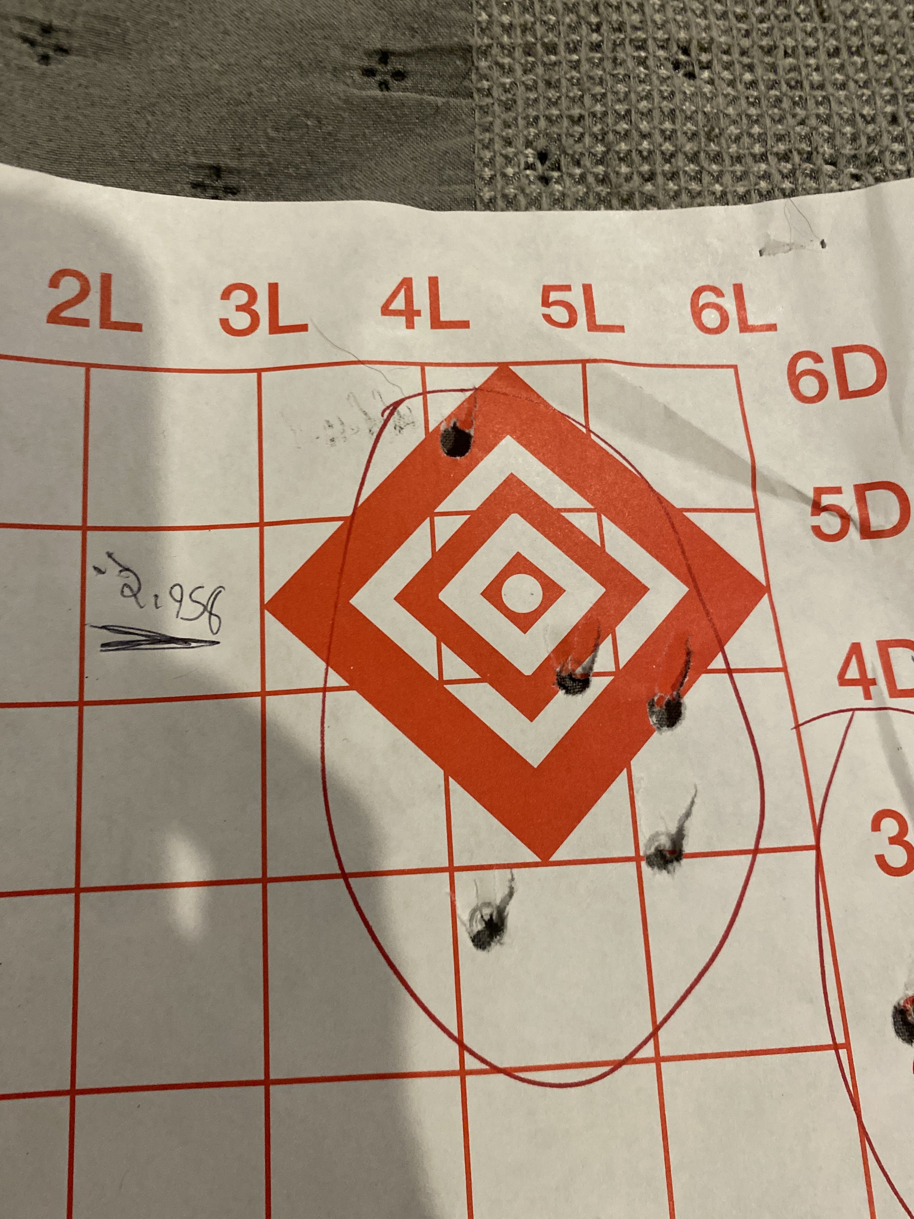

One update Ive had is the accuracy kinda seems all over the place somewhat
Used some gamo red fire with some decent results, And Some crosman hps. Kinda all over the place. What ive noticed is the breech hole is loose depending on the pellet? Maybe larger pellets in terms of size/grain
Always seems like theres a crazy flyer
These are done at about 25 yards on a bag, trying my best at artillery holding. Pretty good moa!
Reactions: beerthief
H&N Field Target Trophy, and JSB exacts. Field Supply often has good deals on the H&N and if you buy over 25 dollars, they ship for free. Buy a couple different head sizes (4.50, 4.51, 4.52 etc) to see what your particular gun groups with best" looking at these groups i would follow the above advise.

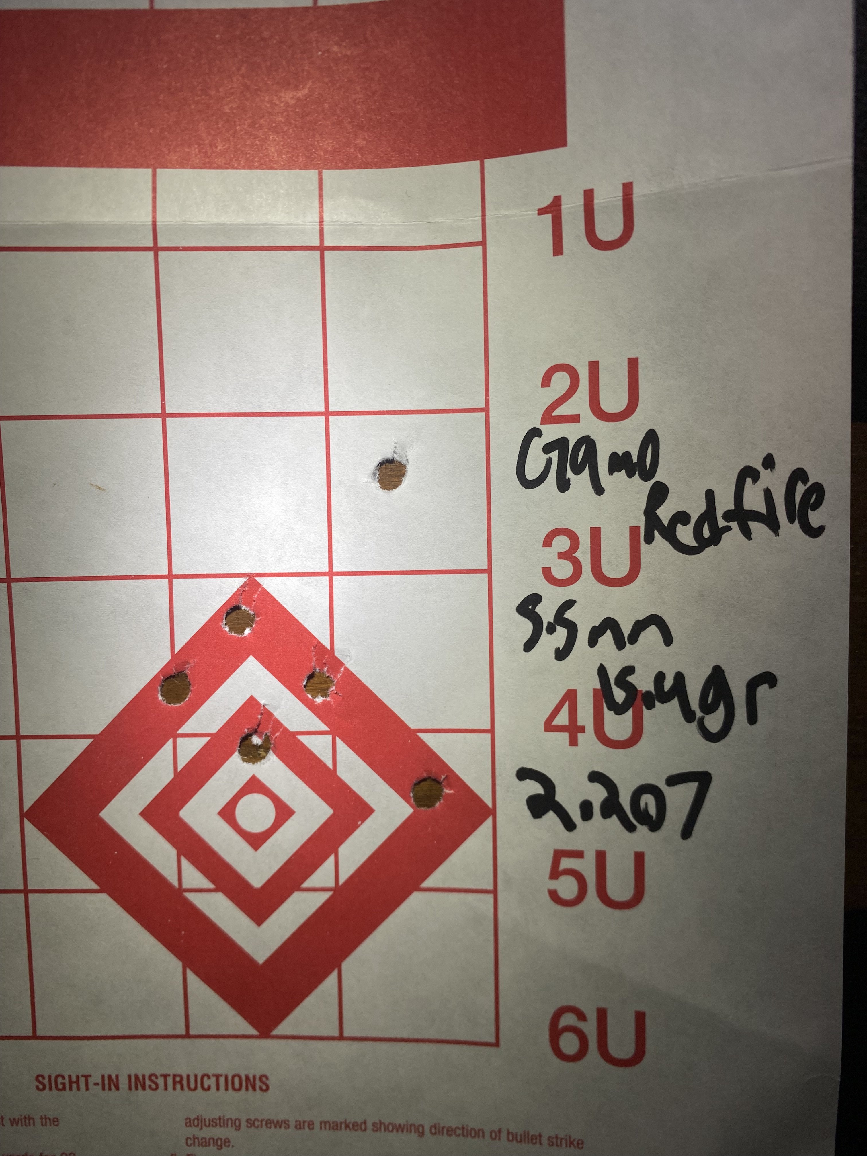

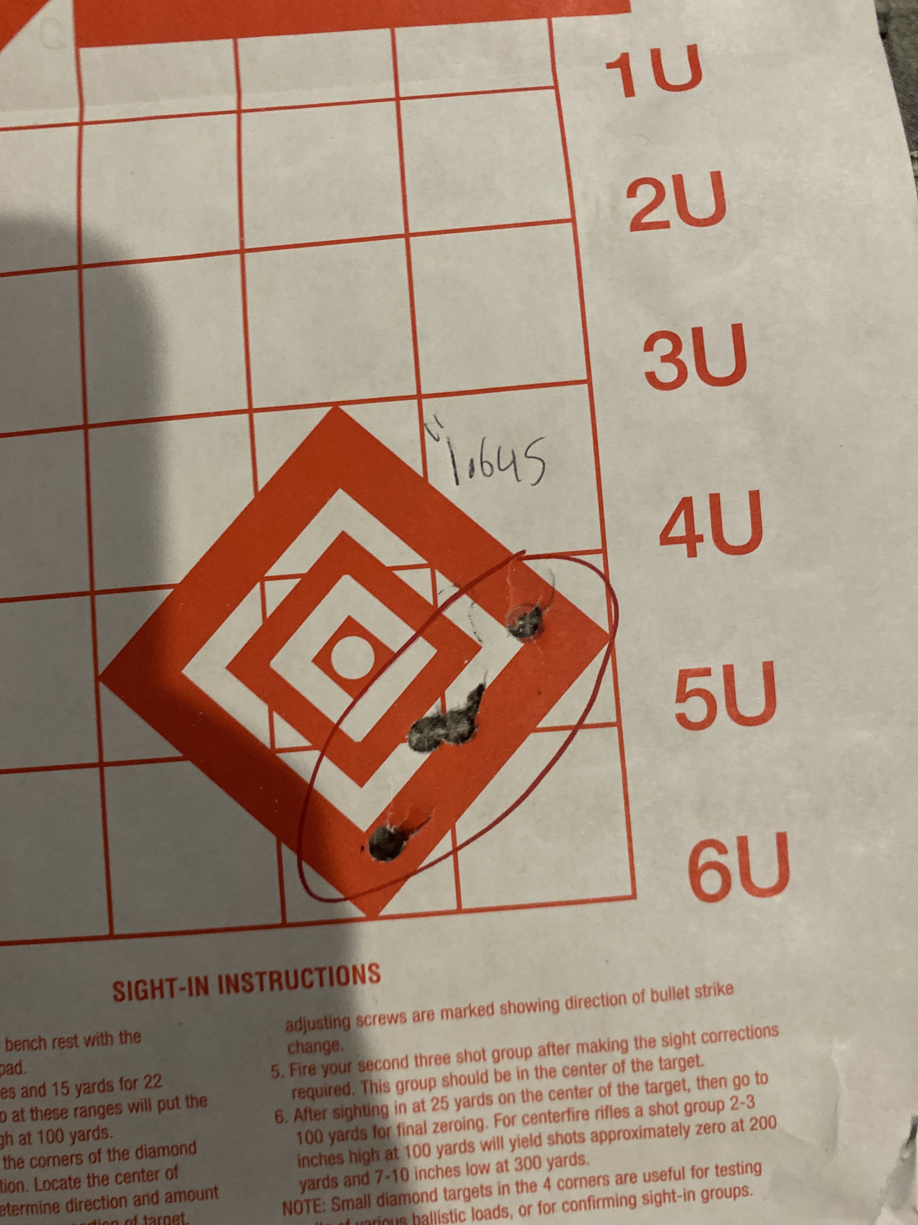

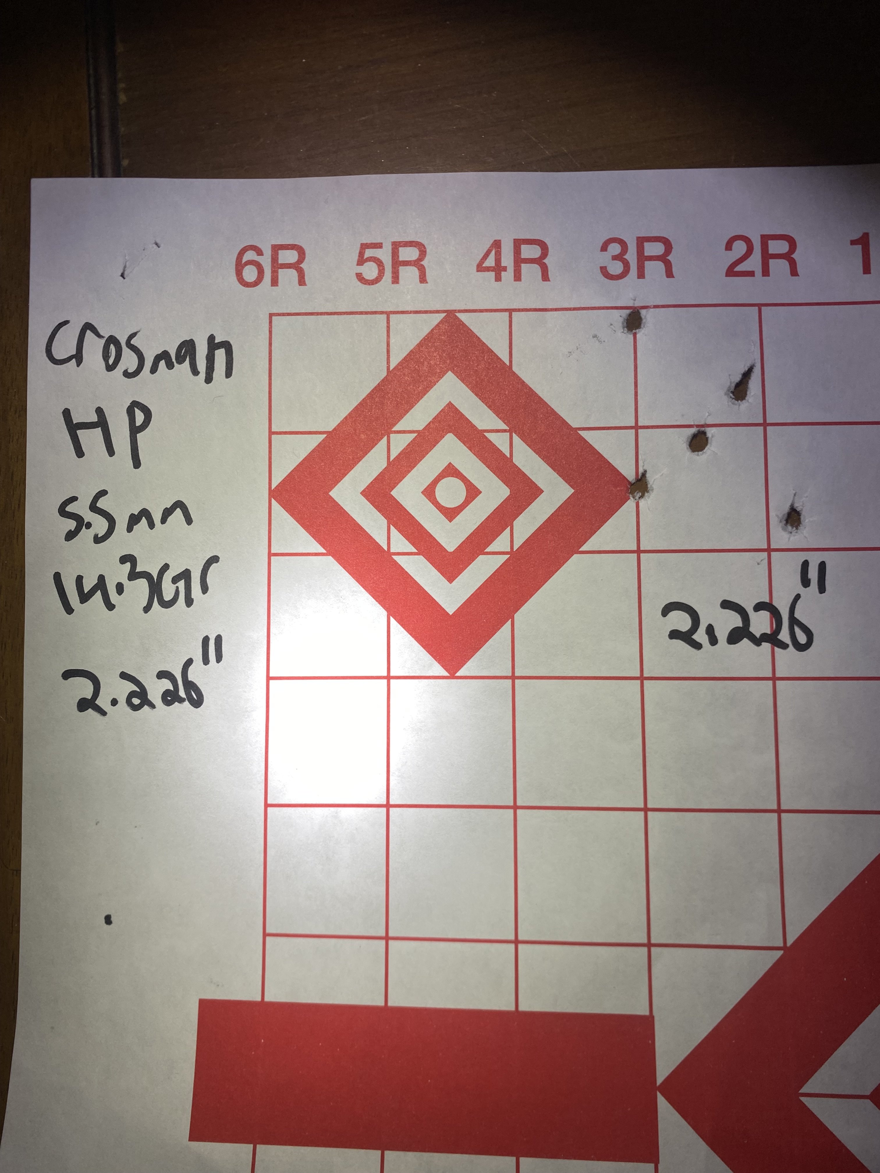

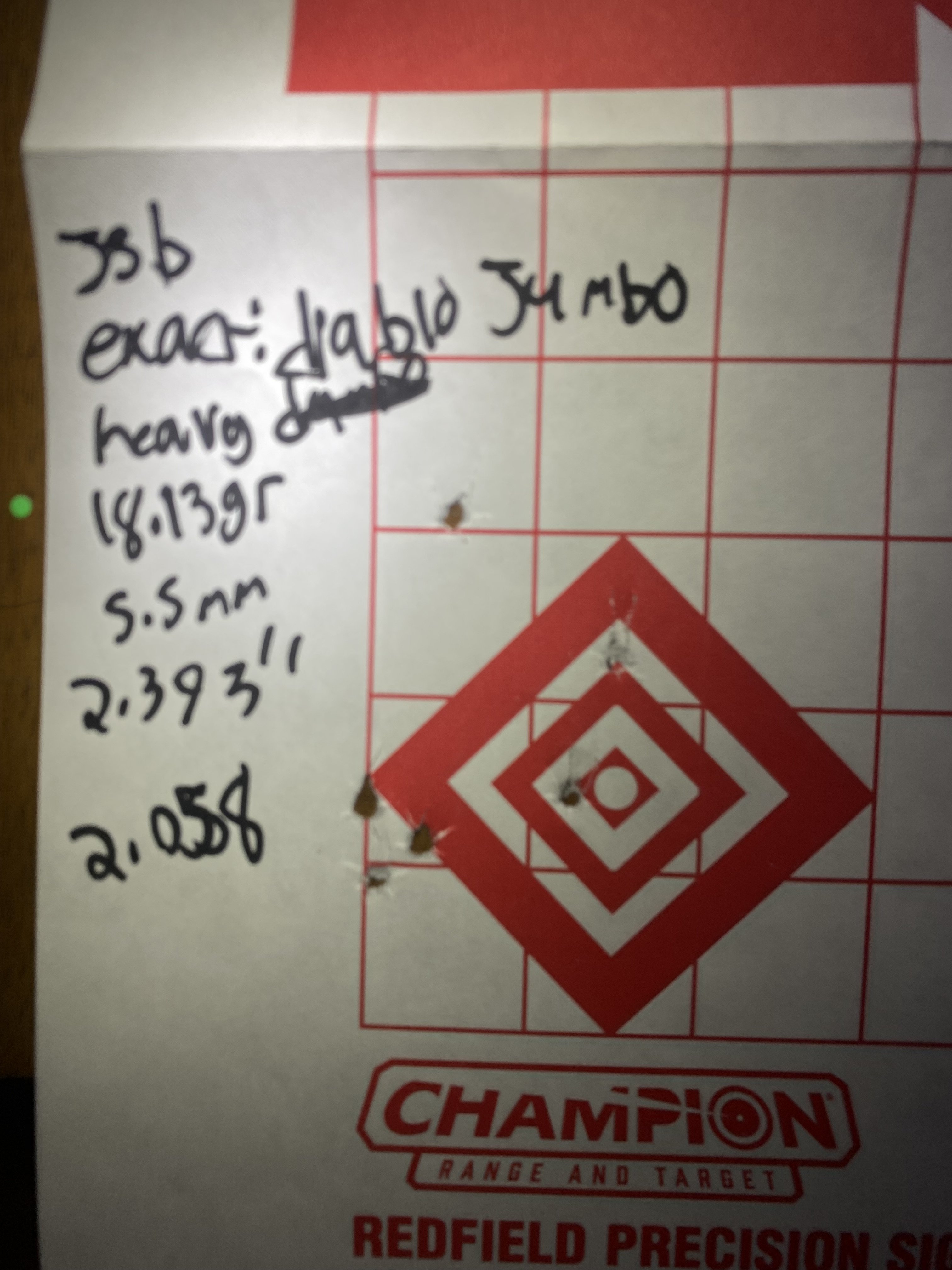

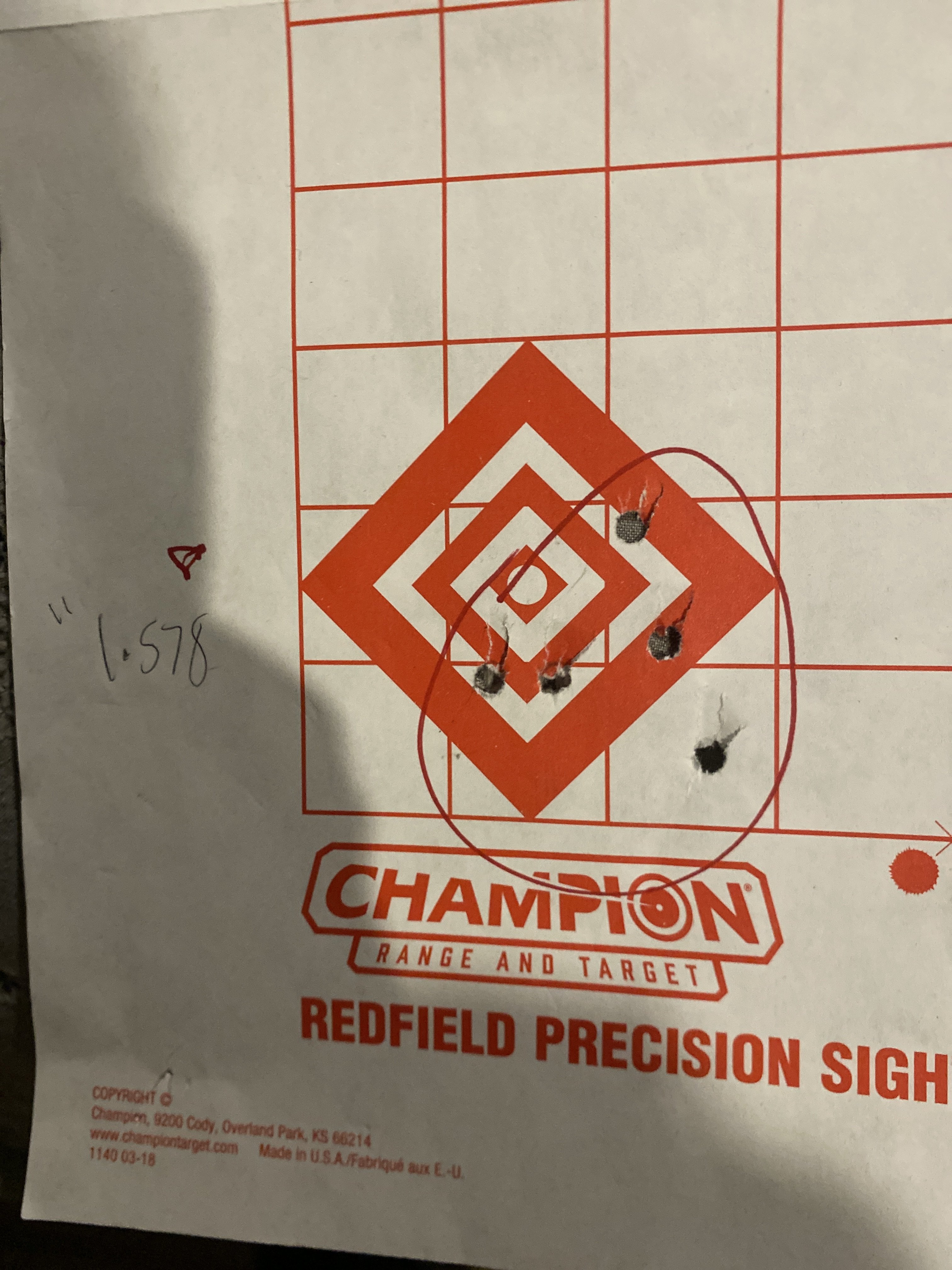

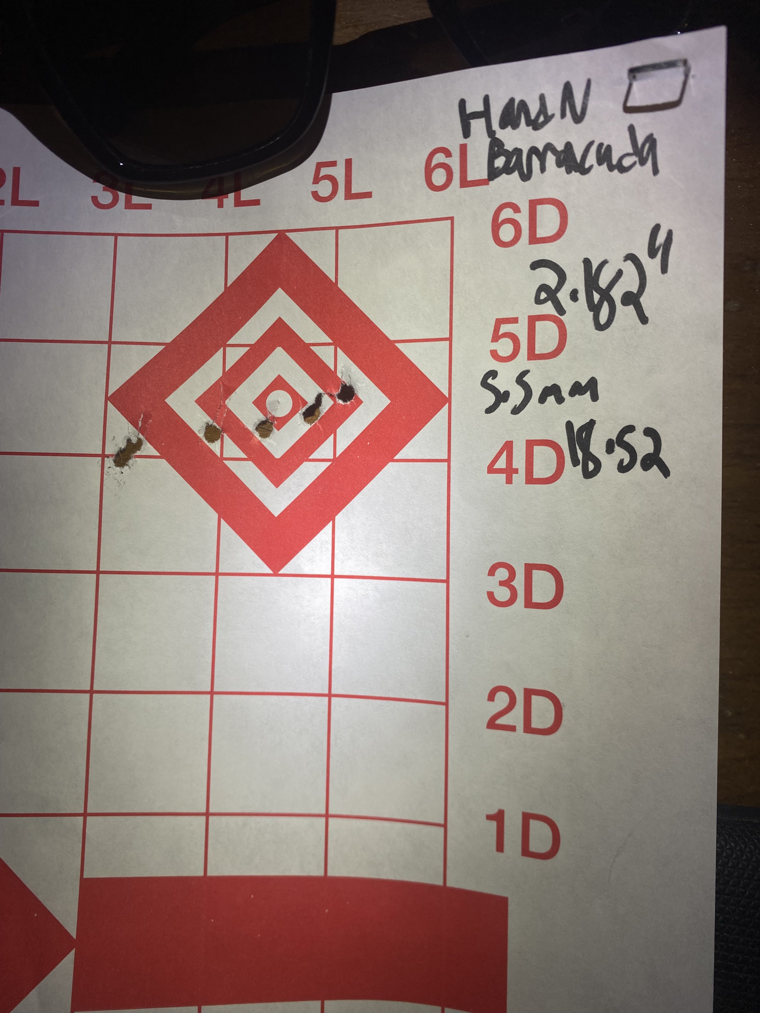

Got some more pellets to experiment with
Crosman Hps: 14.3 gr
H&N Baracuda Extreme: 18.52
Jsb Jumbo Heavy diablo: 18.13
Gamo Redfire: 15.4gr
I shot these on a bag at about 25 yards, adjusting the open sights as best as I can, it seems the rear sight can be moved about but I can’t figure out how without bending/breaking it.
The groupings indeed paint a very different image
Reactions: Hateful McNasty
That should tighten up with time and practice.. if a new gun is just rome was not built in a day .. a hw is a gun you finesse in as you go .. my last r9 was terrible new our of the box .. lol

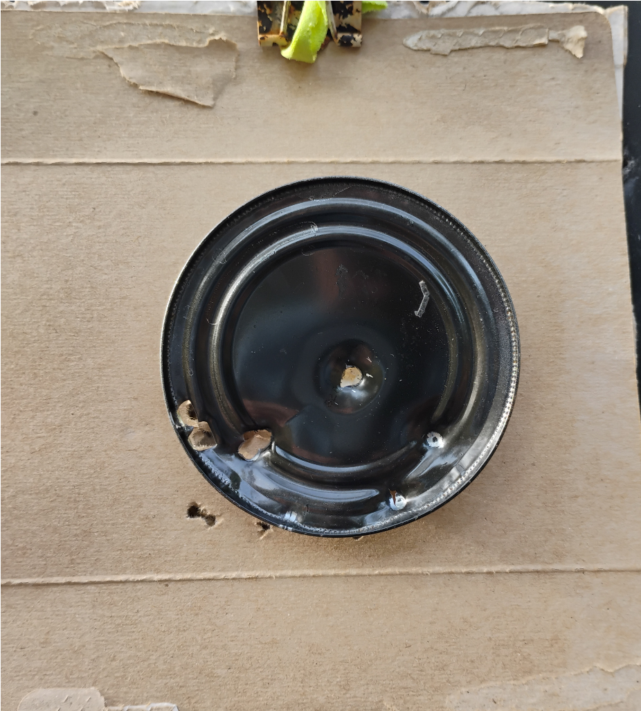

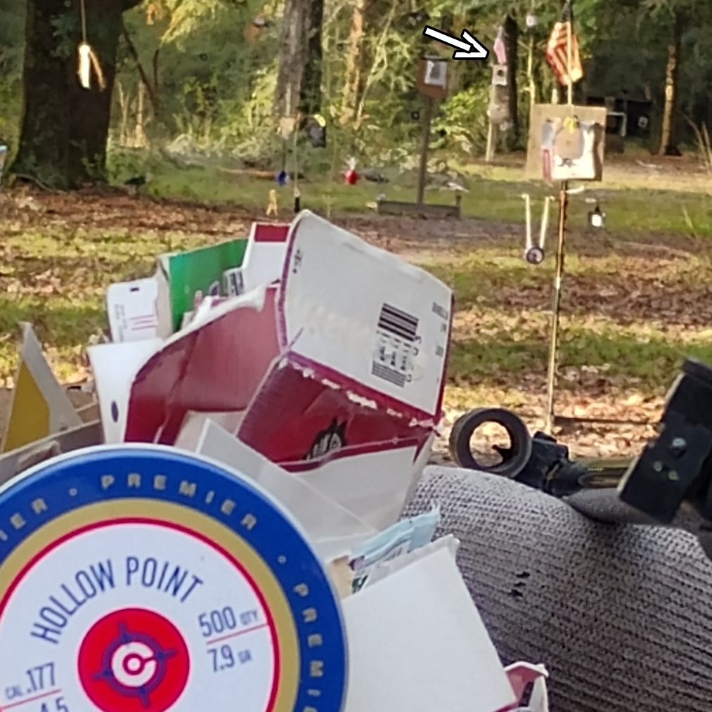

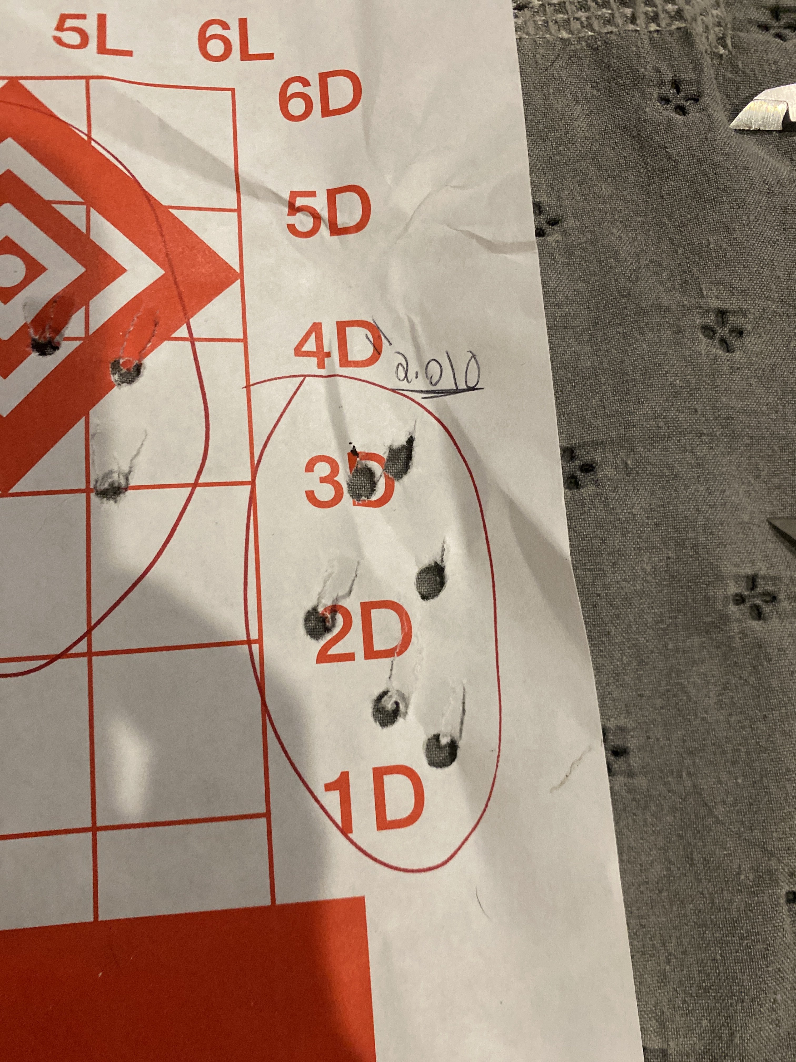

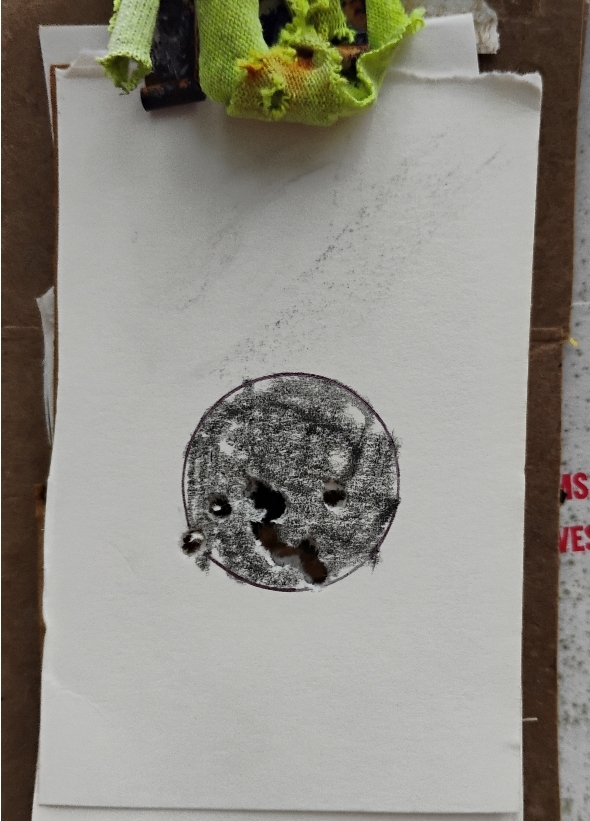

Stopped raining long enough to run out and pop this
10shots , 20y, r9 , irons , cphp.177
I was shooting to 75 yards ( on a nicer day..lol)
First 5
Next 5
Cphp.177

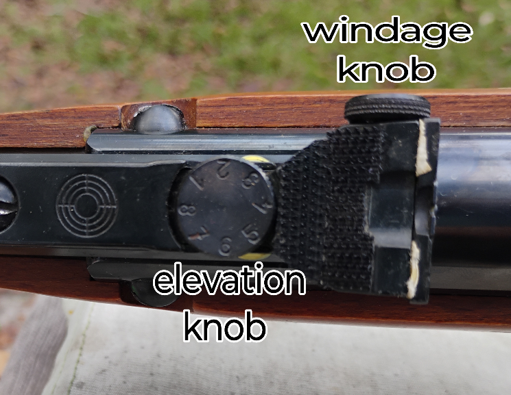

I just not understanding this part
"shot these on a bag at about 25 yards, adjusting the open sights as best as I can, it seems the rear sight can be moved about but I can’t figure out how without bending/breaking it."
You got a knob on top for elevation and on the side for windage . At just 25y you should have way plenty of adjustment up or down ..
Elevation know turs right /clockwise for up. Left / counterclockwise for down.
Windage is clockwise for left counterclockwise for right
That should be in the guns manual in the box
Should not be needing to bend nothing ..
