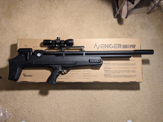

Hello. I've added a new hobby by jumping into the PCP world. I've had a few airguns in the past, but this is the first PCP. I chose the bullpup in .22, and added a DonnyFL FX.

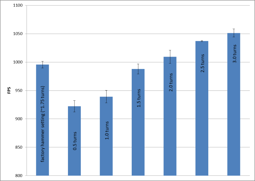

Before messing with the regulator, I wanted to see what I could do with the hammer spring adjustment. Maybe it would be possible to get back the inefficiency by dropping the hammer spring tension (and not releasing more air than is used to accelerate the pellet). Checking what it was set to out of the box, it was ~1.75 turns (from all the way counter-clockwise). Here is what I got (10 shot groups at each setting).
It looks like dropping the hammer tension, isn't gaining me back the wasted air pressure (at least not entirely), since we are dropping in FPS with any adjustment down. Adjusting the FPS downward is good, my guess is that even if I went down to 0.5 turns (920 average FPS). I would still find that the shot string may stay level even after the pressure dropped below the regulator setting (wasting air pressure presumably at higher pressures). Next step - adjusting the regulator!

I decided to try different hammer spring settings at this new regulator pressure, and got the opposite of what I expected (10 shot groups at each HS setting).
This was opposite of what I expected, and I will admit I checked the manual multiple time to make sure I was not getting my hammer adjustment backwards (I wasn't). I stopped for the day and looked at the data a bit. It seems to drift down steadily, with the hammer spring having no effect at all. Here is another view of all the shots.

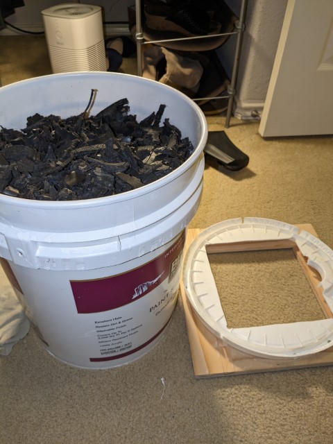

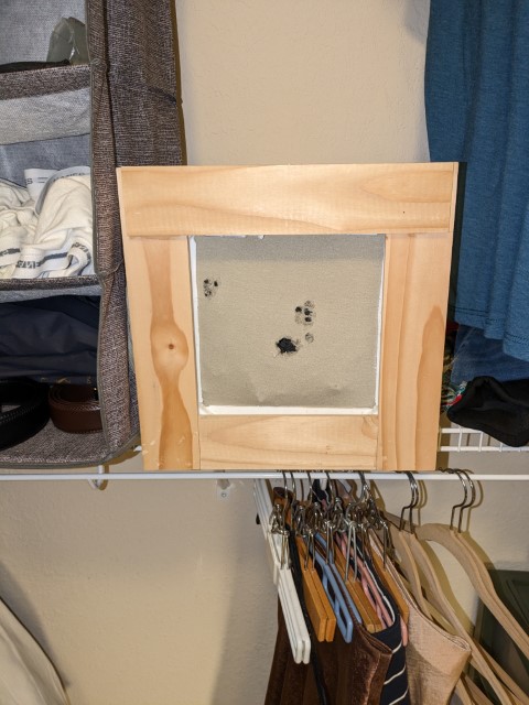

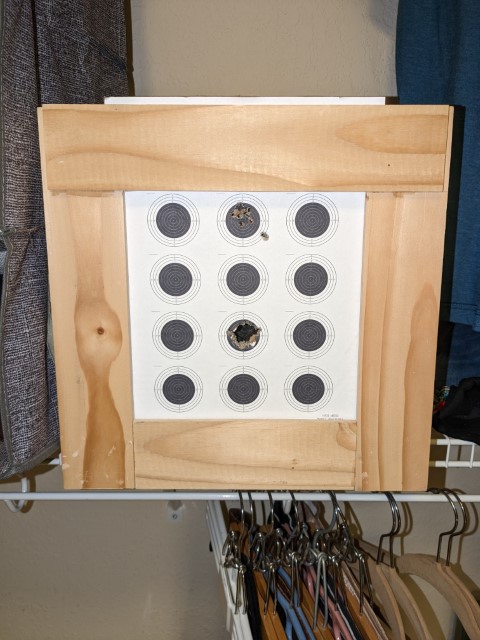

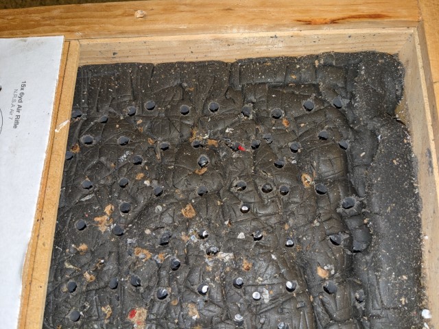

In case anyone is interested in pellet traps, I had to upgrade mine. Previously I was using duct seal in a wooden box with a cut down clipboard to slid in and hold the target. It worked great for my previous airguns (Crosman 1322 and a Daisy 853 Sporter from the Civilian Marksmanship Program), and I had used it for the last 8 years or so without issue. Neither airgun is a powerhouse, but the 853 is more accurate than I am at 10m. :) With these, the pellets barely embedded in the duct seal and were easy to remove when cleaning.
It still worked with the Avenger (out of the box doing ~32 FT-LBS), but only by a hair. The pellets stopped almost through the duct seal I had there. I had to space my shots because I didn't want a follow-up shot to hit the same hole. I could add more duct seal, but it would be a huge pain to clean out the pellets when they bury themselves so deep. I decided to try the rubber mulch style trap. I made mine out of a 5 gallon bucked with a wooden frame added to the top that 8.5x11 printed targets can slip into. Once $6 bag of rubber mulch from Lowes almost perfectly filled the 5 gallon bucket. At first I used an old t-shirt stretched under the lid to hold in the rubber mulch. The t-shirt got ripped up pretty quickly, so I am now trying foam cutouts from anti-fatigue mats from HF. So far it works very well and is holding up nicely to 130 shot strings all hitting the same place.

And yes, that target is setup in my closet. It's 10 yards exactly through the master bedroom and bathroom and into the closet. My wife is understanding of my silliness (I got lucky in marriage).

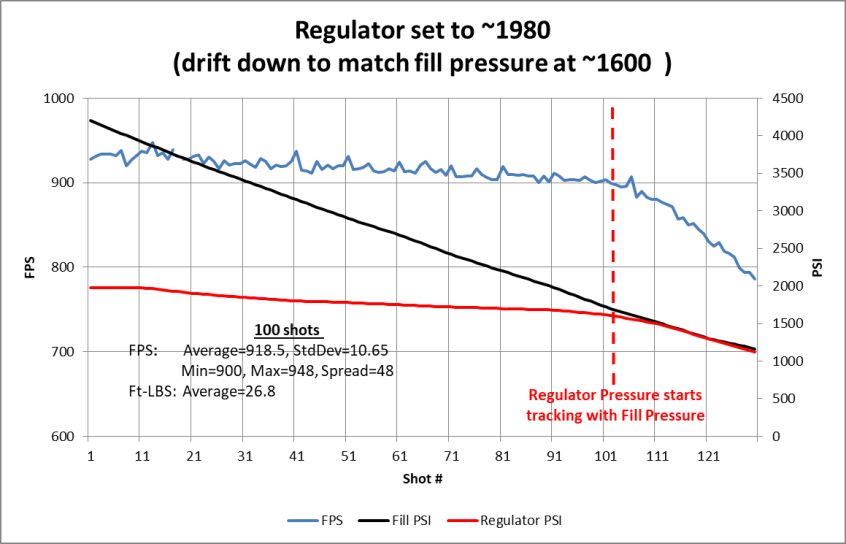

All that being said, I did do some more work and was much happier with the results. I figured that my Avenger may not be happy at the very bottom of its regulator, so I moved it up to 2000 PSI (as close as I could get). I let it sit overnight, and still saw some creep, but not as bad. After dry firing to get back to the setpoint (actually looked a little under 2000 PSI at this point), I put the hammer at the lowest setting (0 turns). I tested some and then refilled and ran a full string. This was done just like the last, 10 shot groups with a 2 minute pause between, recording both fill pressure and regulator pressure.
The regulator does seem much happier. The first shot jump (after a 2 min pause) is completely gone, and the FPS are are more consistent (well under half the StdDev and spread I saw over the string when the regulator was at ~1700). The FPS are a little higher than I was hoping to try for (918 FPS average over 100 shots). I still do see some pressure related creep in the regulator pressure (not sure if this is normal or not - this is my first PCP). I do know that I would probably not notice an issue if I was not collecting all the data. It not quite as low a spread as AEAC's eco tune, but not bad, and still getting 100 shots even though the regulator pressure is 2000 PSI instead of 1400 PSI. If I didn't look at the regulator pressure dial, I would have assumed that I went off the regulator at 90 shots (fill pressure hit 2000 PSI). By that point in reality, the regulator pressure was below 2000 PSI due to the creep. I think that if I can somehow clean up a bit of the pressure creep (maybe clean up the delrin seal in the regulator), I might attenuate some of the downward drift in the shot string. I'm not going to mess with that yet however as to me at least this shot string seems reasonable. Not sure if I have settled on a new gun yet, but I think I have ~700 pellets through the gun so far (not bad for the first 10-15 days considering I am currently using a hand pump).

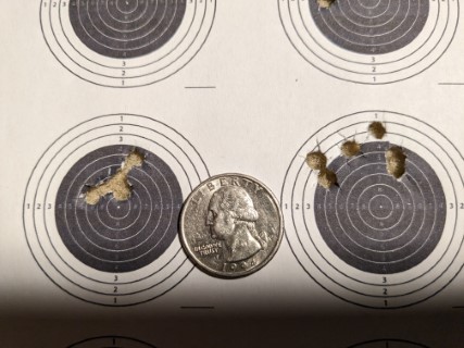

So, it got warm enough to shoot outside today. I shot at 25 yards with a Leapers BugBuster 3-9X (its what I had, but I am planning on getting a budget FFP scope at some point). At 9X, I have a very strong suspicion that much of the spread can be blamed on me. I can see plenty of drift in my aim (from bench rest, but no sled or good bags). I'll have to get more stable setup to see if I can improve and go out further (didn't try past 25 yards today). All are 5 shot groups.
For Crosman HPs those groups look pretty good to me. You might want to consider a bipod. They come at a wide range of prices. UTG makes a very inexpensive one (like $20) that doesn't have much adjustment but is pretty solid. I used it for awhile but ended up upgrading to about a $75 Amazon bipod. I also use a rear bag that I adjust for elevation with an air shim meant to be used hanging doors. My rear bag is in a home made open box with the shim under the bag.
