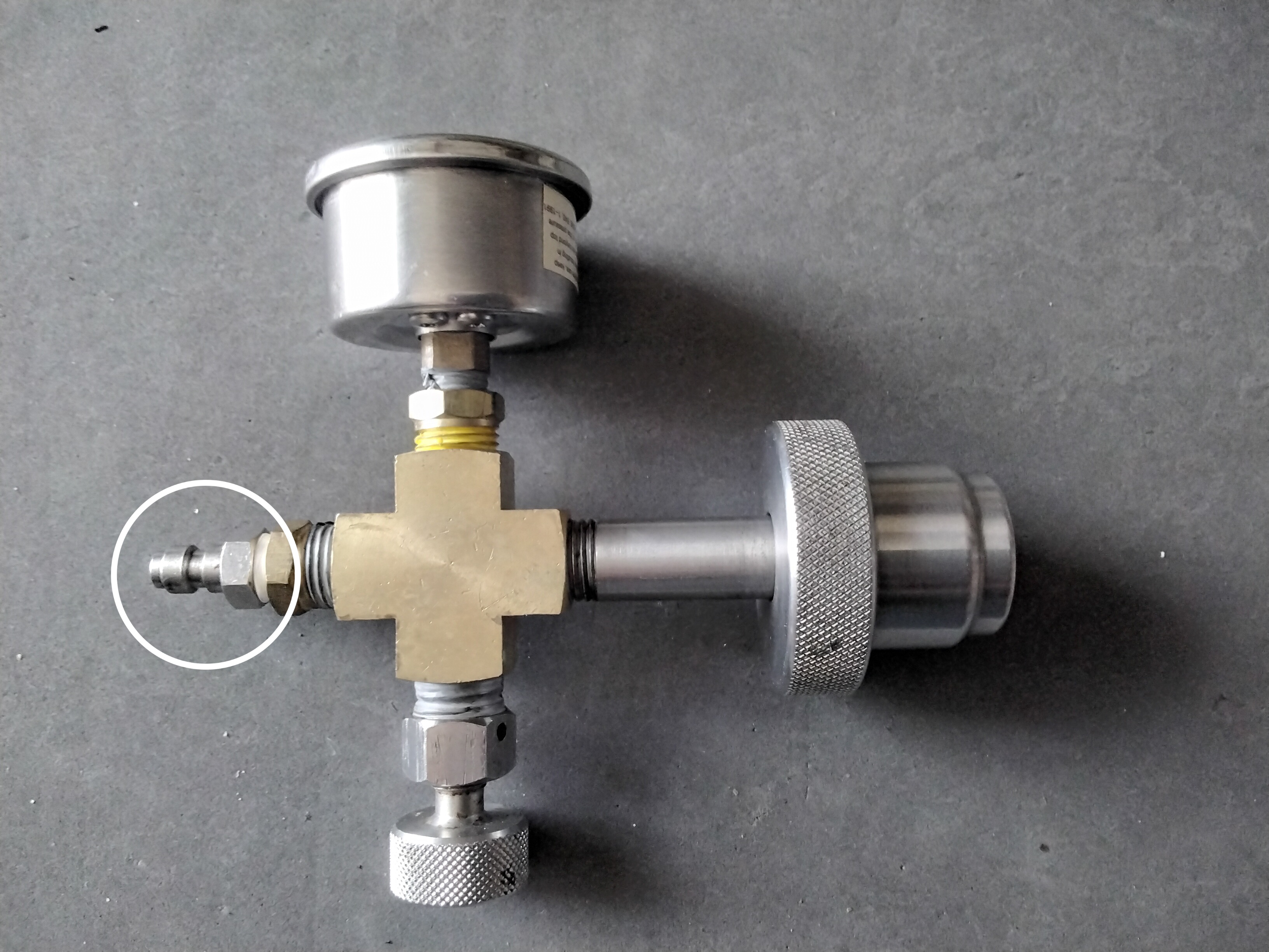

A one way check valve on the tank fill adapter removes the need for closing the tank valve while purging. You won't lose any air already in tank. 20250421_115443.jpg
