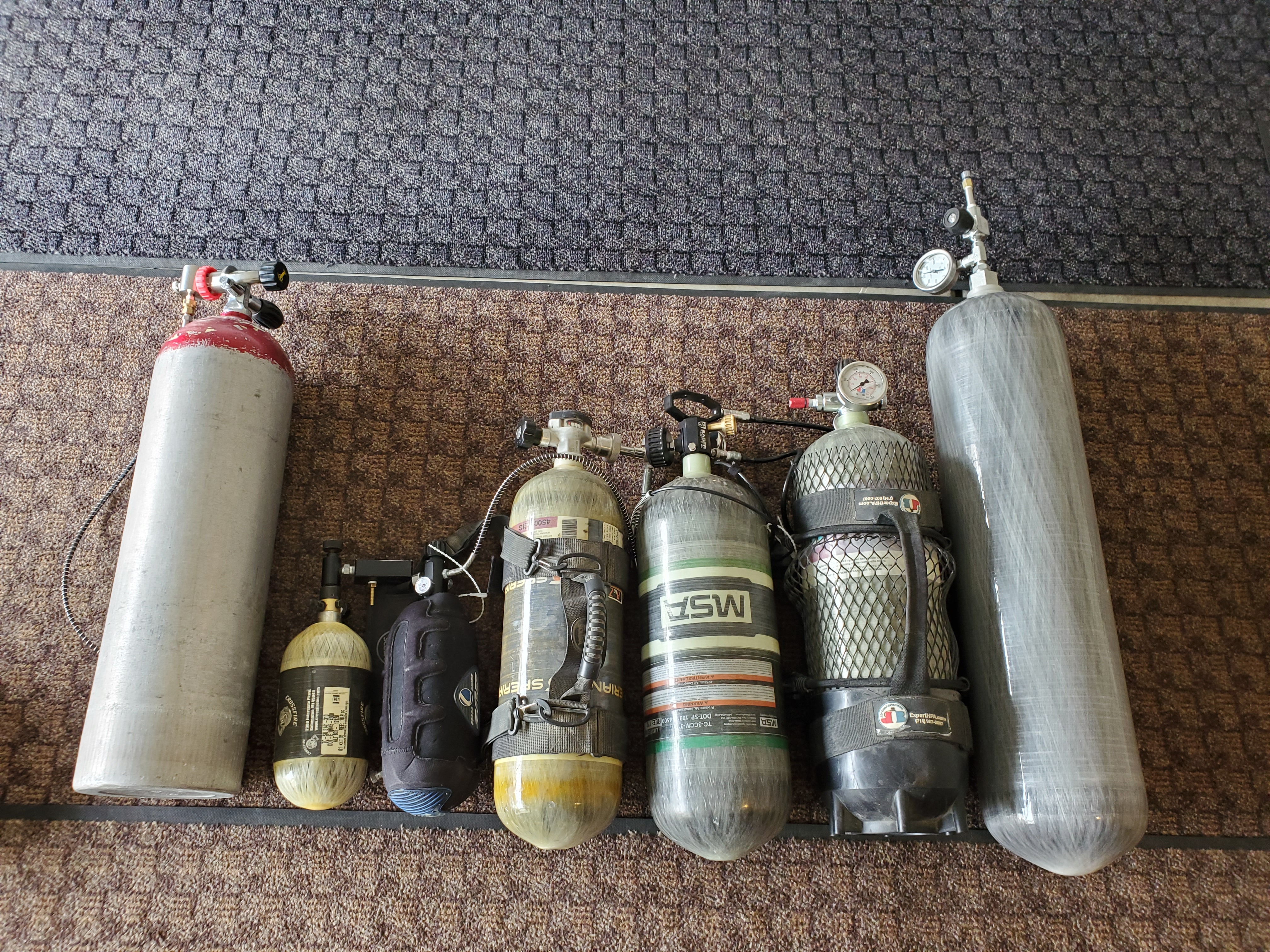

Everything to the right of the buddy bottles got a little up-shine. The small scott scba next to the buddy bottles was retired fire gear and it was HAMMERED so I had to Dr it up to not look like garbage.

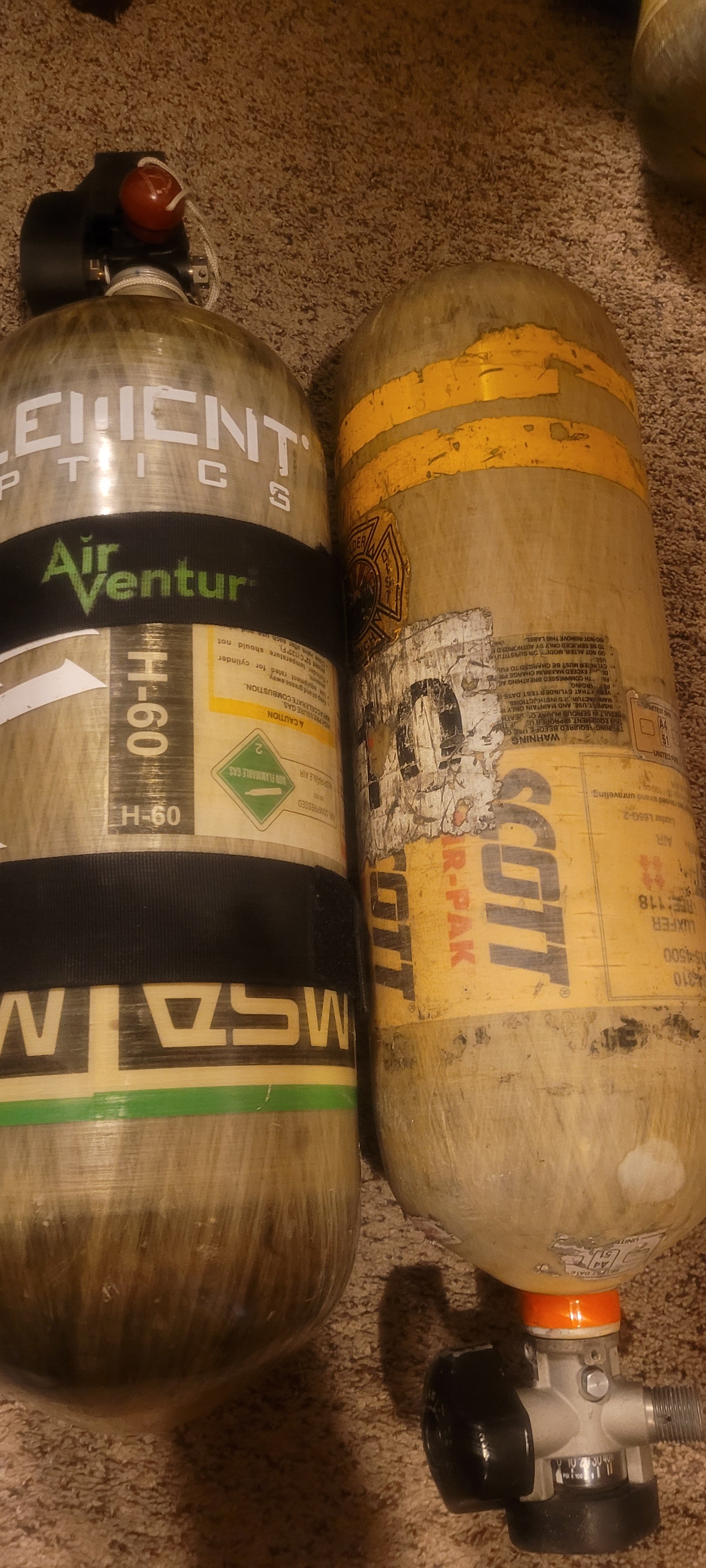

My tanks are not damaged, just the outside is a mate finish and I would like to clean them up to be glossy.
The left tank is my MSA and it looks great, the right tank is my newest purchase. The tank is fine and the seller made no attempt to hide how they looked! I knew they would be like this when I bought them and have no issue with them, would like to clean them up if possible. If not then no worries as they will be in my truck when I go hunting.
A little heat to loosen the glue from the stickers , then some goo- gone for the residue . The coatings on these tanks is like the gel coat on a fiberglass boat .
It is a protective layer , not a structural component. You can clean them , buff them , and I guess you could wax them. Get the stickers off , and clean things up........no harm done , The outer gel coat is to protect the carbon fiber wrap.........that is the important part . If it is intact , you are good to go .
The typical construction today is the aluminum liner, the structural carbon and it's resin, a protective layer of glass and it's resin, a waist wrap and the a final protective outer coating of resin that can get chipped etc if memory serves. If no strands of any type are compromised there are no worries. I've back filled chips with 5 minute hardware store resin and buffed it out.
