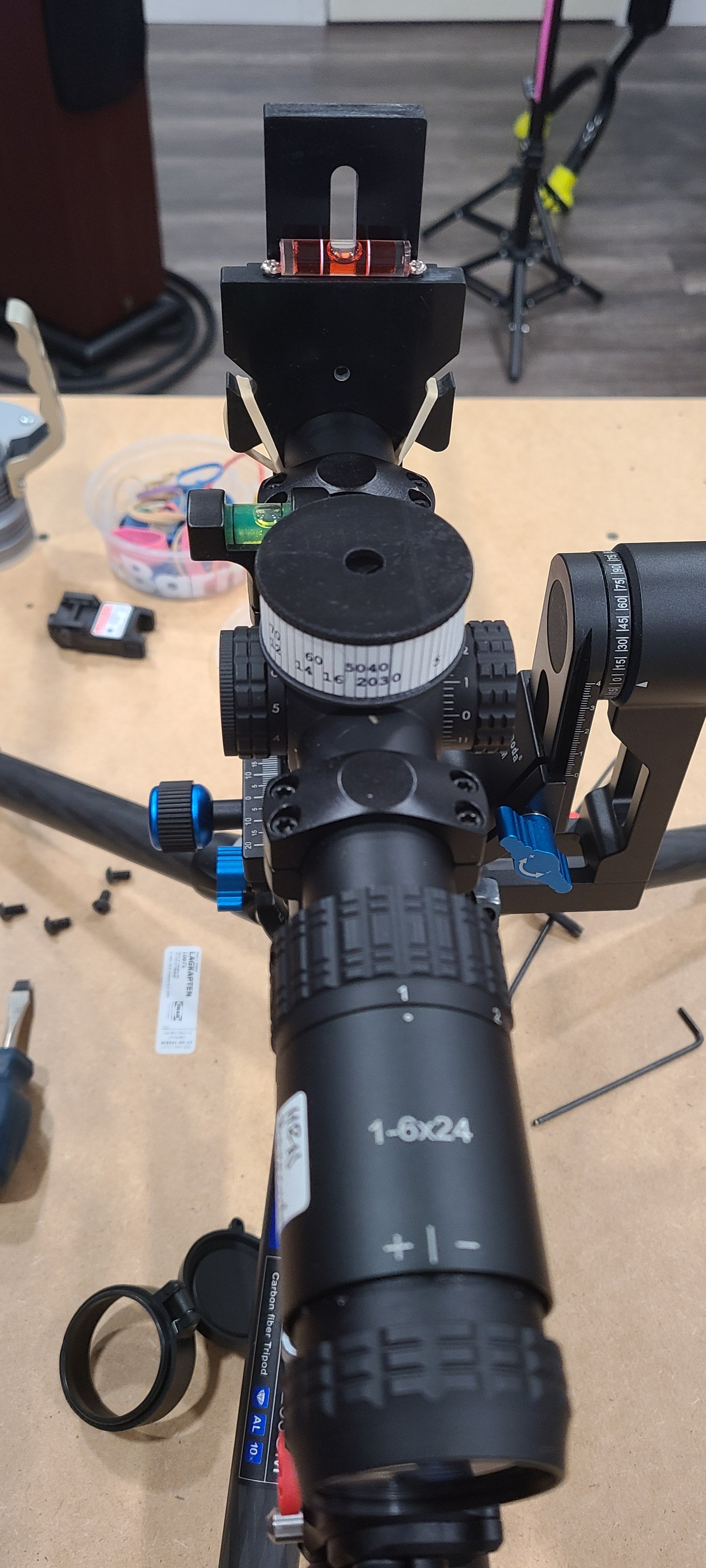

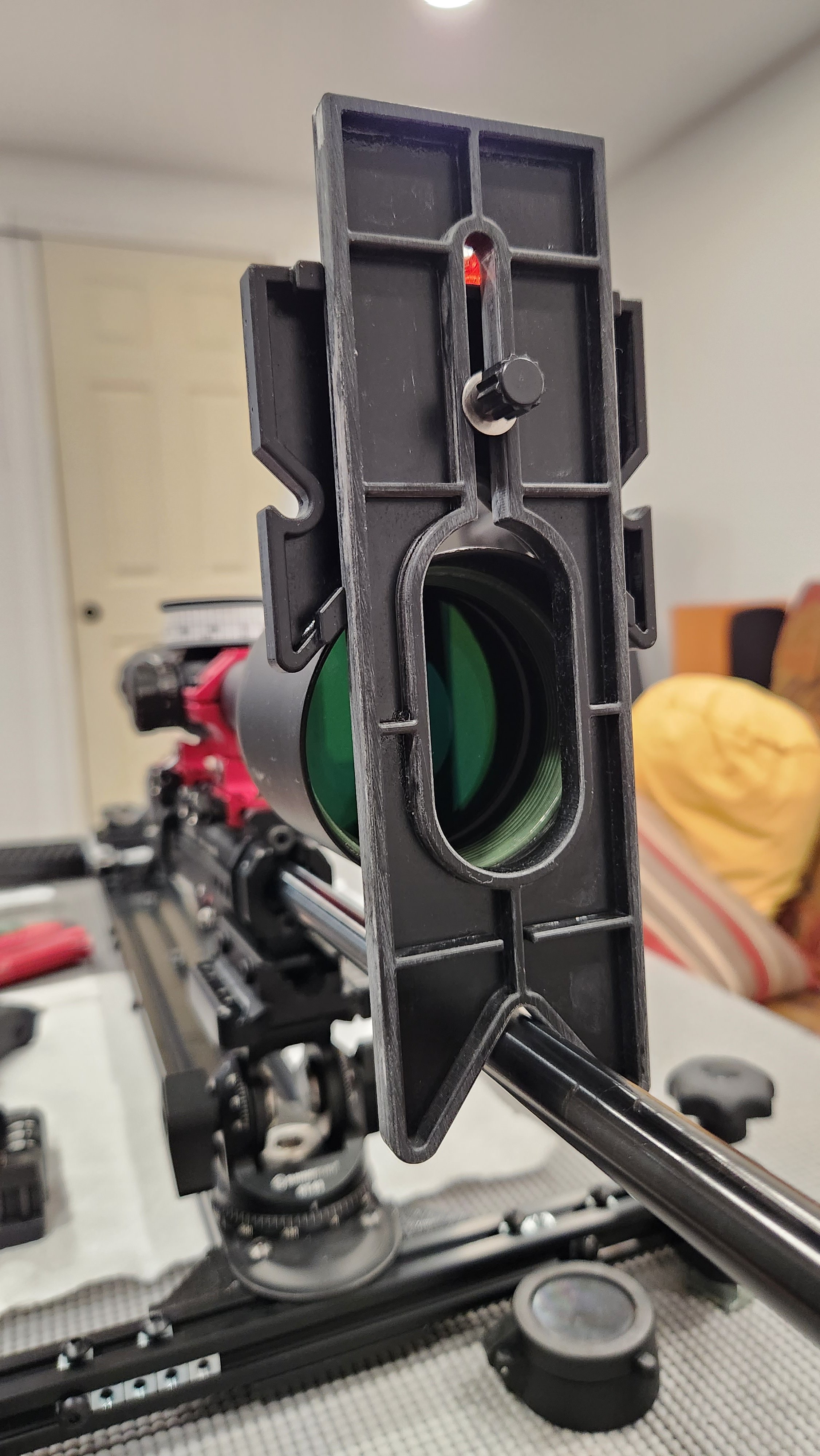

I have been using this gizmo for a few years and it seems to work very well. I’m not a competitive shooter, outside of biathlon, but my Pantheras hold up at 100+
I somehow understand how this alignment tool(s) works....😂....will probably pick one up! Works like a plumb bob and lets one know if the barrel is aligned with reticle.

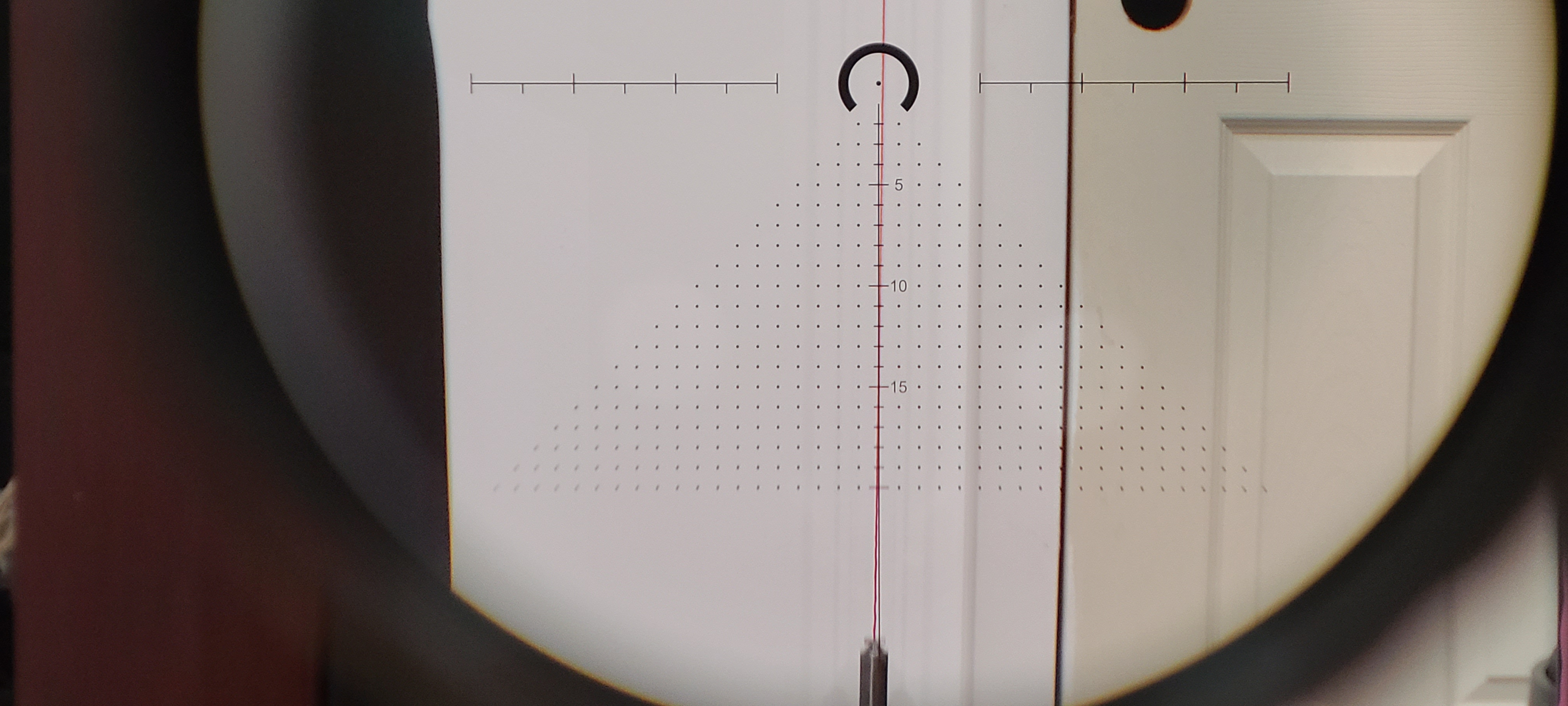

Use either scope leveling tool and it may or may not work. It takes some things for granted. After being burned by the wheeler long ago ...I switched to the zero and near distance method I already described. It never fails because you are actually using poi results to align your reticle. The mirror method has failed me as well.

I am using that my diy 3d printed tool to set the bubble only.... and btw me shooting of the bench only so with consistency I am on safe side.

This is after the mirror trick, and the shooting close trick, and the plumb bomb trick, and the etc etc etc trick. Readjusted the bubble level on the gun so that I know when the bubble level is good, my vertical crosshair is truly vertical.

If you rotated your scope significantly as you implied....it's not possible that you can obtain the same results unless something else has changed.
Which way did your scope end up turned compared to your original setting?
Mike
Hard to say with absolute certainty b/c I messed with the scopes orientation in four different sessions, spread over the last 10ish days.
First big adjustment was scope going counterclockwise, from shooter position. That was an overadjustment so in the second futzing I went back clockwise maybe 1/2? of the first first rotation. Third and fourth adjustments werent as big of rotational jumps.
The "best" combination of mirror test, close and far impact points, and the plumb bomb puts the rifle canted quite a bit more than it was before all of this craziness. It seems the rifle MUST be canted to get the scope at true vertical while also keeping impact points intersecting s vertical line at near and far (55yards) distances.

Actually, you could just check how well the scope zero traces a plumb bob line from 0 to 100 clicks down (with a clamped down rifle or just the scope).
