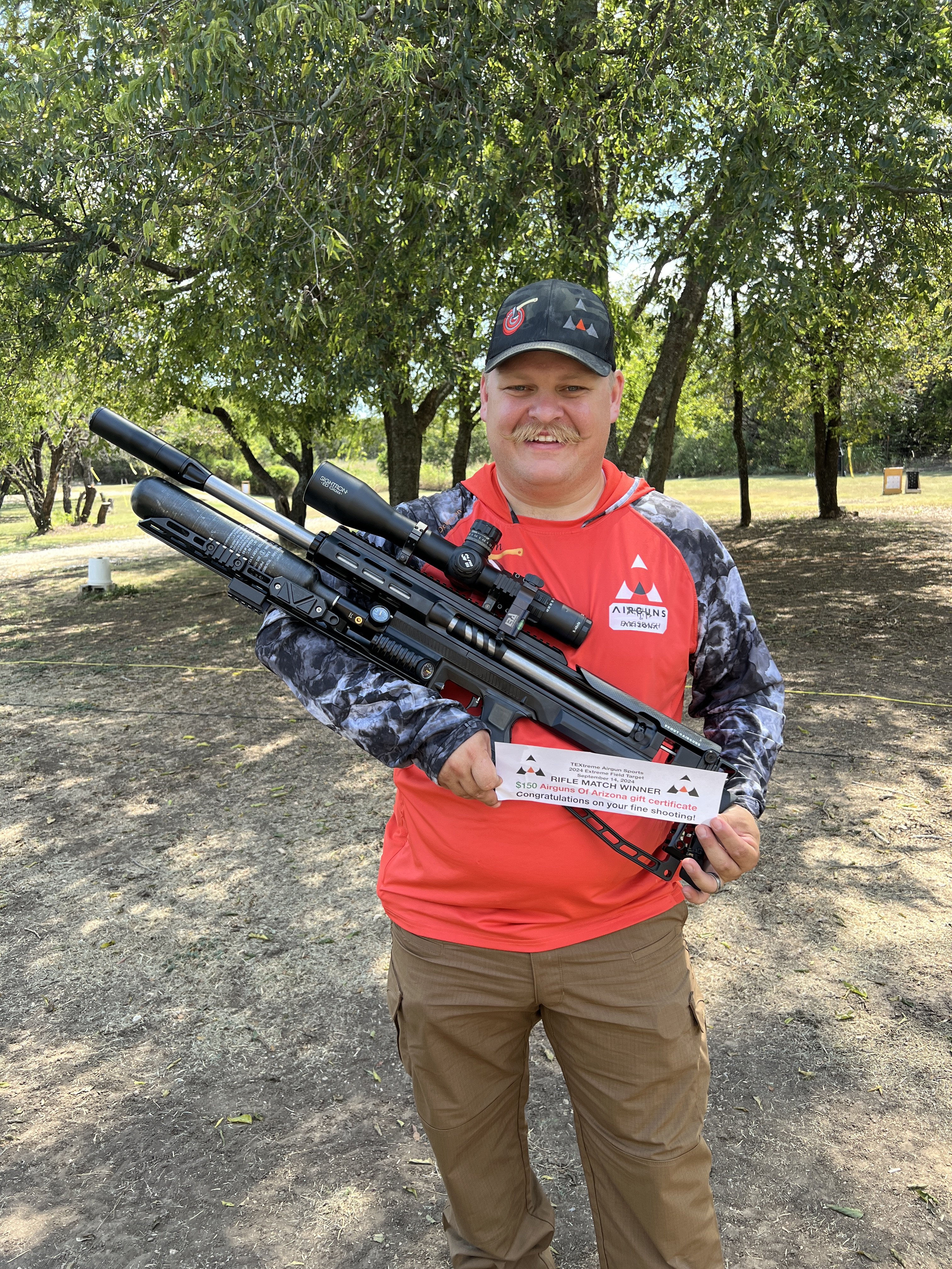

This weekend I shot my Skout Evo .25 with a Submoa barrel in it. I took first with a 58/60. I been shooting EFT for a good while now and it seams that .22 is getting less and less. At our matches in OKC and TX the .25 and .30 number of shooters far out weigh the number of .22 shooters. I only shot a couple matches with my .22 RedWolf and quickly decided I needed to make a change and so I did. I went with .25 for a number of reasons but a big one was price per tin and how many pellets you get for that price over the .30. .30 is great and I know a lot of people that shoot it but I prefer the .25 at the moment. If you’re looking for options and recommendations I could not recommend .25 more. Like Franklink said it can be a lot to get into in depth.

Congrats Caleb, GREAT shooting!

Great shooting Caleb....! Damn, that scope is HUGE! And my, what a fat barrel you have... ;)
See that sweat pouring off Champ's face🥵? That's not from just finishing a sixty shot match in 100 degree PLUS heat indexes.
It's from holding his rig long enough to pose for that photo.:unsure:
If you think the EFT setup is heavy, how about when he sets up the same gun for Benchrest?
I think it does come with its own forklift however,…. 😂
