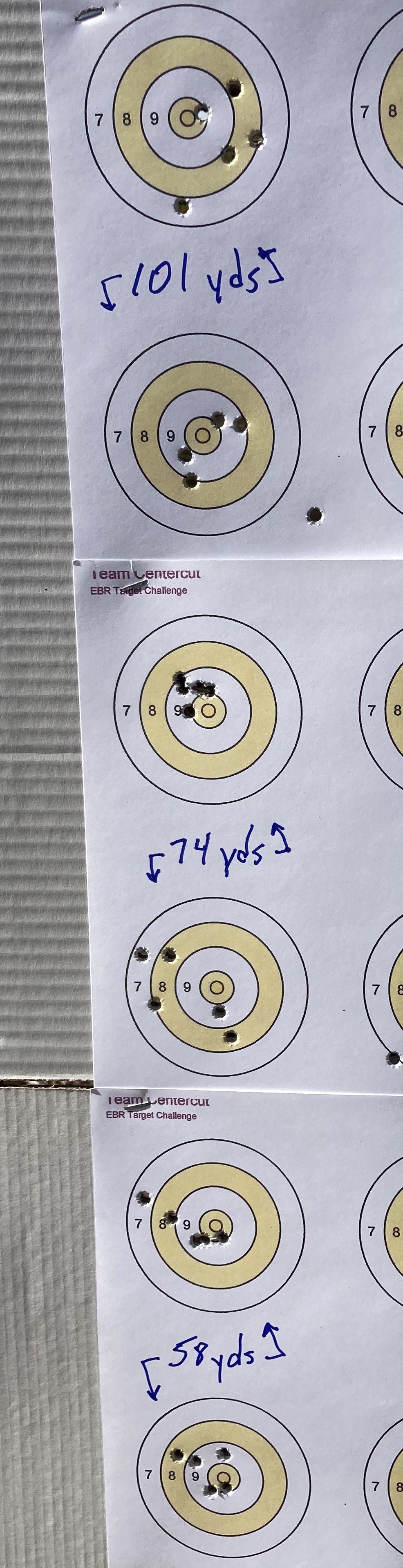

Ive been practicing shooting longer ranges bucket and sticks whenever I go shooting. Today I shot six EBR targets 5 shots each from 58, 74, and 101 yards. .25 Impact with NSA slugs. Funny that my best target was at 74 yards. Still lots of room for improvement.
