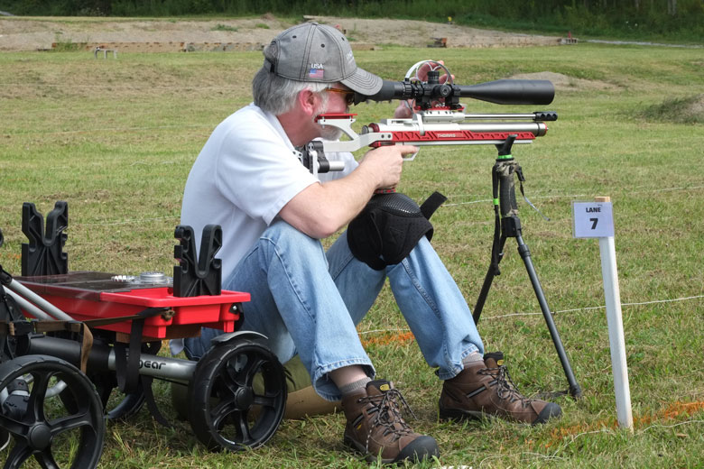

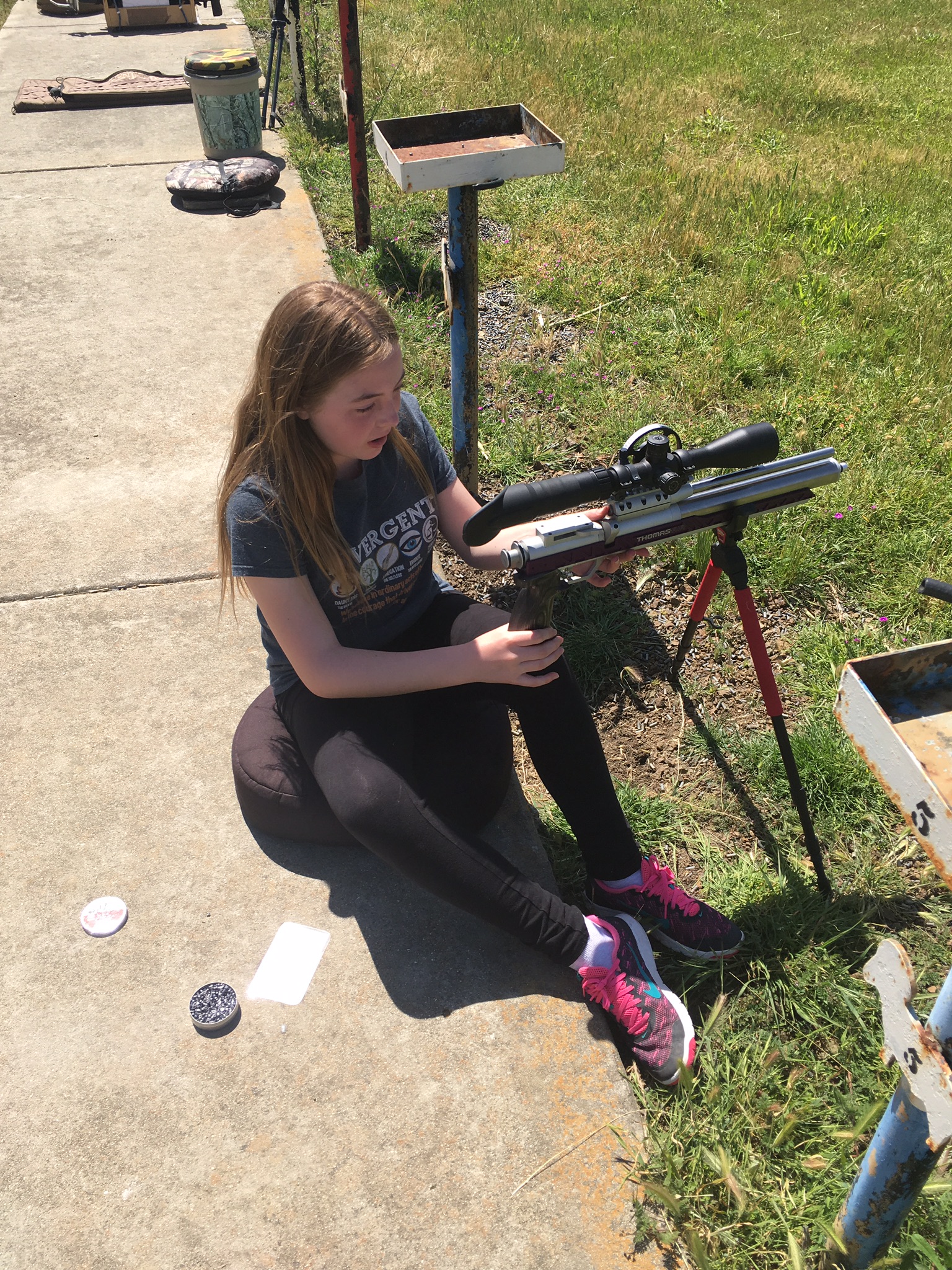

Sandy...try this one out from your bag. My 11 year old daughter learned this position with sticks in less than an hour and knocked down a 3/8 kz at 30y with a pistol 11 times in a row. She also had streaks of 9-10 a couple times as well in the same shooting session. Stability was not a problem for her at all. Mike Schultz is the other pic. He was a brand new FT shooter and won the PA cup in Hunter on his second match. For those that don’t attend the PA cup...it’s usually a 100 plus shooter event with the best the eastern half of the country in attendance. He also won the pistol class at Nationals and that was his 3rd match. He’s a very talented 25m BR shooter (multi national champ) and he knew the wind...so simply finding a position he could be steady with immediately put him at at the top. This same position can be adopted from a taller seat as well...but you are going to have to lean over more. That can cause difficulty in finding targets until you get used to it.
I’ve said this before, and it’s apparently irritating to some....but getting rock steady with sticks does not require a lot of practice....but it may require a lot of initial experimentation to find what will work for the individual. My advice is to not settle for a shaky position and hope to fix it with practice. Take the time up front and just try everything.
Mike
Btw...Mike is not shouldering the gun. The grip is resting on his knee. Clearly Olivia is also not shouldering because there is no buttstock on her pistol. There is a million variations on this position. Some will find that placing the butt of the gun on the rear knee or in the crook of their right arm that is resting on the knee will be more comfortable.

Mike, who said bum bags weren’t allowed in EFT? It had been discussed when we were all formulating the rules for this relatively new sport. The photos above posted by @thomasair are totally legal in EFT. The only rule that I know is you can sit however you want as long as the soles of both feet are in contact with the ground. High seat, low seat, bum bag seat, doesn’t matter.
It does take a while to find what works best for you, and then more time getting used to holding steady in your chosen position, but they all can be used. You don’t even have to use sticks if you don’t feel it assists you. Sit down on any seat (no back rest) at any height, both feet on the ground and you’re good to go.
