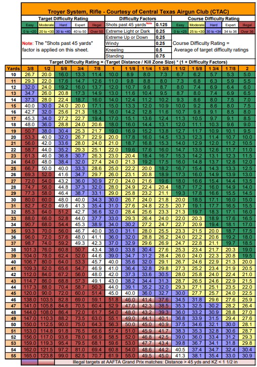

(Full credit goes to Brad Troyer on all of this. And thanks to CTAC for this particular image)
I really enjoy analyzing the numbers for sub 20fpe field target matches, and that typically entails using Brad's chart.
A few days ago I realized how cool it would be to extend this out, in both kill zone sizes and distances, for the Extreme Field Target monthly matches we're having here in AZ. I tinkered with it off and on for a few hours during work today and got sucked in enough that I had to stay up late to get it finished.
First off, as useful as the Troyer factor is, it does have some limitations. The biggest of which is that there is a bit of a drastic jump in difficulty level at 46 yards. That is simply due to the difficulty factor of 0.125 being applied to all targets past 45 yards. The other limitations are the somewhat subjective "windy" and "extreme" light and dark or "extreme" up or down. Most of us are well aware of how much harder it is to hit a target with a sub20 fpe pellet at 55 yards than 30 yards. I believe that was the reasoning for the "shots past 45 yards" difficulty factor. Ideally, there would be a few more distance difficulty factors, incremental ones at incremental distances, to more approximate the gradual increase in difficulty as targets get further away.
The Extreme Troyer Factors are identical to Brad's original Troyer chart until 45 yards.

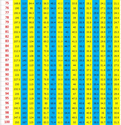

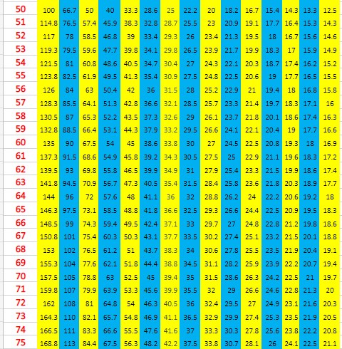

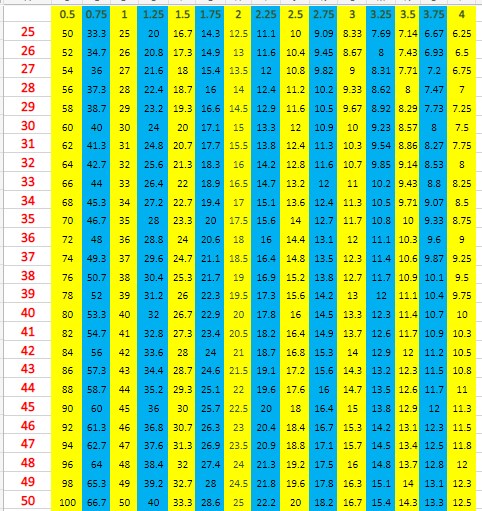

Here is how that all looks. KZ size in inches across the top, distances down the left side. (tough to get it all screen shot'ed in and still be visible so this is three screen grabs, and yes, the 50 and 75 lines appear twice)
