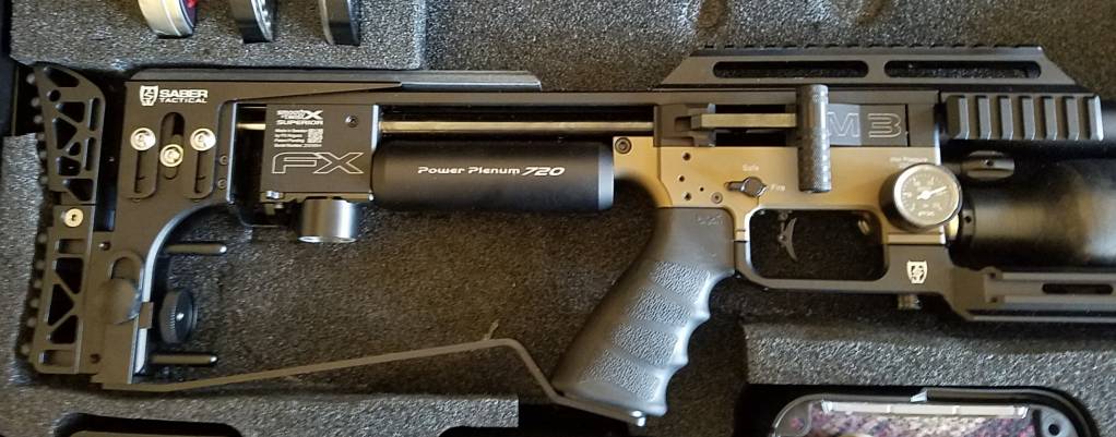

I got a used M3 .22 and I need to get it back to the exact factory tune for a video review.
Anyone remember the exact numbers on their .22 M3 out of the box?
my guess: Reg #1 at 105 bar / Reg #2 at 75 bar / Quick Tune 3 / Power Wheel 8 / Front Valve Adjust Knob at exactly 4 lines. (for 18.1gr).
