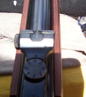

Not to say its to check a zero of some sort. One i got new out of the box the rear sight blade was all the way right ( all the way) and shot 2" left of the bullseye at 50' ..lol. I was like wow , you got to be kidding , is this now what hw calls good and ship it to be sold ? ...lol.
Lucky i found the problem and it was corrected . And shoots great and stright sights right down the middle..

That gun above I got hitting left and rear blade all the way right out of the box .
A little new gun tlc got me here
Bout middle as it gets..
Most was barrel filth and hinge bolt adjustment. Took me 2 full days of soaking with mean solvent for 2 to 4 hrs and scrubbing harb between soaks to get that hard jb weld like stuff out of the rifling . Most at where the barrel goes into the breech block . A wad of it .. once clean and mirror shiny stright shooting from there out.

A air gun sight is 1 click = 1/10 mm @ 10 m. Official 10 m bullseye ring is = to 4 clicks
You can handle that and sight'er right in.😉
