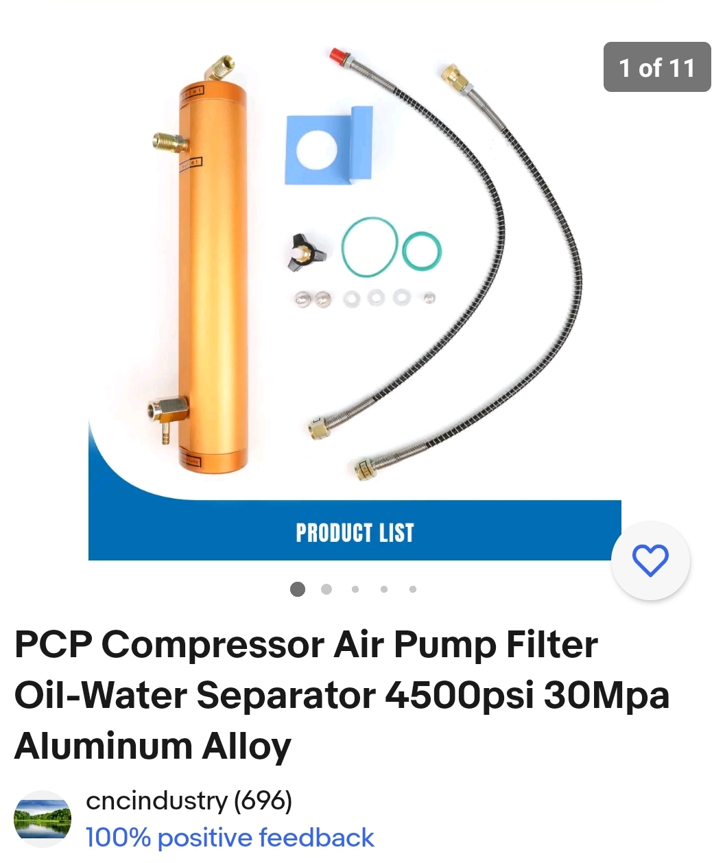

This is what I decided on. I saw a video by a guy using it on his channel. Can't remember but it's a popular one and he did a good job explaining it. But now I am second guessing my decision as this type is solid state. There is no opening or changing of desiccant.
Good deal. Be sure to mount it vertically and drain any moisture after each use.
