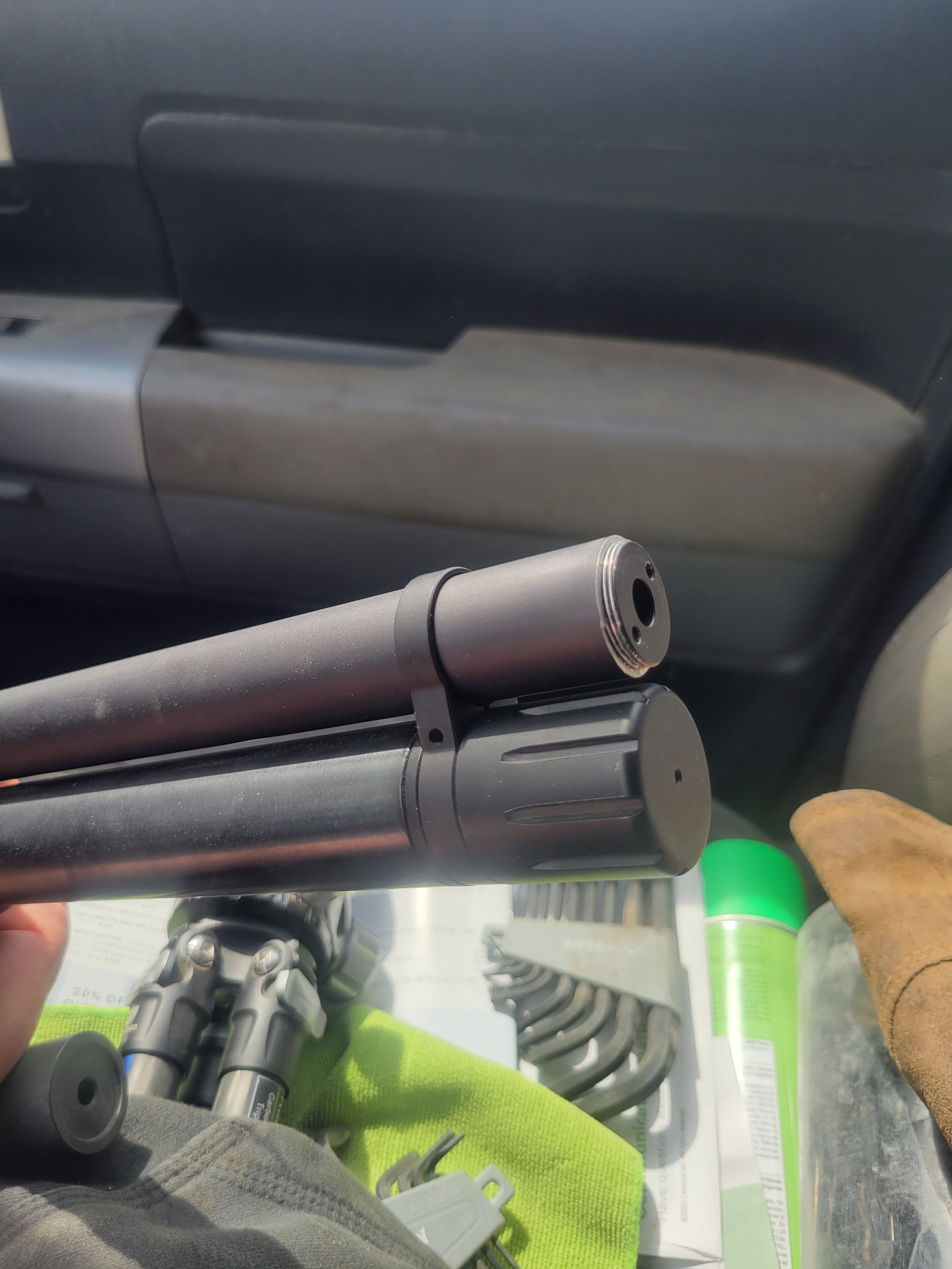

Just loosen the barrel band first. It shouldn't be an issue breaking it loose. Then slide it off. There are 5 baffles inside and a retainer nut. The nut will need to be removed before you turn it around to the other side. The part sticking out on the end is the retainer nut i speak of.

Just loosen the barrel band first. It shouldn't be an issue breaking it loose. Then slide it off. There are 5 baffles inside and a retainer nut. The nut will need to be removed before you turn it around to the other side. The part sticking out on the end is the retainer nut i speak of.View attachment 355646
OK looks a little bit more involved than I was thinking. Hope I don’t damage this gun.
