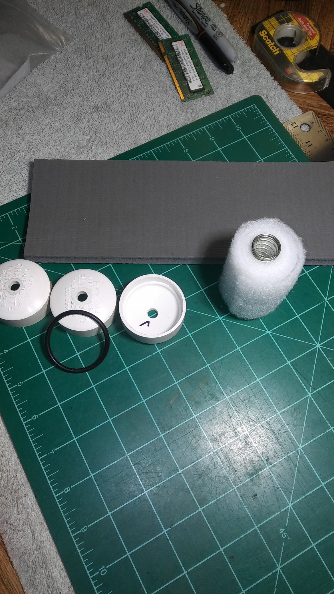

I wrapped the felt that it came with as tight as possible. Held it in place with a couple thin strips of masking tape.
Next I wrapped the core with this heat register filter stuff I found at Home Depot for 5 bucks or so. You'll have to cut them to fit but wrap them as tight as possible, stuff as much as you can in there.
Next I slid the can on that I had previously wrapped, 2 layers thick in neoprene foam from Hobby Lobby. You get a 8x15 sheet 3/32 thick for a buck.

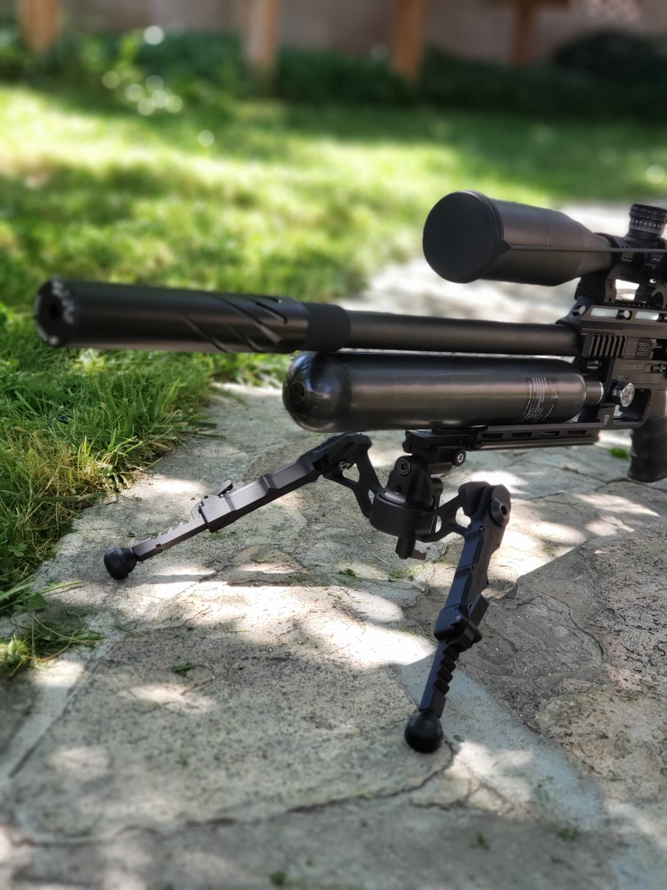

And the end result is
