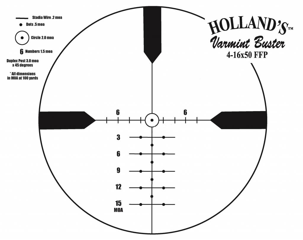

As an old timer, I find many of the new scopes, those with a plethora of reticle variations, virtually useless in the woods, especially under low light. I have a couple of FFP scopes, with MOA hash marks. When using them to range distance on a target, they're great. But put them in the woods at sundown, and it's a nightmare of unintelligible information. Have we outsmarted ourselves? For hunting, I believe I'd rather have a good duplex reticle. I can handle the hold without translating a lot of unneeded information. Anyway, I was just wondering if I suffer from aging, or if others might feel the same.

The DYND-1 reticle on the Aztec Emerald is very unobtrusive. The Christmas tree is there when you need it, not noticed when you don’t. Very effective, especially the IR FFP version.
for me it depends on the use case. for long range gas guns, shooting multiple targets at ranges between 100-800+ yards, a tree reticle is invaluable if you know how to use one. after a while, the tree disappears for me until i need to use it, even at higher magnifications.
