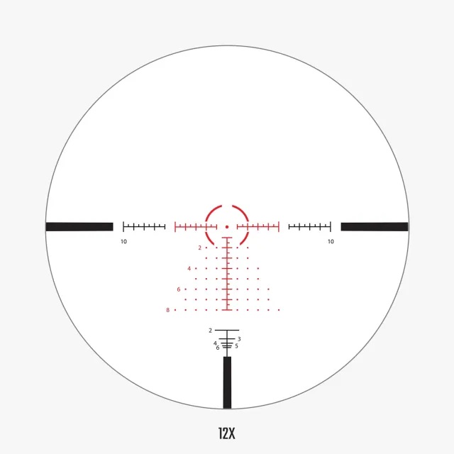

Athlon Helos BTR GEN2 2-12×42 AHMR2 FFP IR MIL . Compact, generous eye box, bright, great reticle for quick acquisition, perfect for pesting under 100yds. On my FX Wildcat MK3 .22 shooting JSB Hades @866 giving me 175 shots. My bird gun. Perfect.

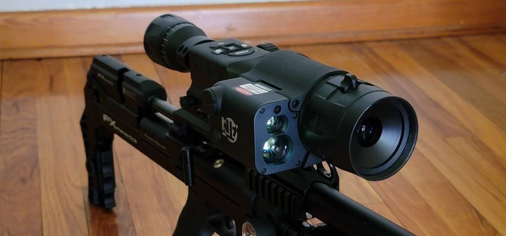

My favorite hunting scope is going to be an outlier here.It's the ATN X-Sight 4K Pro 3-14x Day/Night Scope, with the ATN ABL Laser Rangefinder add-on and the ATN X-Trac Bluetooth Remote Control.

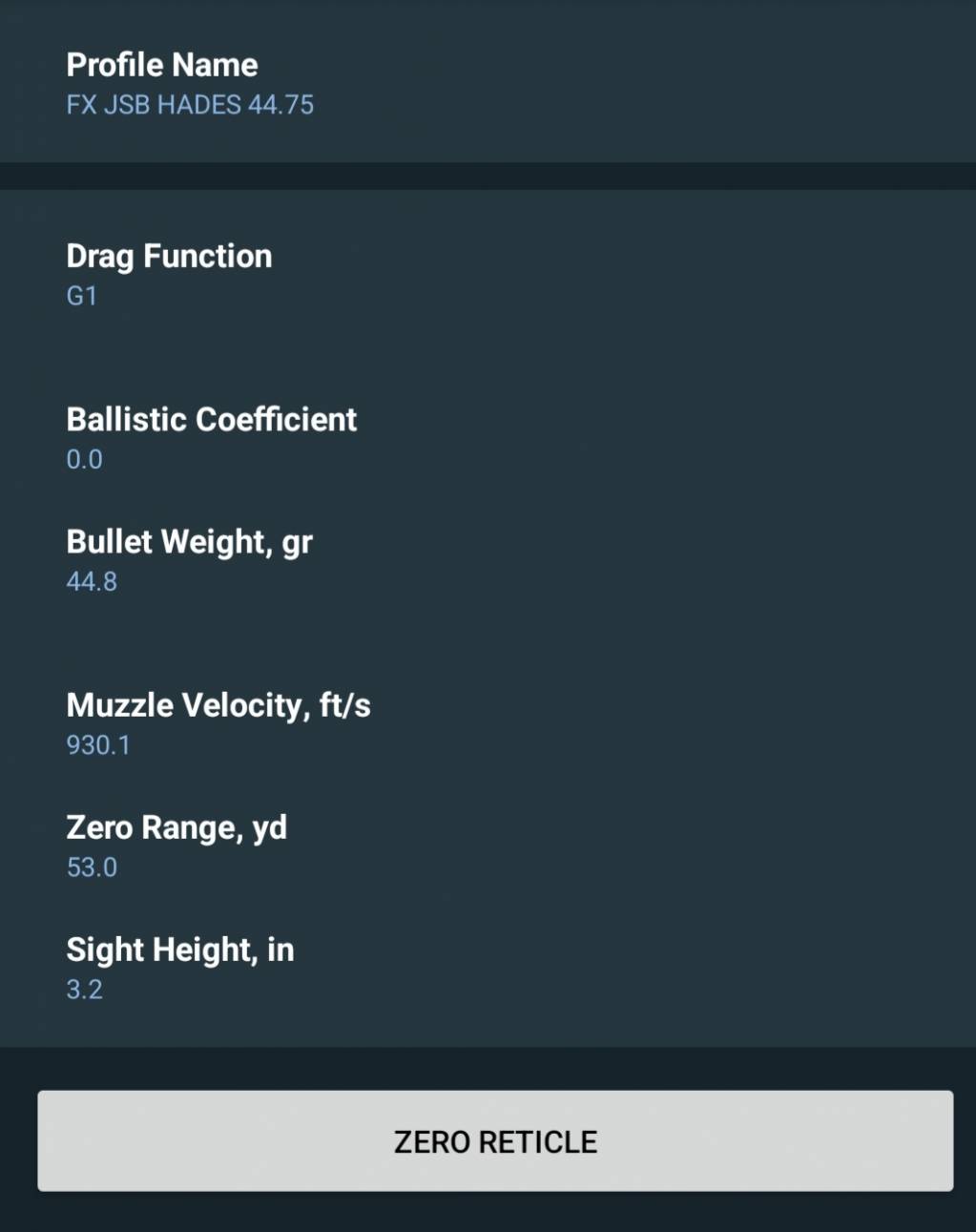

As an airgun hunter or pester, one of the biggest challenges to getting ammo on target, is knowing the distance to your quarry, and knowing where you must aim, or how you must adjust your scope so that your reticle aligns with the POI. The absolute main reason this is my favorite hunting scope system ​​is because of the integrated Ballistic Calculator. It's like having the Strelok App built into your scope! The way this works, is you setup a profile in the scope for a particular ammo (let's use JSB Hades .30 cal as an example). Now look at these screenshots from the ATN Obsidean Phone App connected to my scope. Using the app is optional, and is not needed at all when swapping profiles.
You fill in the info for the ammo and that, along with the zero information for that ammo is saved into the scope. Now here is the where the magic happens: With the click of a button, the ABL rangefinder add-on measures the distance to your target, and moves your reticle to the calculated POI. No holdover or hold under required, no scope dope, nothing. Just range and shoot! It even has elevation and cant taken into consideration, so whether your target is up in a tree or down a ravine, you still just range, point and shoot.

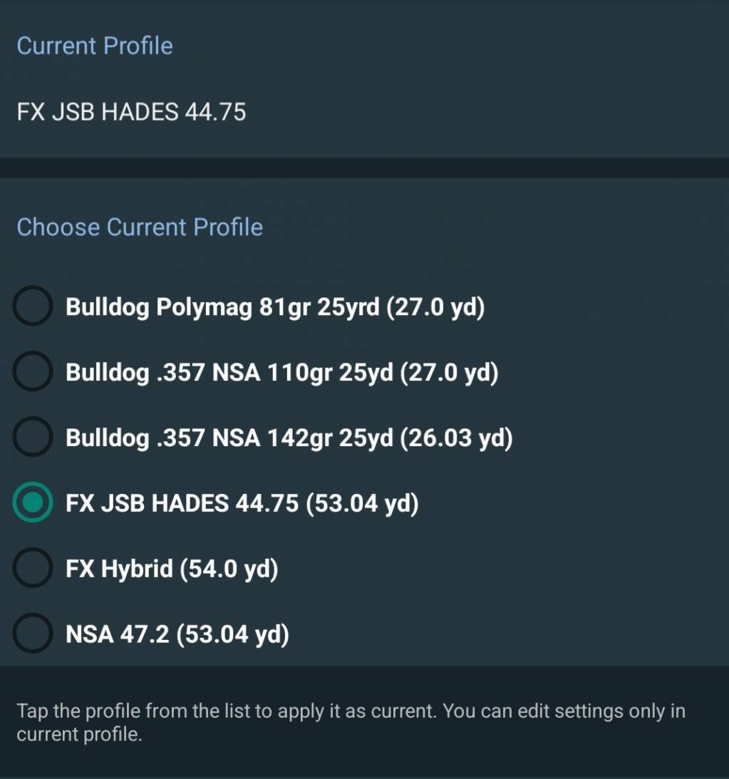

You also see in the screenshots that I have different ammos listed, it's as easy as just selecting the new ammo profile, and now my scope is ready to shoot because even my zero data is stored! I even switch this scope between two different airguns with a QD mount, and the process is the same!

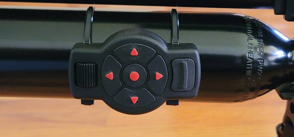

Using the ATN X-Trac remote control, I never have to break from my firing position to zoom in and out, range my target, or start recording video or take photos!
As you can see, I have my remote mounted to my air bottle, and it's a piece of cake to operate with my thumb while I'm still holding my gun! 😃

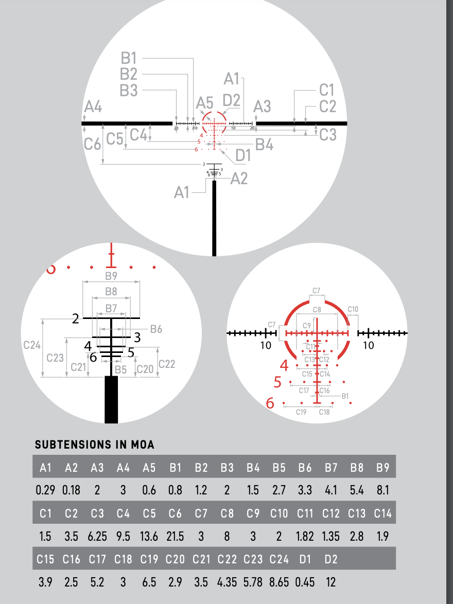

2L8. Am I reading this manual correctly?. Does the reticle subtensions correspond with the numbers. From what I am reading the lines in the reticle do not match the actual MOA for example line 5 would actually be 9.5 MOA.
