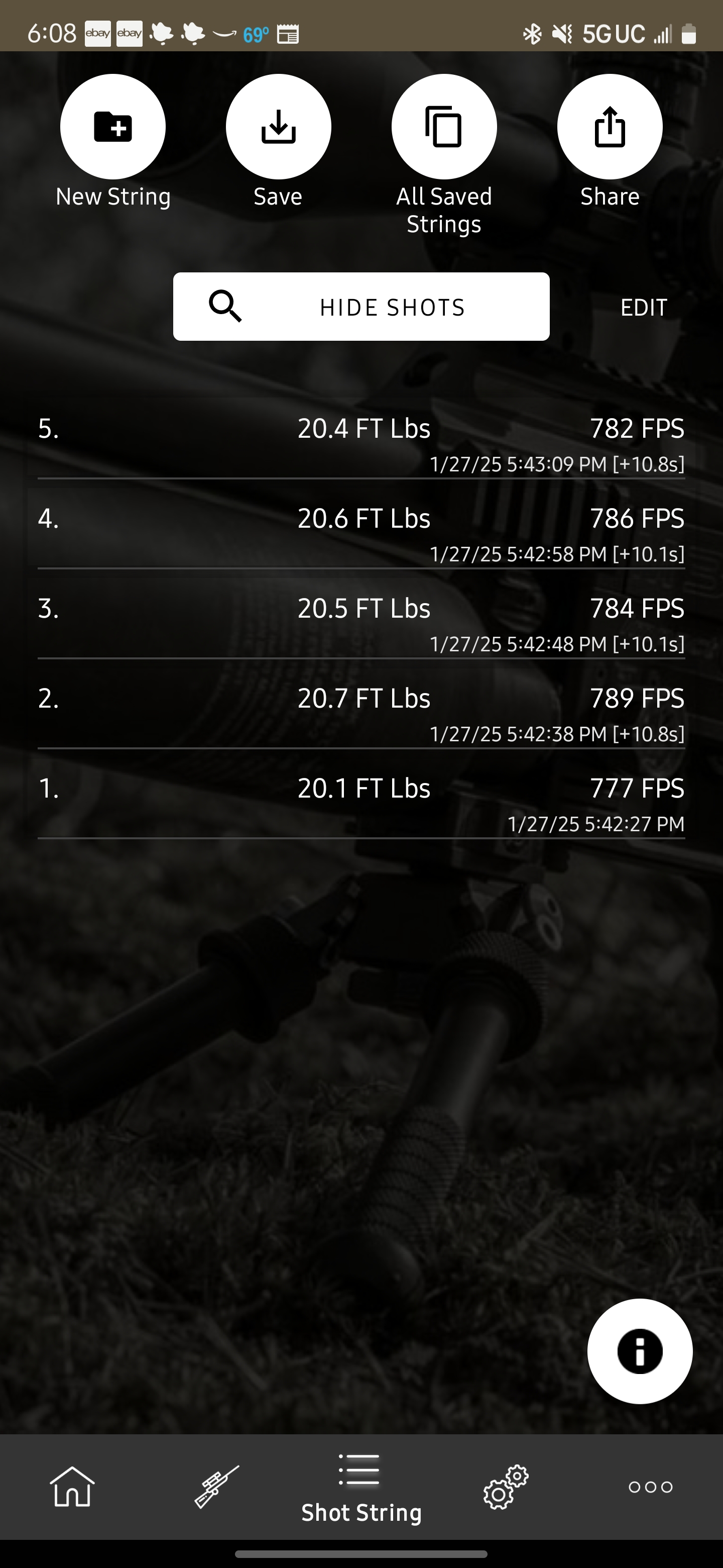

Currently shooting 15gr Varmint Knocker slugs mid 780fps. Hammer adjustment is flush (tune kit adjustment) and port is fully open.

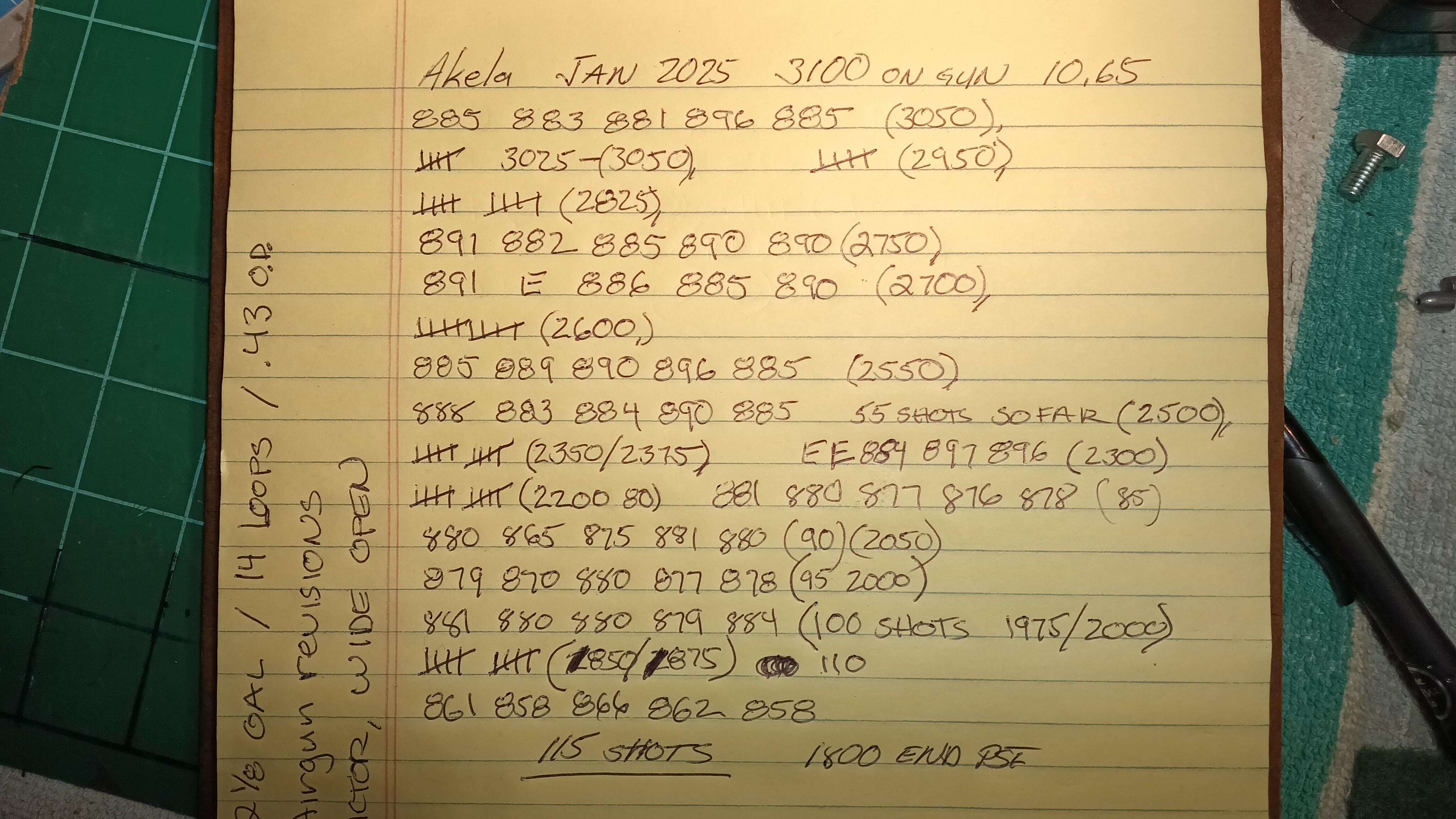

Here's the latest shot string. Have a hardware store hammer spring in there. .062 wire, 2.125 long, .433 outside diameter, 14 winds of wire. Using air gun revisions valve spring and their Hammer spring adjuster which is flush. Transfer port is wide open. Shooting h&n barracudas 10.65 grain
