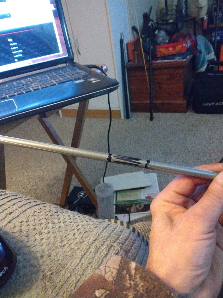

OK. Here's a follow up............
Pulled the liner and checked it today.
Not good news!
The hammering left a couple swells in the liner that I can feel when I push a pellet through.
I marked the swells with a black band and you can see those in the picture.
Bottom line? DO NOT try to hammer stuck things out! You WILL screw the barrel up!
Pulled the liner and checked it today.View attachment 309315
Not good news!
That's a shame. Have you shot it since when you cleared it earlier and before you discovered the bulge? Any noticeable accuracy difference before and after? It DOES look like aluminum. That's hard to beleive, I'd figure steel for sure.
