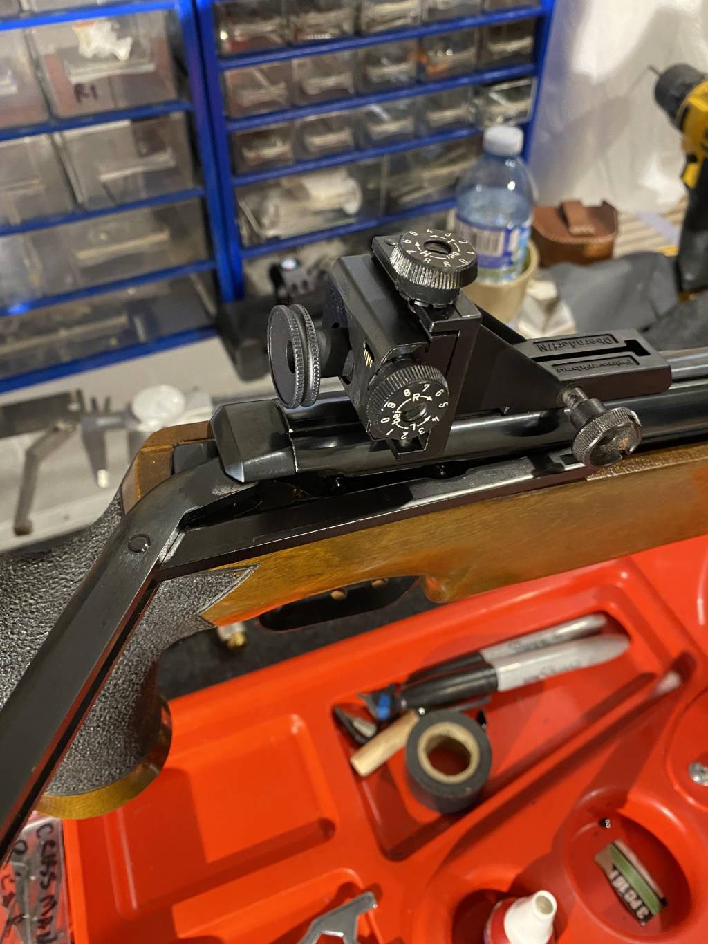

 I am enjoying this, had to buy, my first older rifle with a diopter.
 I cocked it, not able to close lever.
Is there a release?

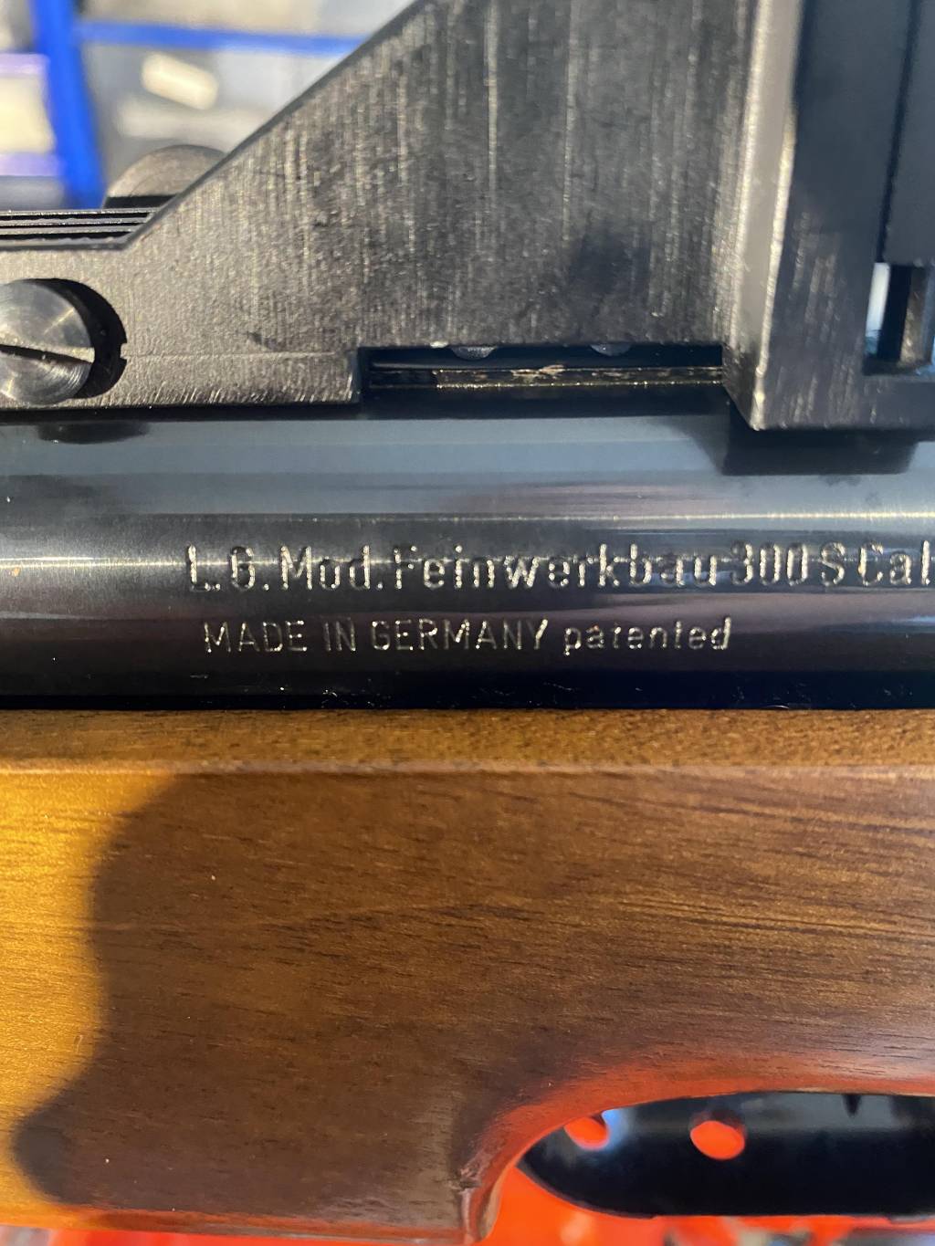

Check your serial number against these;
mod.300S

Wow! A Tyrolean stock even. As far as releasing the cocking lever the first thing to check might be to verify that the anti- bear trap “ratchet” has cleared so that the catch can swivel and head the other direction. You’d need to take the stock off to do that.

I’m overwhelmed. Thanks DualMagMike for dating. It’s mid 77 as well. ‘Small world, wouldn’t want to paint it”.

Another random note: your gun has the earlier style diopter sight. To remove it, unscrew its clamping knob all the way out, and then slide the sight to the rear. The knob's shaft sits in a recess across the top of the receiver, and the end of the shaft will scratch things up if it doesn't clear everything. (Later examples had a different quick-release design to improve this.)

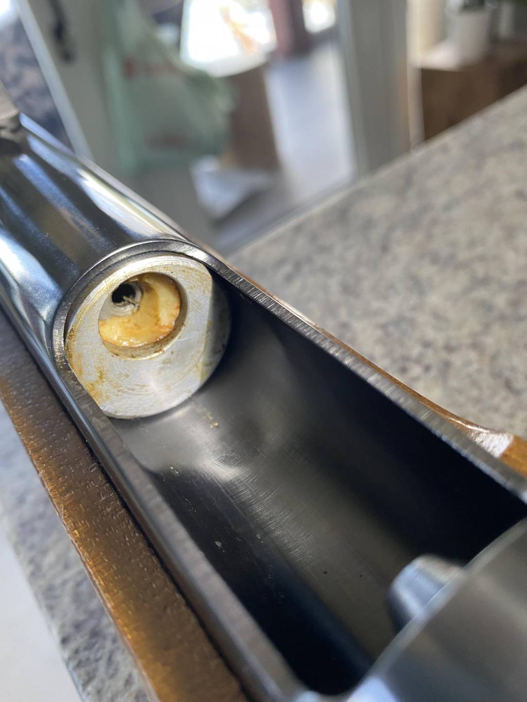

OK. Got time today to look at things. I have a side lever Pro Lam which I looked at, kind of same mechanism. I’m a big pussy, didn’t push lever back hard enough.

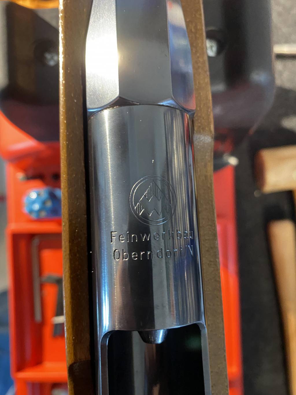

If you look at my second last pic. “overwhelmed” the lighter metal chamber slides, I think the grease is old and hard with debris, and causing the tightness.
I put a Hades in it and it did not push round out. I felt a breeze on face. I emptied the barrel.
When I cock this gun there’s hardly any resistance.
Any suggestions?
Crow
Any suggestions?
Crow

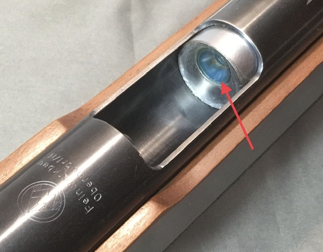

Does the gun have a breech seal in place? There should be a white, blue, or green resilient piece in the front of the cylinder like this.
"Hardly any resistance" is about right for a 300S, LOL! The internal design is very efficient, so massive springs are not needed to get target-rifle velocity. You can literally cock one with your little finger.
Reactions: crowski
The white material is the ancient OEM seal; newer ones are blue or green in color. Very likely the gun has not been looked at in many years.
The FWB's are almost unique in having a resilient bumper on the front of the piston, this provides important cushioning (unlike most springers, there's little braking effect from the gun's near zero-length transfer port). It's made from the same stuff as the breech seal, and almost certainly has also failed. The gun must be dismantled to replace that.
FWB's are massively over-engineered - damage is unlikely, but definitely don't cock it again until someone has been through it.
