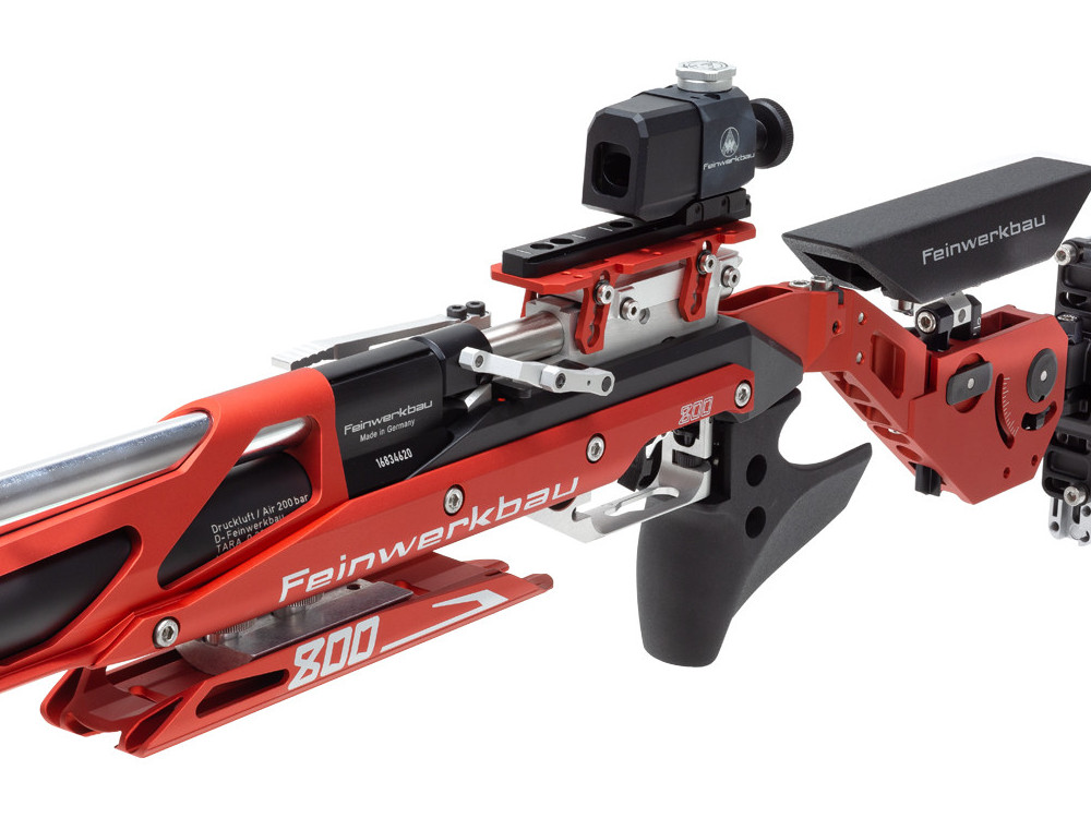

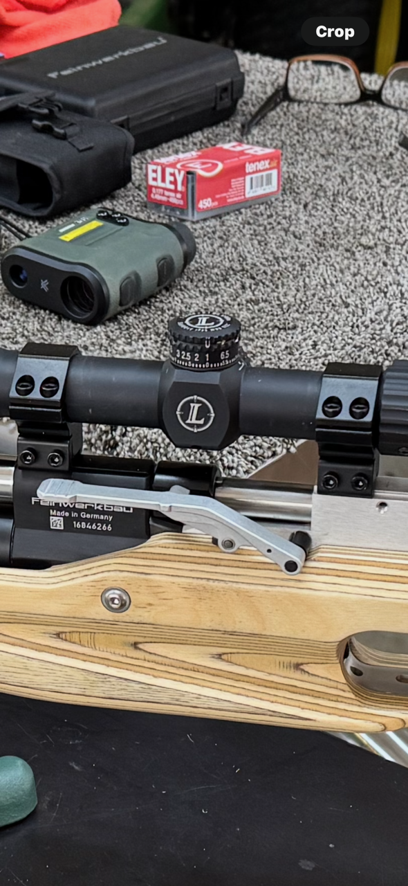

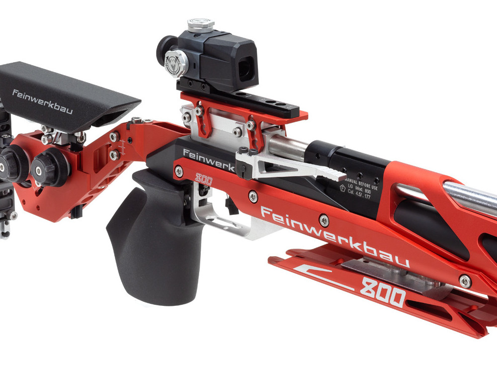

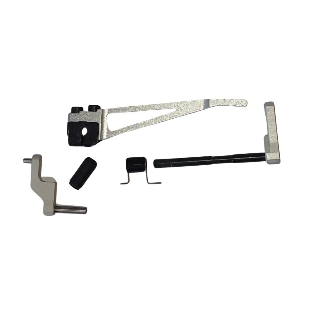

I recently purchased a new LH Feinwerkbau 800 Universal with the cocking lever on the left hand side. On the 800 universal the cocking lever from the factory will only ratchet up no matter if you get the LH or RH model. When I look at the 800X I see it uses a cocking lever that allows you to place the cocking lever at any desired position to avoid scopes or mounts. I found a dealer that sells the complete RH cocking lever for the 800X but wanted to know if anyone has compared the two before? Are the actions the same with just different levers. When I look at the two in photos they appear to use the same holes to retract and engage the bolt.
The 800x
The 800 universal.
The cocking lever kit.

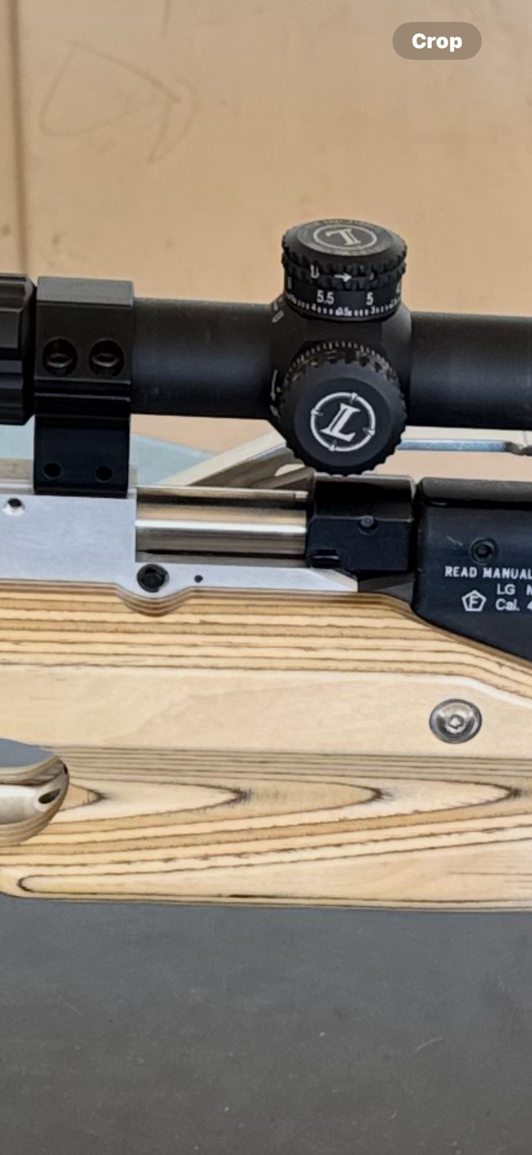

Just curious if anyone else had already tried this change?

Glad to see it worked out for you. I was looking really close at the FWB Universal recently; and a bunch of other ten meter rifles. I ended up going with a Walther LG400. How do you like your FWB overall?
