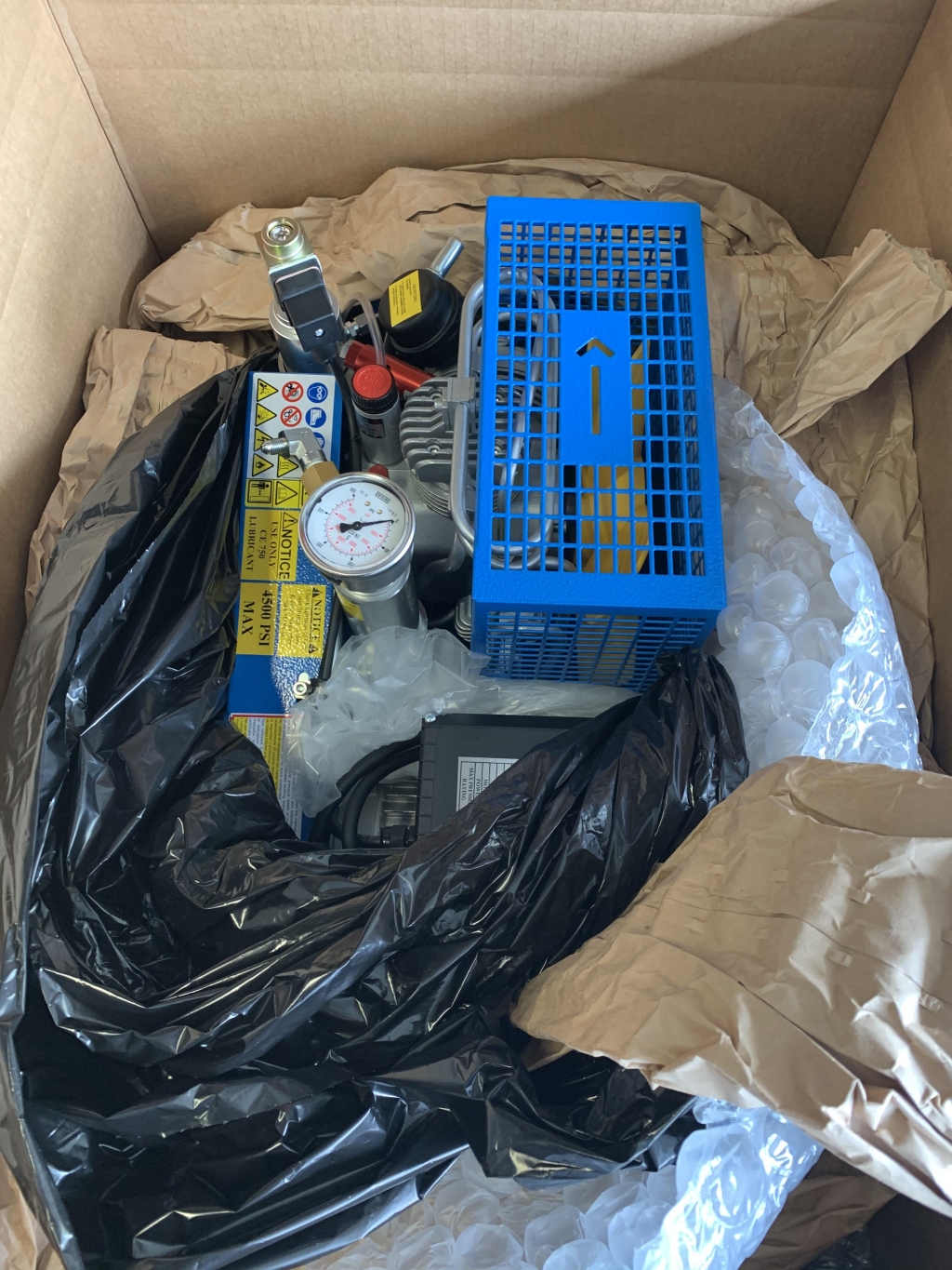

Ferrari has arrived šŸ‡®šŸ‡¹
Itā€™sĀ finally here. Been shooting pcp for about 4 years now. Started off with a small AV tank then upsized to their 97cf. Was filling at the dive shop for 8$ per fill to 4500psi for the first 2 years. Then seen the nomad 2 and thought it was gonna be something reliable and affordable but thatĀ didnā€™t last for 7months. Went back to the dive shop for filling after. Was looking into getting the daystate 110v but decided to go this route. Just received it about an hour ago šŸ˜Ž
