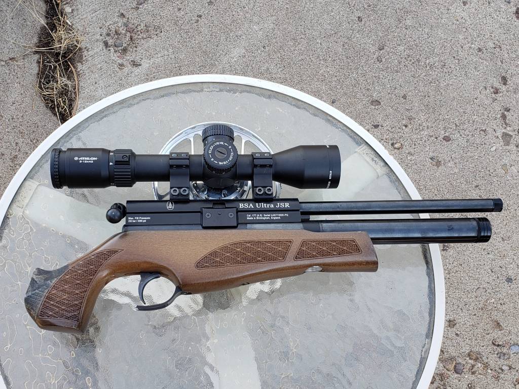

So, last night I finally got around to adding the Athlon Helos Gen. 2 2-12x42 to my Scope Specs Table.
And those specs
look really good in comparison!!

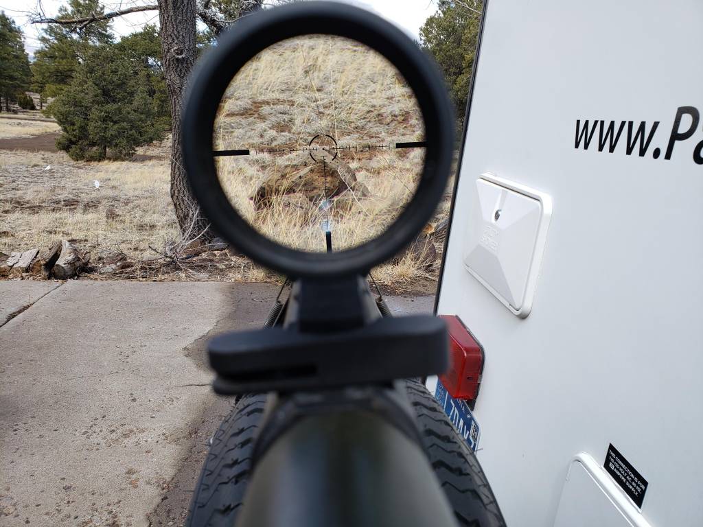

▪For those quick shots at low magnification it has a
circle of death — no other scope on the list offers this. Great feature for an FFP scope with a large 6-fold magnification range.

Something I noticed I almost missed:
The MIL reticle is a holdoff reticle, with
evenly spaced hash lines.
The MOA reticle on the other hand is a bullet drop compensation reticle (BDC), where the hash lines are spaced
unevenly according to the required holdovers of particular
PB cartridges at 100 yards, 200, 300, etc.
