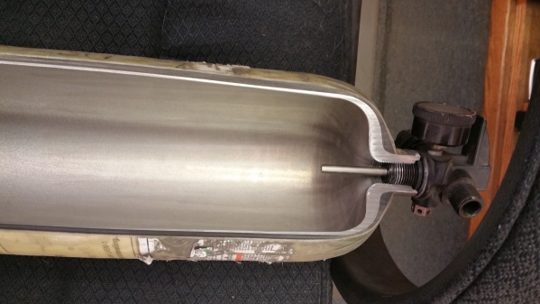

@tutuan and @dan_br, the person selling the tank doesn't know what he/she has. Its an SCI tank (Structural Composites Industries) CFFC tank, a.Carbon Fiber filament wound tank just like all the other SCBA tanks we use. They start with an aluminum liner, spin wrap it with carbon fiber filament, then wrap fiberglass sheeting around the carbon fiber for protection, and finally coat it with an epoxy type clear (or color) coat. They're all five year hydro and 15 year service life. See link below for DOT-SP-10945 tanks.

The shop I get my tanks filled at had this example.

Wow, hat off to you sir, for the effort to get into details and accuracy. You are always a good solid source of information in this forum. Too bad i cannot give you more pluses, lol.
The DOT-SP-10945 document confirms 5 years hydro for tanks manufactured and tested after 2001.
