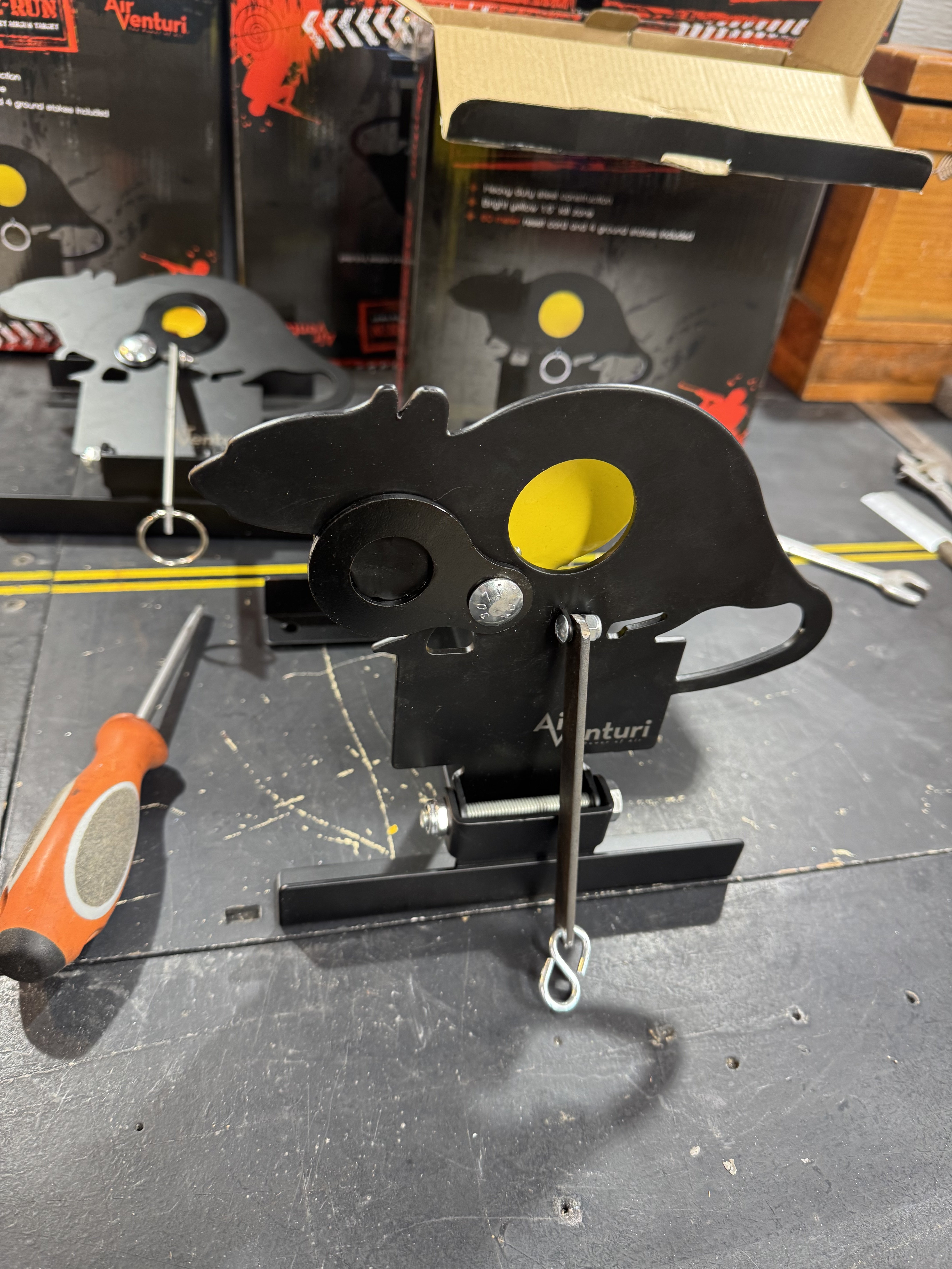

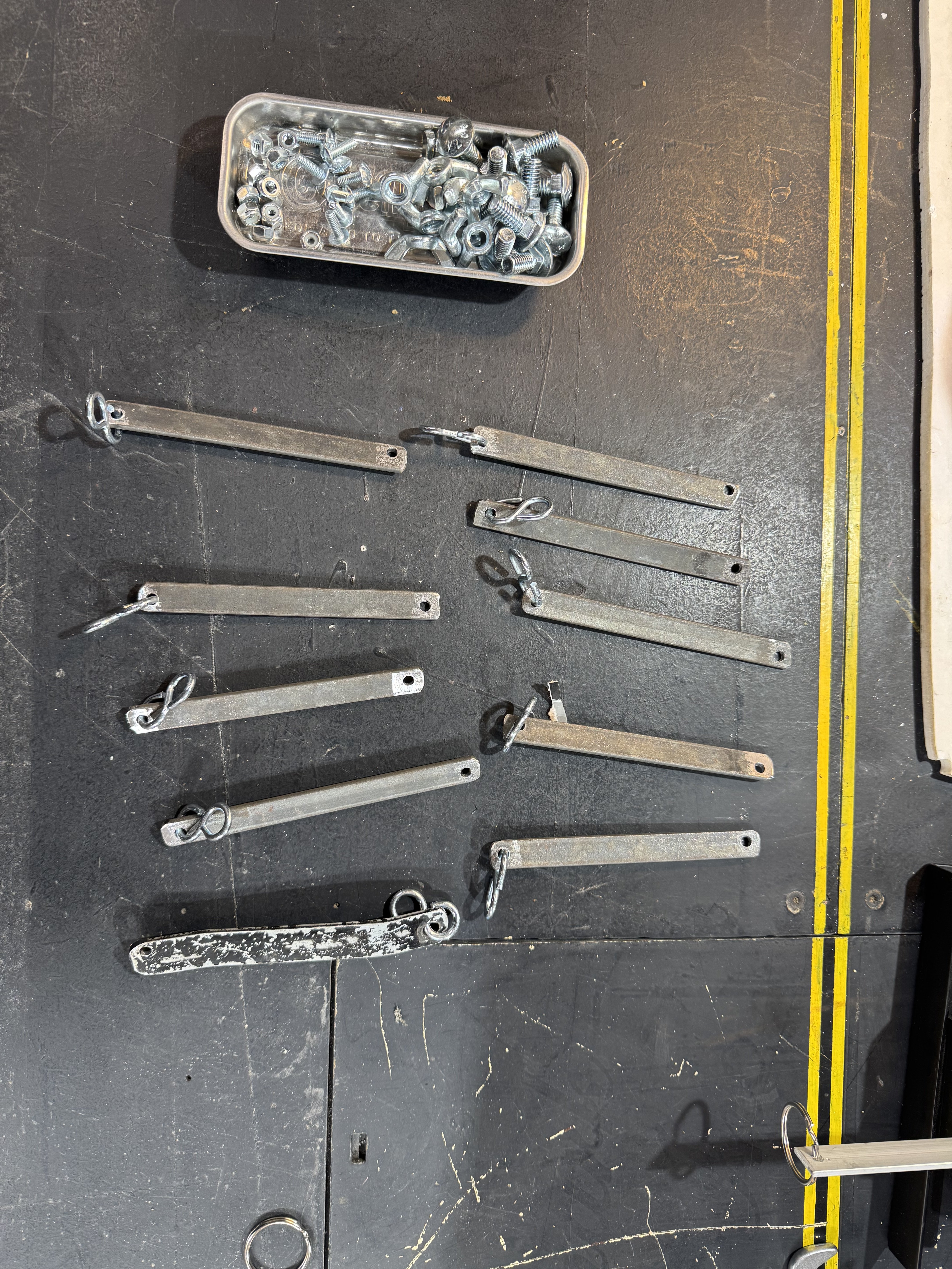

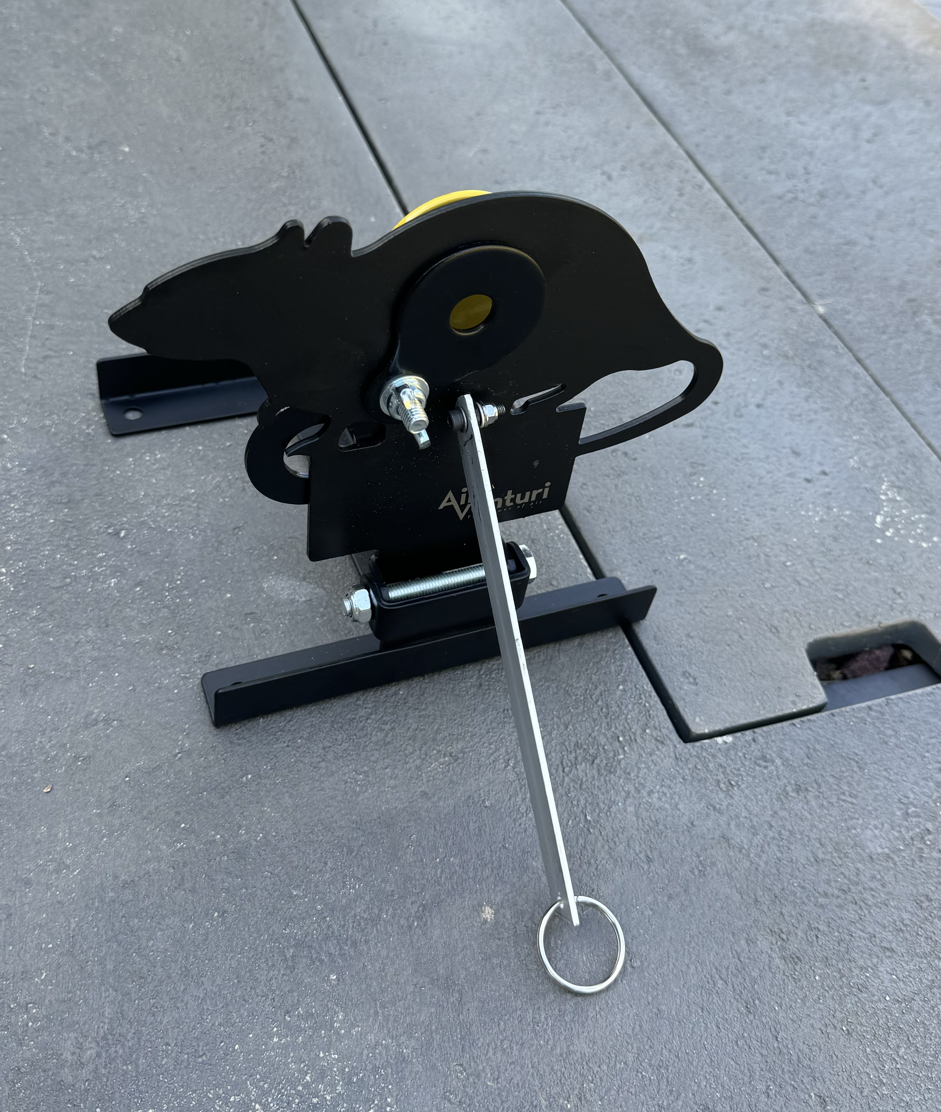

This is what I do to each target . First the reducers need to be on the front. Then I add a metal piece to put the string to the ground. The wing nut obviously goes on the back side. I was still cutting the bolt down.
And that is the best target for the money.... the "Rat on the Run" by Air Venturi. Heavy duty face plate and paddle... way stronger than Gamo and their copies.. and about the same price.
The low profile also helps stop any "Rattle downs" you can get with a higher profile faceplate. These are really reliable and dependable... and hold up on the long term.
We remove the kill zone bolt and reducers and weld one of them on the front if we need smaller KZs
I like the added arm, that's great..

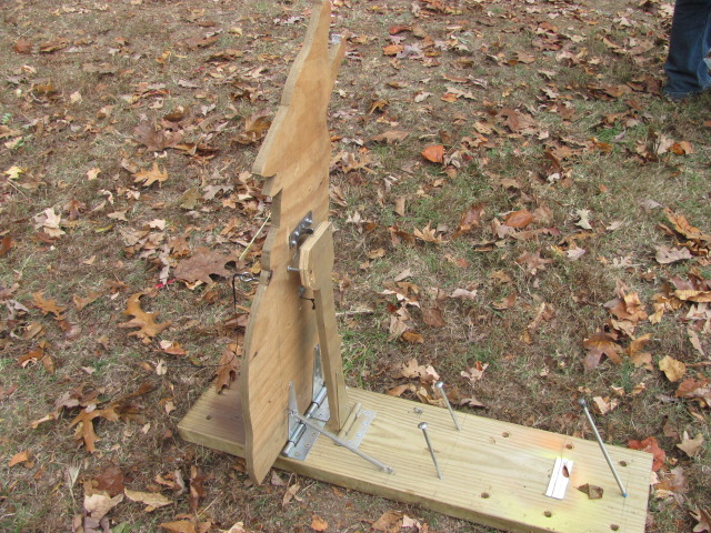

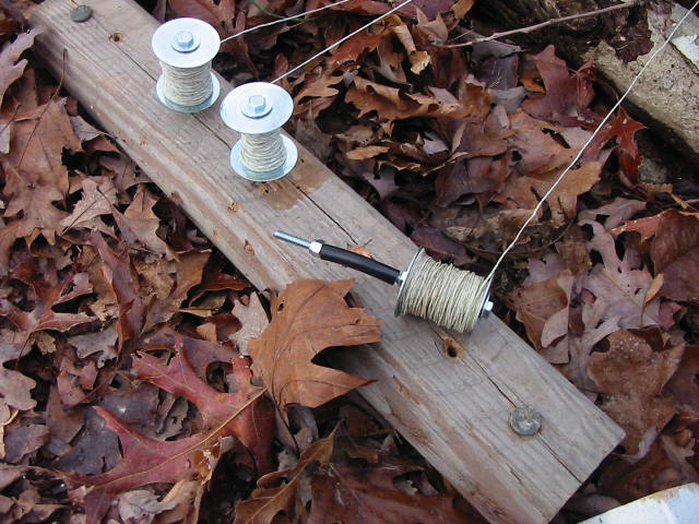

Braided dacron line. Do not be afraid to make one based on Brad Troyers LOW budget (scraps from the shed) falls at 4.5fpe easy & works a charm when correctly made-easy- targets for fun! Including a picture of his homemade winders (seemed thread rod & nut's and pop's right in a 12v screw gun or what
have you. 1 for each line.
