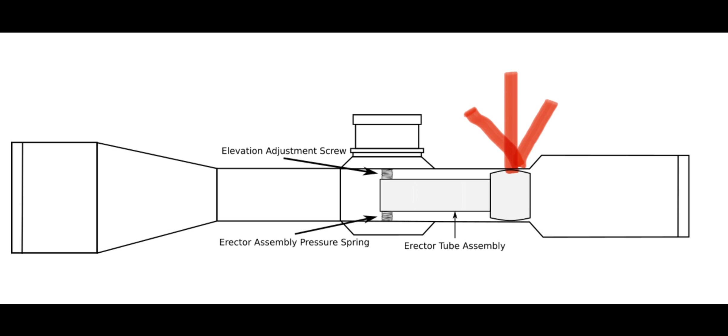

Scope height and target distance measurements should be taken from the scope’s erector tube gimbal. That is especially true for close targets. If you use anything else (muzzle, scope objective, etc) you will be off and that is why you would need to “fudge” at 10yds.
The scope does not “know” where the muzzle is. Sure, drop is calculated from the muzzle, but clicks and reticle holdovers are angles with the vertex being at the scope gimbal. That is the only point where you can expect consistency.

I don't think CG can adjust for canted rails/mounts, if it can i've never found where to do it.
You said “canted rails/mounts”. If you really meant compensation mounts, then you don’t need to adjust for that. Just use the correct scope height at the gimbal.
Cant is dealt with via correct scope installation and a scope mounted bubble level.
20moa rails are often called 'canted' scope rails.
The rail cant/compensation changes the poi similar to raising/lowering the scope height. If BC is known and you put in the turret height and did not compensate in the solver for the angled mount you won't get the proper clicks.
Or if you leave everything the same and swap out a canted/compensation mount with a flat mount your poi will change drastically even though the turret height did not change appreciably. I just had to do this for my 12 ft-lb rig when I went with a 20moa mount over a flat mount to avoid going a whole rotation up at 55 yards, my long distance clicks were completely different.
CG has no solution for this other than to start changing variables until things match the physically collected poi's.

Say that you replace a 20moa mount with a flat mount, and then add back exactly 20moa via the turret. If all else is the same as before, including the scope height, all of your poi numbers will be the same.
The axis of the erector tube is your line of sight. It does not matter if you add inclination via the turret or a compensating mount. The end result is that the erector tube points the same. The erector tube gimbals at the rear. As long as the scope height at the gimbal is the same as before, it does not matter whether the angle is from the compensating mount, or from the turret clicks. Once it’s zeroed, all of your poi points are the same as before. It’s the exact same triangle.
That said, if your turret adjustments are wonky, it’s possible that the click spacing is not consistent throughout their range of motion. In which case your poi points will not be what the math would predict.

This is getting lost in translation... The point i'm trying to make is if the only thing that changes is the angle of the rail, CG can't account for that drop unless you start messing with BC or something else to counter compensate.
That's simply the ballistic app method.....fiddle with parameters til it's as close as it's gonna get.
Reactions: steve123
Everything else being the same, when I add more MOA compensation to the mount, I reduce the clicks by an equal MOA amount, in order to keep the poi the same. It really is as simple as that. Nothing would change in whatever ballistic app I’m using.
However, adding compensation to a scope mount usually results in at least a slightly different scope height. You must remeasure and enter the new correct scope height value in your ballistics app. Measure it near the scope gimbal. If you take the scope height measurement at any other location, you are on your own, because the math will not work in that case.
