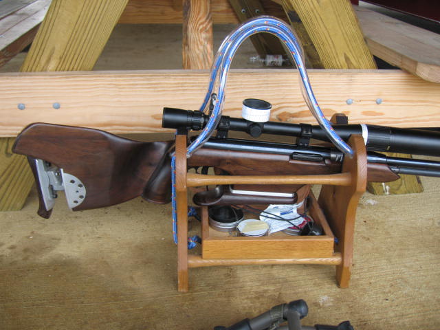

All Tx's but you get the idea, I like across the body both knees left hand holding right wrist but everyone is different. Once you can otushoot the fellow with the Blond stock, you can call yourself a good shot regardless of position. He's also one who "tunes to what thr file wants" so if it behaves best at 14fpe or 11.2fpe so be it and shoot in that class.
Then a TX "just right" for someone else with me using it, then the owner using it as it fits him flawless (Squirrels fear that fellow, nuff said). The last a home whittled stock whioch fit the owner perfect and therefore improved his scores.
Practice. Dont be afraid to try most anything that works for you. Some use bondo & block to makes thing right, and wexcelent results.
