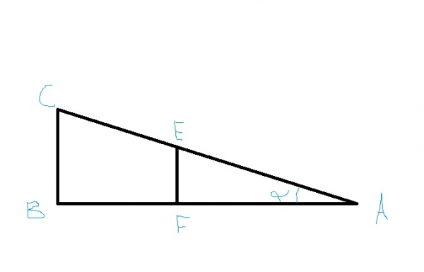

Further wanted to add that math comes from similar triangles and could be applied based on rules of proportions:
See my poor paint diagram:
We are standing at point A and trying to measure angle alpha.
AB is reference distance 100 yards, CB is reference height for the angle. 1 MIL = 3.6 inches at 100 yards, 4 MOA = 4.188 inches at 100 yards
EF is our object in the scope. If we look at it and see it measure 36 MOA and we know it is 8 inches long, then proportion equation is: CB/EF = AB/AF
AF = 100 / ((36 * 1.047) / 8) = 21 yards
