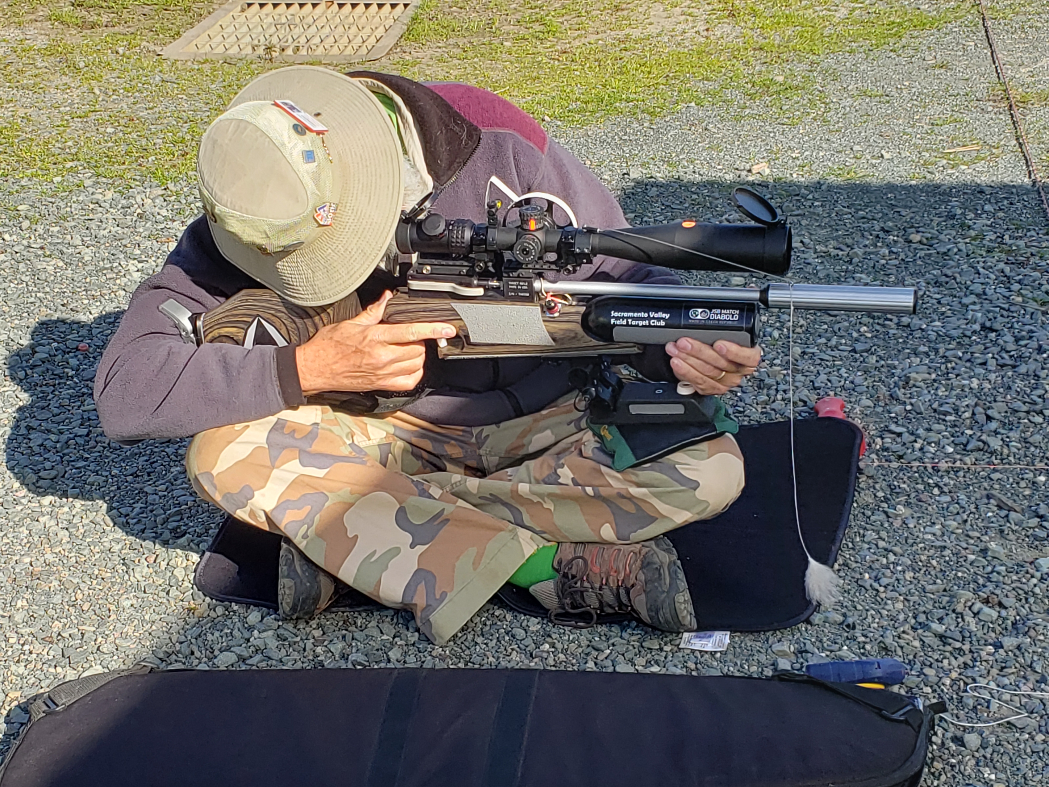

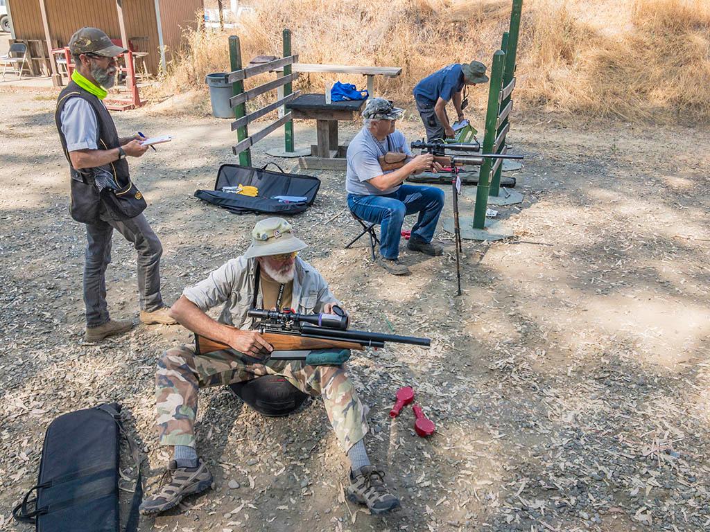

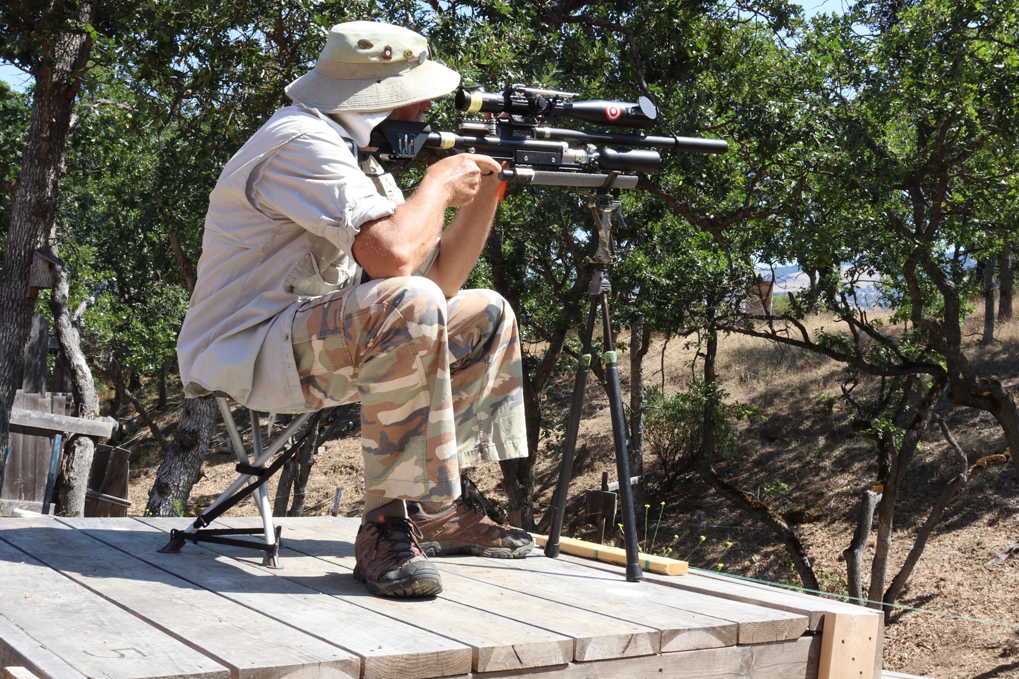

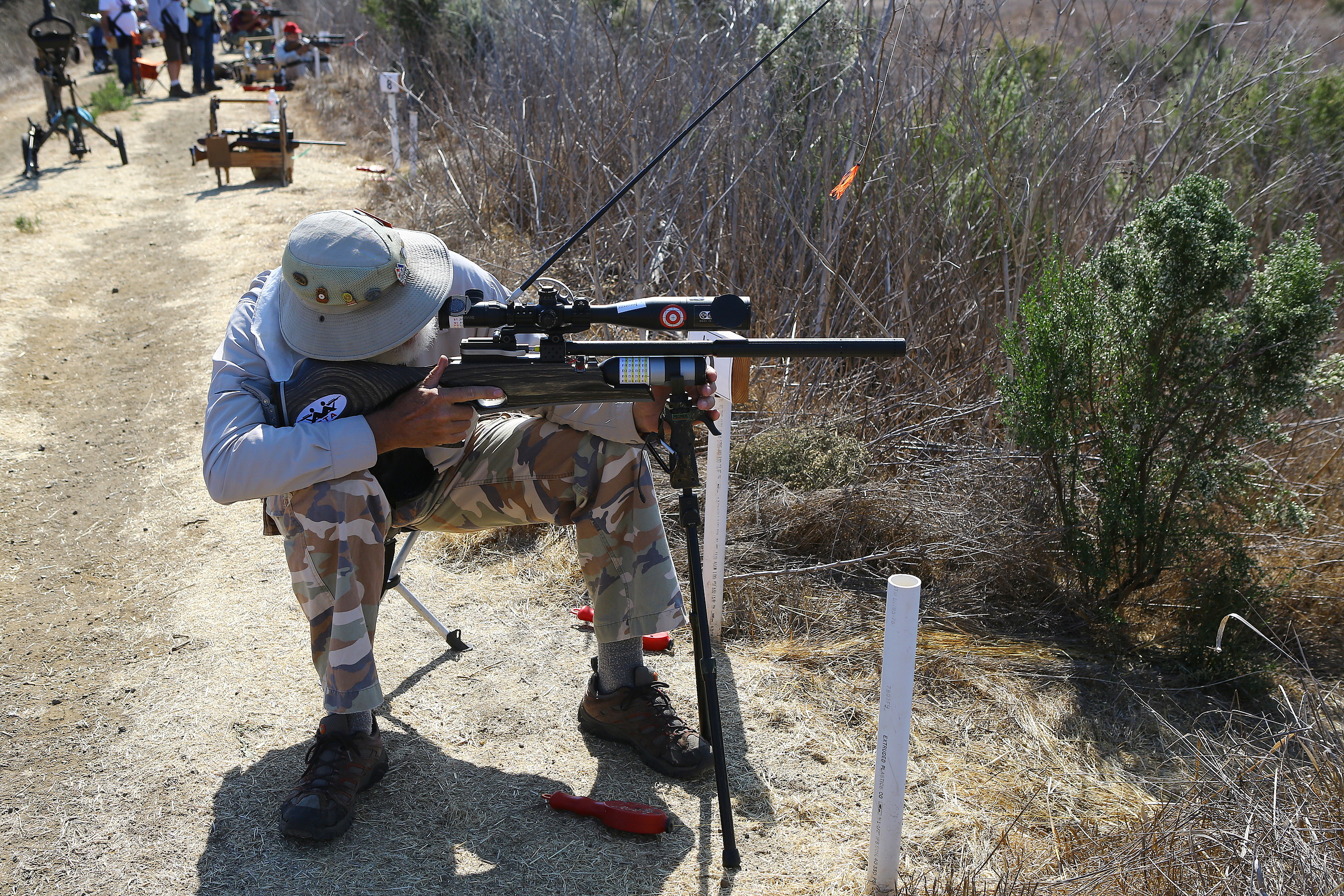

Seat, sticks, shot on shoulder ... Hunter class
Seat, sticks, shot off knee ... Hunter class
Pad , No sticks w/ hamster rest.... AKA the Deadman position in OPEN class
Bumm bag, no sticks ... dead man ... Hunter class
Threw the years shot all classes and tried most positions.
** Make note ... in every picture the trigger finger is OUTSIDE the guard, only bringing finger onto trigger before committing to the shot. SAFETY FIRST !!

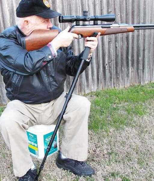

When using a bipod and sitting on a stool/bucket. can you rest your elbow on your knee? Your hand holding the bipod like a brace?
I'm not a formal FT shooter, but I think the answer is yes. I do a lot of backyard shooting, sometimes using a bucket and sometimes seated on my bottom deck step, kind of the same thing. Depending on the rifle, the V of the bipod is supporting the rifle either at the front of the forend, or on the air cylinder/bottle. It's not attached to the rifle, so I think it would be legal. And yes, my forward hand is at the juncture of rifle and bipod as you describe. I have found that the key to a good hold (similar to service rifle) is to form solid triangular support from the big bones. If you try to do it all with muscles it won't work.
