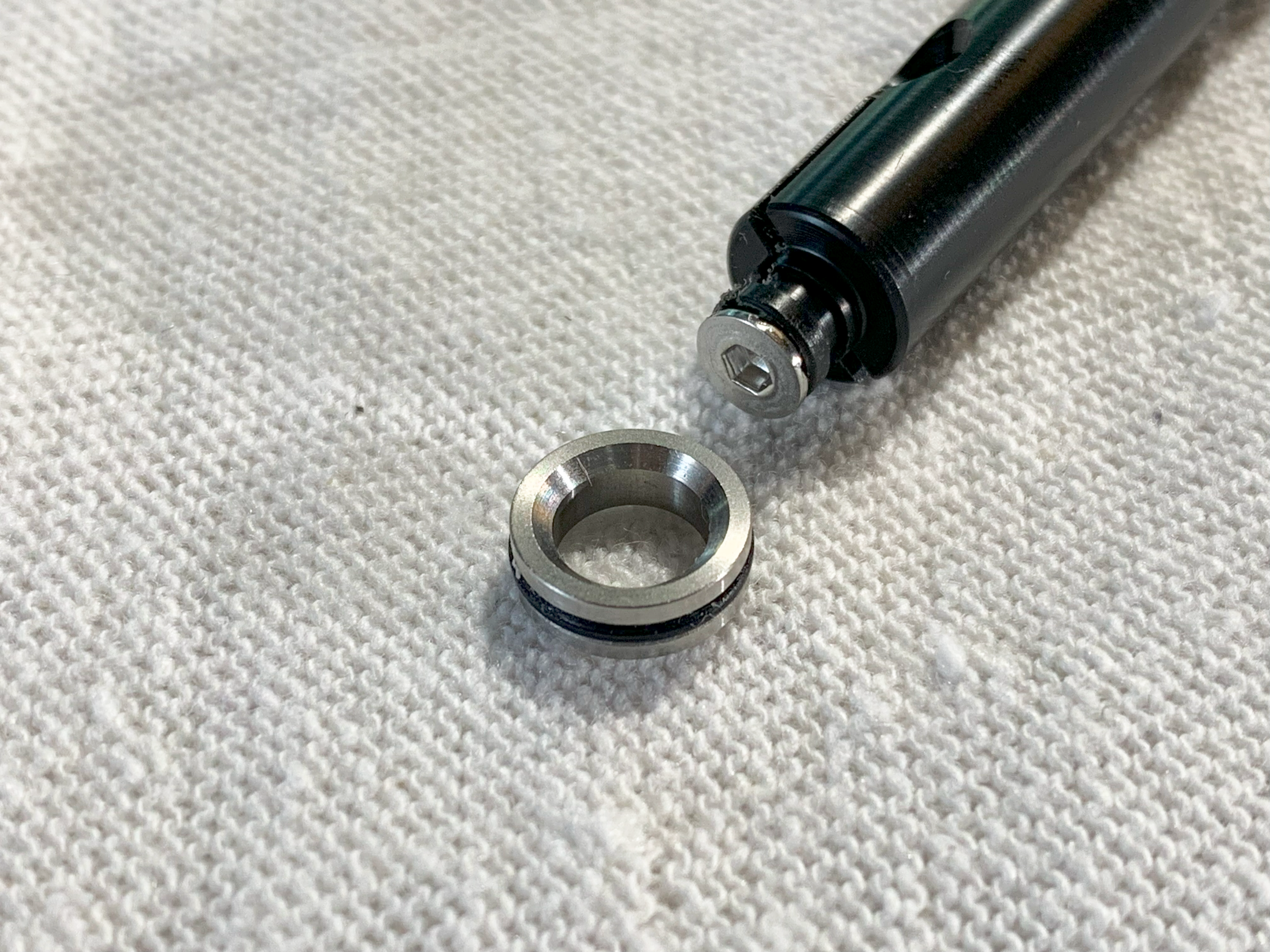

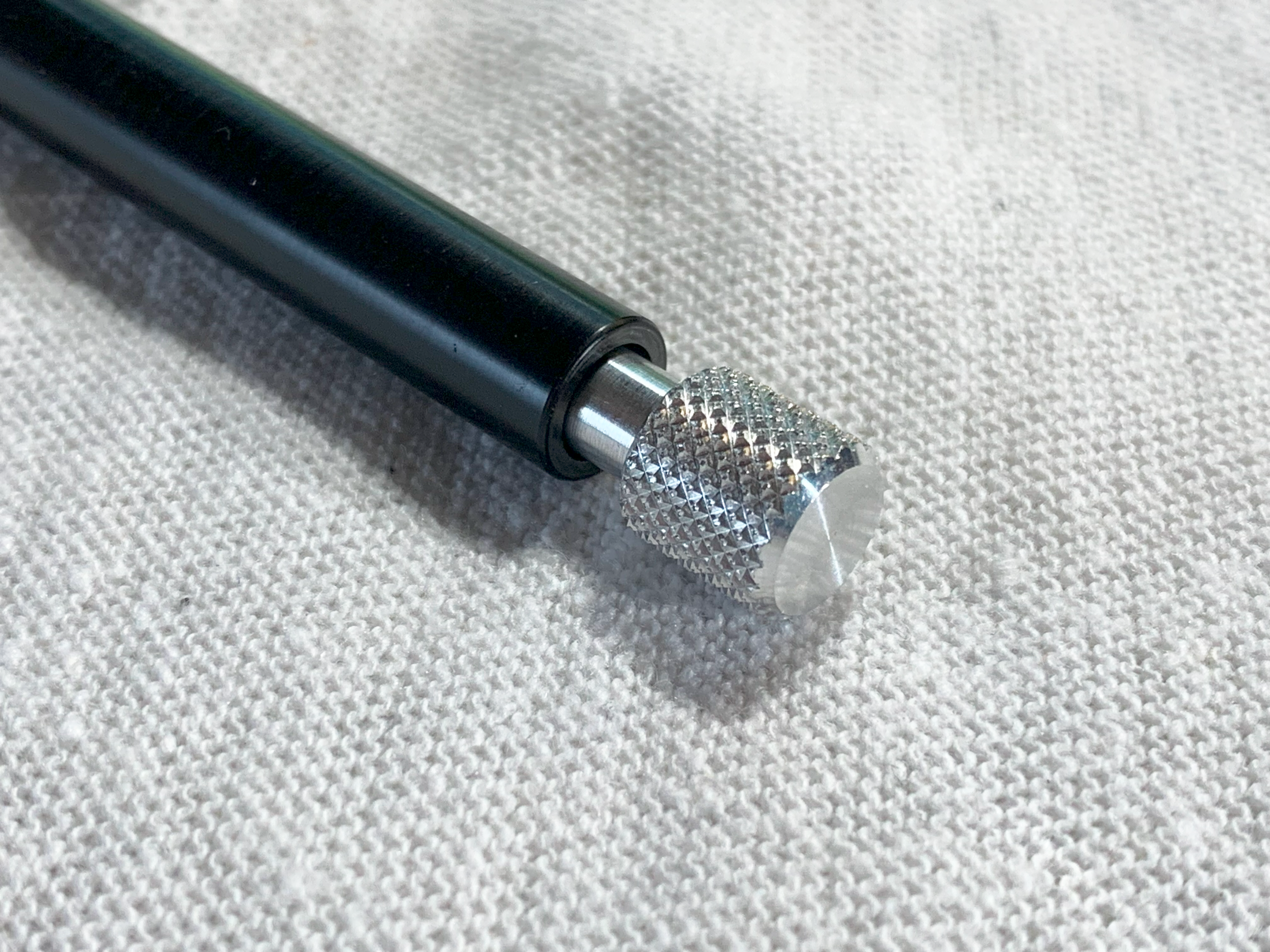

Okay, I figured it out. The valve seat was in there so tight that I thought I was doing something wrong. I had to really tighten things down so the lip expanded enough. And having to both push the tool into the gun while both pulling and turning the knob is awkward, but it does work... eventually.
For those curious, here's some pictures to give a better idea of how it works. There are little grooves on the bottom of the screw head that bite into the delrin when you pull and turn the knob on the other end:
