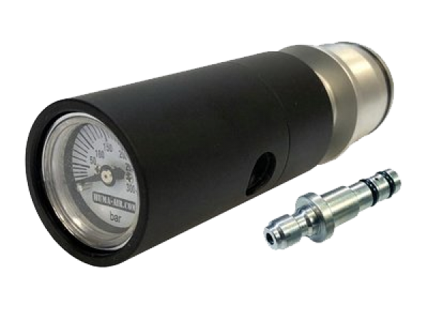

My set up looks like this one but came without the probe that's shown in this pic.

As far as I know there are 3 types for the non gamo type. The SE, MMC and CLX.
I have se and clx types and they do seem a little loose at times. Some of them I bought for dirt cheap on aliexpress and some came with the gun. I've used larger o rings in some. Usually a little grease then insert probe then connect foster to probe and open the valve wide open and that usually works for me.
I believe that the Huma website mentions the BSA probe and mine is a weird one but the se probe seems to work the best but it leaks for a few seconds when filling.
