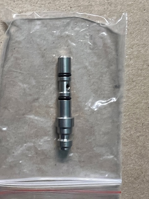

I have another good option for anybody with a leaking SPA or Bullshark fill probe. I bought a new one from Aliexpress about the time I ordered the O-rings. I do not know how to post a link but it showed up in an add for Alliexpress after I had google searched for a SPA fill probe. Cost was less than $10 delivered. It showed up a day to two ago and I just used it to top off my P35-22. Works great. Doesn't need 90 hardness O-rings.
Nice. The two options I found on aliexpress both look the same.
Just found this amazing item on AliExpress. Check it out! $1.82 | New Air Filling Adapter Fill Probe 8mm Quick Fitting Artemis Snowpeak M16 , P15 , P35 , PP800 , PR900

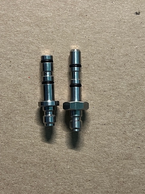

The two are my huma, long is SPA and short is Daystate/Brk. The single is what comes with a notos.

The one you linked looks like it is the same as the one I ordered and just got, Florida Man. It looks a lot like my SPA probes which look like your Notos one. For now I will use the one with 90 O-rings because it goes into the foster a little easier. But now I have two good options and I think the other one I got at the same time as the one with 90 hardness O-rings can be fixed up with the same harder O-rings. So I am good for SPA fill probes. At least 2 good ones and a usable one and another that is probably good. Ultimately I may use the one I just got if the ones that need the hard O-rings start to leak because it is a lot easier to install O-rings with 70 hardness.
I must never have tried the other probe that came with the P35-177 or the P35-22 (I bought them in the same order from Krale). I tested it a few minutes ago and it works great. So my total problem was one bad probe. Wish I'd figured that out earlier. Now I have three good probes and one I could use.
