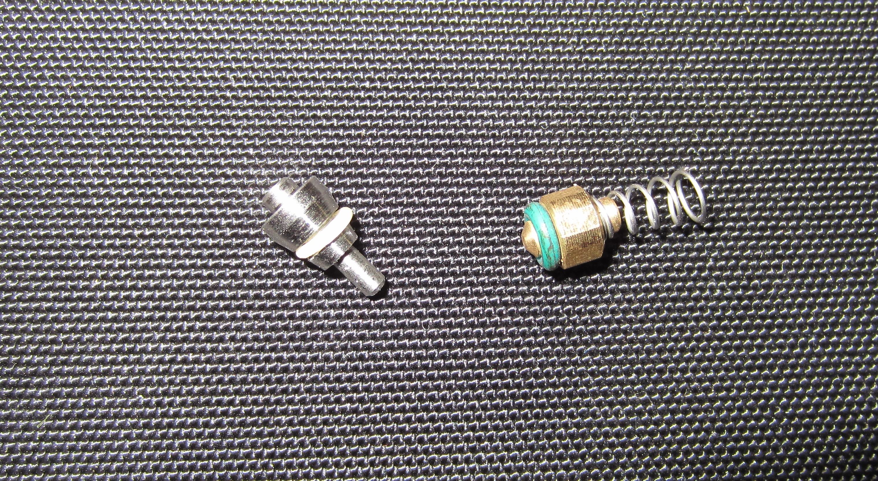

Was having a slow leak out of the fill port valve. Took apart and the inside of the valve has a small piston that allows air in and not out. I determined that a small o ring 1x 2.5 metric was the problem. Nothing available locally, so ordered some from the o ring store. After new o ring installed, problem solved. If you have same issue PM me and I can send you new o ring. When ording on line you end up with lots of extras.
My g30 has a slow leak like that too, how did you pinpoint it? I made soapy water and brushed it on everything I could see but no bubbles. Seems to lose around 100 psi/day
Process of elimination. Replaced a couple of other o rings with no luck. Finally tried the one I didn’t have, and had to order. Solved problem
Reactions: Vortecsix
Emailed Umarx about my leaking fill port. No parts offered...send it in. NOT GOING TO HAPPEN Umarex!!! Spend $10 shipping on a 2 cent o-ring? I have the straight thread white o-ring version. So, found one from an old paintball 4.5k bottle. Not same but works till I find proper rings. I use cheap silicone shock oil to look for leaks. NO soapy water, lol, just me. Captain O-ring has good price for main rifle o-rings which i used to fix the badly engineered "bottle block" o-rings. The SS part on left is original, replaced with brass version until I find the proper rings.
