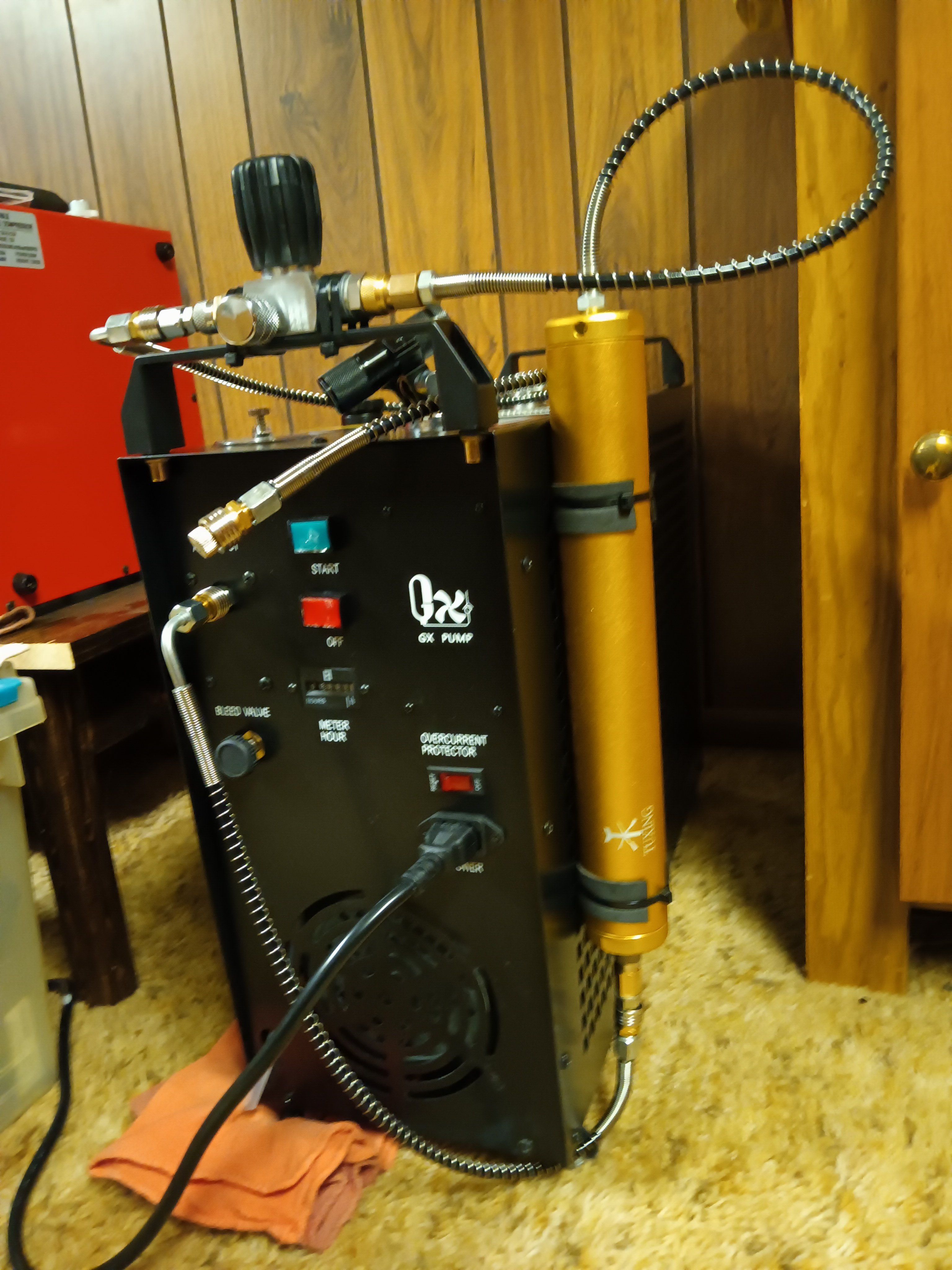

I'll put something up on the form. This thing's literally brand new. They have that big coalescent filter in them I added a molecular sieve. Also added some other one-way valves and on and off with a bleed. That way I can keep the final filter pressurized and still disconnect and connect guns and such to it. And bleed off the air and the first outgoing line so the compressor can start easily.

Just looked at your setup again, and I realized your primary filter may be upside down?
Seems like moisture will build up in that bottom loop before it reaches the filter. You're working against gravity. Maybe I'm wrong? 🤷‍♂️
The line that comes out of the compressor is after the coalescent filter. The gold filter on the side is the molecular sieve. I may have the set up upside down, I really don't know. You can be completely correct. I set it up like I've seen other molecular filters being used. If somebody knows for sure chime in. We would all appreciate it.
I haven't used it very much since I've got it. I do know that when I crack either of the bleeds loose no moisture comes out at all. I've done a couple of guns to 300 bar. Most of the gun top offs have been to 200 bar.

My issue isn't with the order in which they're connected, it's the orientation of the cylinder while vertical.
The lead end from the compressor should be at the highest point, with the fill end at the lowest.
Other way around, air always moves up while moisture settles low. Item to be filled always above everything, make moisture work uphill.
