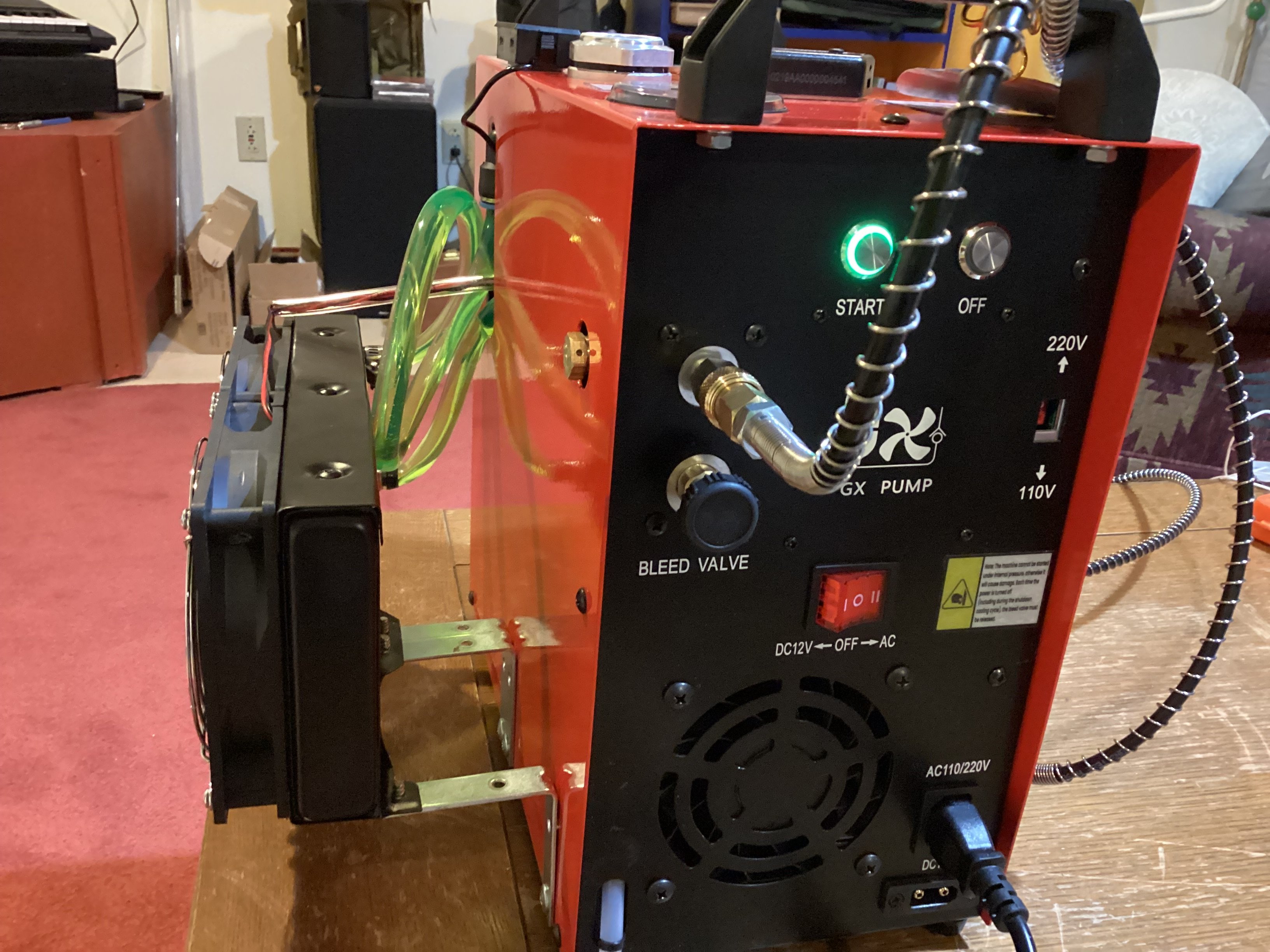

I see your being cautious with your Gx . They run very cool compared to the predominant faster pumps. They can run for hours without a head temperature much over 100f. I know I’m sticking my nose in where not asked.
Here‘s a crazy over engineered take on Gx4 cooling.

Here‘s a crazy over engineered take on Gx4 cooling.View attachment 537355
A little cautious, sure. but not as elaborate as what; is shown in the image <grin> (That's a bit of overkill). I do use this though since it's low phosphate (PH) as recommended.

but then a fellow poster put an exterior radiator on and my mechanic side took over. Coolant is some thing
they use in bigger computers, got on amzon
