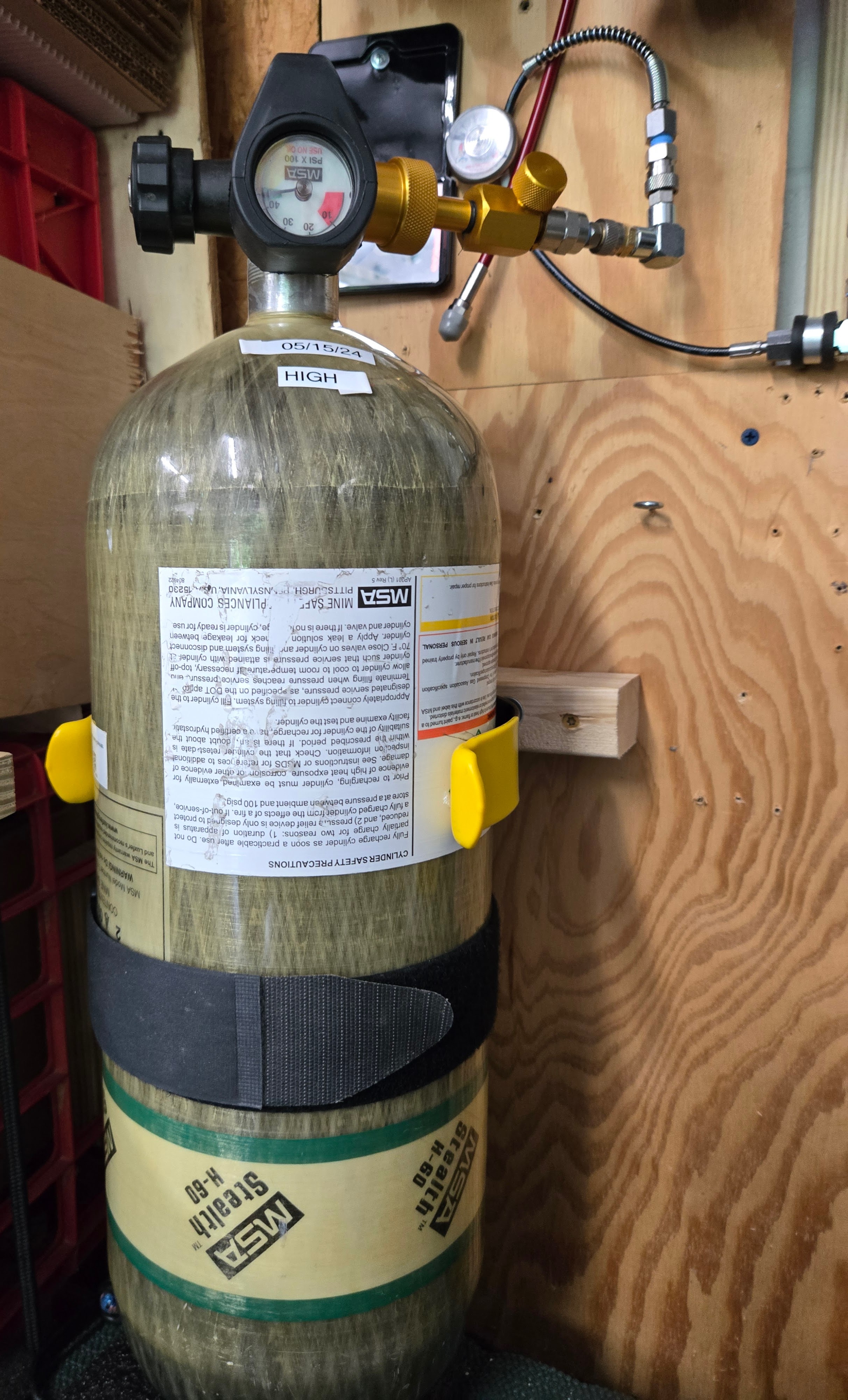

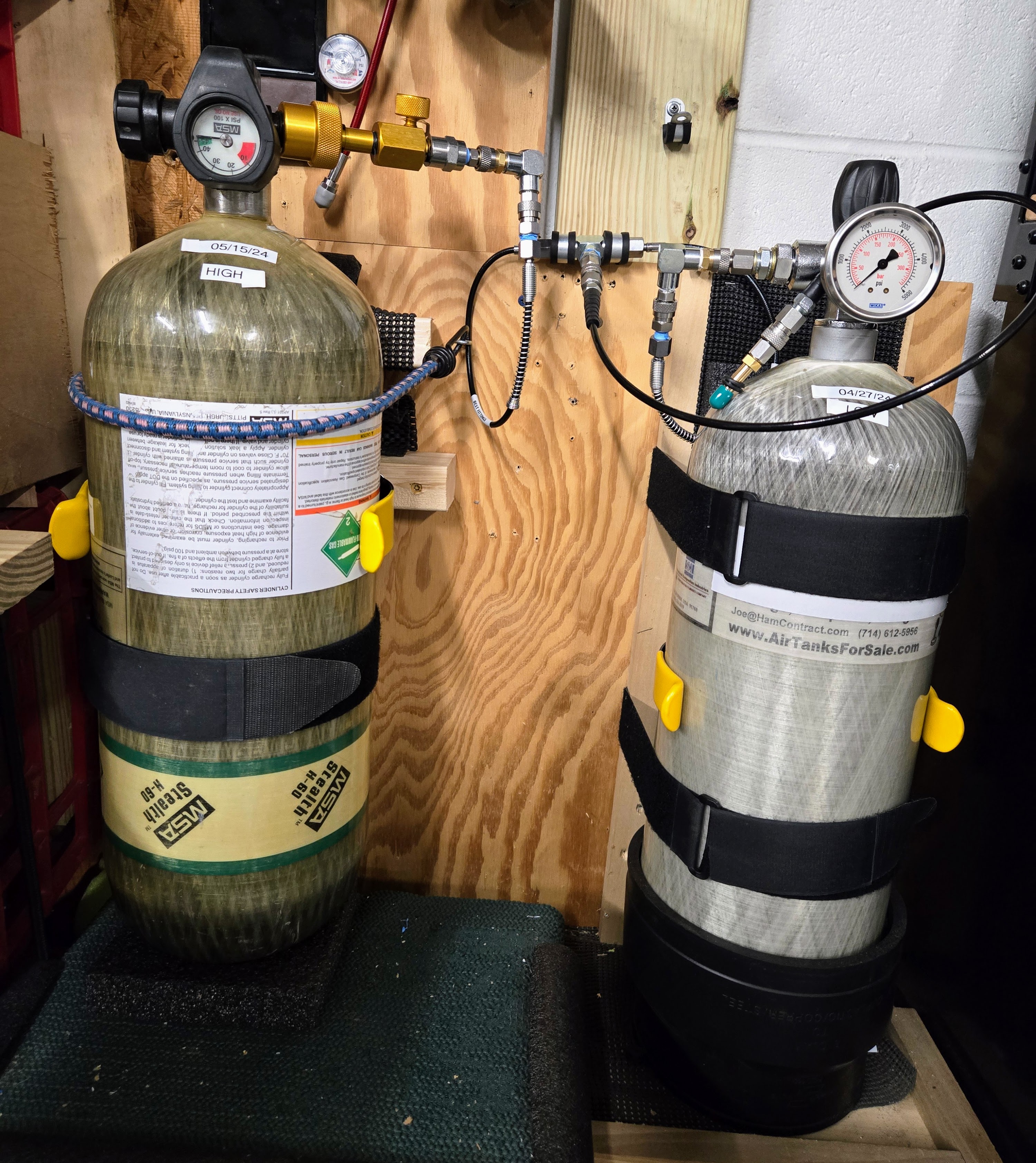

I’m in the process of weighing the pros and cons of using old tanks myself. I have two scba fire tanks decommissioned and in “well used condition“ I may continue using one of them while the second holds air but is more beat up-it will probably get drilled or pressed up and shot from an extended range for the show…
They both hold air, and don’t appear to do anything weird when filling, but it still makes me cringe a little. Then again given their safety margins I may be fretting about nothing.
Knowing that in many markets they are allowed a 30 year service life makes me feel a little better though.
For me it was a cost saving measure, sure I want a “great white” tank with all the bells and whistles with the regulator tether so I can hook it up and shoot all day, but this gets me the quick fills til the budget allows “the thing“.
