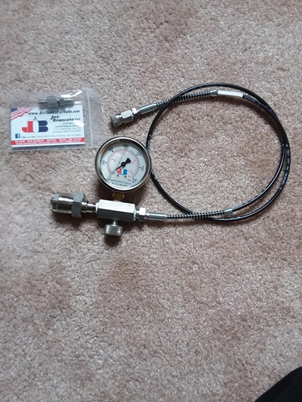

This is exactly what you need for a 4500 psi nitrogen tank and this was supplied to me by Joe Brancato.
Yep, talk to Joe and he'll set you up. You can get a regulated valve (approx $479) or an unregulated valve (approx. $189) I've got the unregulated one and have zero problems filling my 97 cu ft tank from the 6000psi nitrogen tank. If filling a rifle straight from a 6000psi nitrogen tank, it would be a good idea to have the regulated valve.
