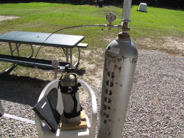

I've been using Nitrogen since July 2014 and love it. Beats upkeep and maintenance on a compressor any day for me. I guess I just prefer it for the simplicity factor alone?
I know I could have bought a nice compressor for the money spent on Nitrogen over the last 4.5 yrs, but I just like the fact I can turn the valve on the rental tank and voila instant air with no worries that my compressor is gonna over heat and blow a seal, or a myriad of things that can go wrong?
Plus it's dry and I don't have to worry about moisture entering my guns.
When I first started renting the tank in 2014 it was around $100 a year for tank rental and just under $150 for a fill. Which will last me about 8 months with all the plinking and target shooting I like to do.
Now it's around $120 yr tank rental and I believe the last fill was closer to $165. So, what's that.....about $368 dollars a year for Nitrogen? Say $1.00 a day.
I use my nitrogen bottle to keep my SCBA tanks filled. When my nitrogen bottle gets down to 3000 psi , I fill my guns directly from the nitrogen tank for a while before I call Arc3 gases for a change out. Yup, don't even have to leave the house. Call them today and they will bring me a fresh bottle and change out the old one by next Tuesday.
Now if I didn't have access to Nitrogen, I would buy a compressor. Why?....because compressor maintenance and upkeep is much less of a headache than driving into town to get my tanks filled

My yearly tank lease was $120.75 back in July last year. That's $110 for the tank and an added $10.75 Hazmat fee?
Got the last bottle changed out April 2018 . Cost me $167.08
Beak down $144.45 for the fresh 6000 psi fill, $4.75 Cylinder Drayage, $6.95 fuel surcharge delivery, $7.42 state tax, $3.51 county tax = $167.08 total
The bottle before that I had shot down to about 2600-2700 psi before I called for the change out. So yes, I lost that amount of the fill.
The bottle from last April has about 3200 psi left in it. I'm just into my 9th month. So I'll start filling my guns straight from the bottle shortly.
I mostly shoot .177 and .22 and most of my guns are very efficient with air use and give me high shot counts. Now if I were shooting big bore air rifles it would be a different story.
I could buy a booster pump and get more use out of the left over 2700 psi of pressure? I would probably do that if I shot big bore mostly?

Yup , I use the 30 and 45 minute SCBA bottles the Firemen use. I've got three of them and a Joe B Guppy.
They have a 15 yr shelf life and need a hydro check every 5 yrs.
I think they have a process where you can send your old tank off and have it re-certified for another 15 yrs if it passes?

When my 6k nitro tank gets too low to fill things, I use it as feed a Yong Heng. So I run the YH as a booster pump, but with only 5-10 psi inlet pressure of nitrogen. I wouldn't give it much more than that - but even just 5 psi cuts the fill time down by more than 50% and 10 psi cuts the fill time in half. When you feed your leftover nitro into the YH, you don't have to worry about moisture (still need the oil filter tho). Just a thought for using the rest of your N2.
