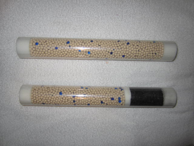

I used to make desiccant cartridges for the gold filters before manufacturers started selling them with repackable cartridges. Here is a photo of some I made to replace the cotton tampon filters. I prefer the larger 4X8 bead size but 13X zeolite also is sold in smaller 8x12 size beads for packing into smaller cartridges. It is advisable to mix in a few blue silica beads with the zeolite to use as moisture indicators. When they turn pink it's time to recharge or replace the desiccant.
