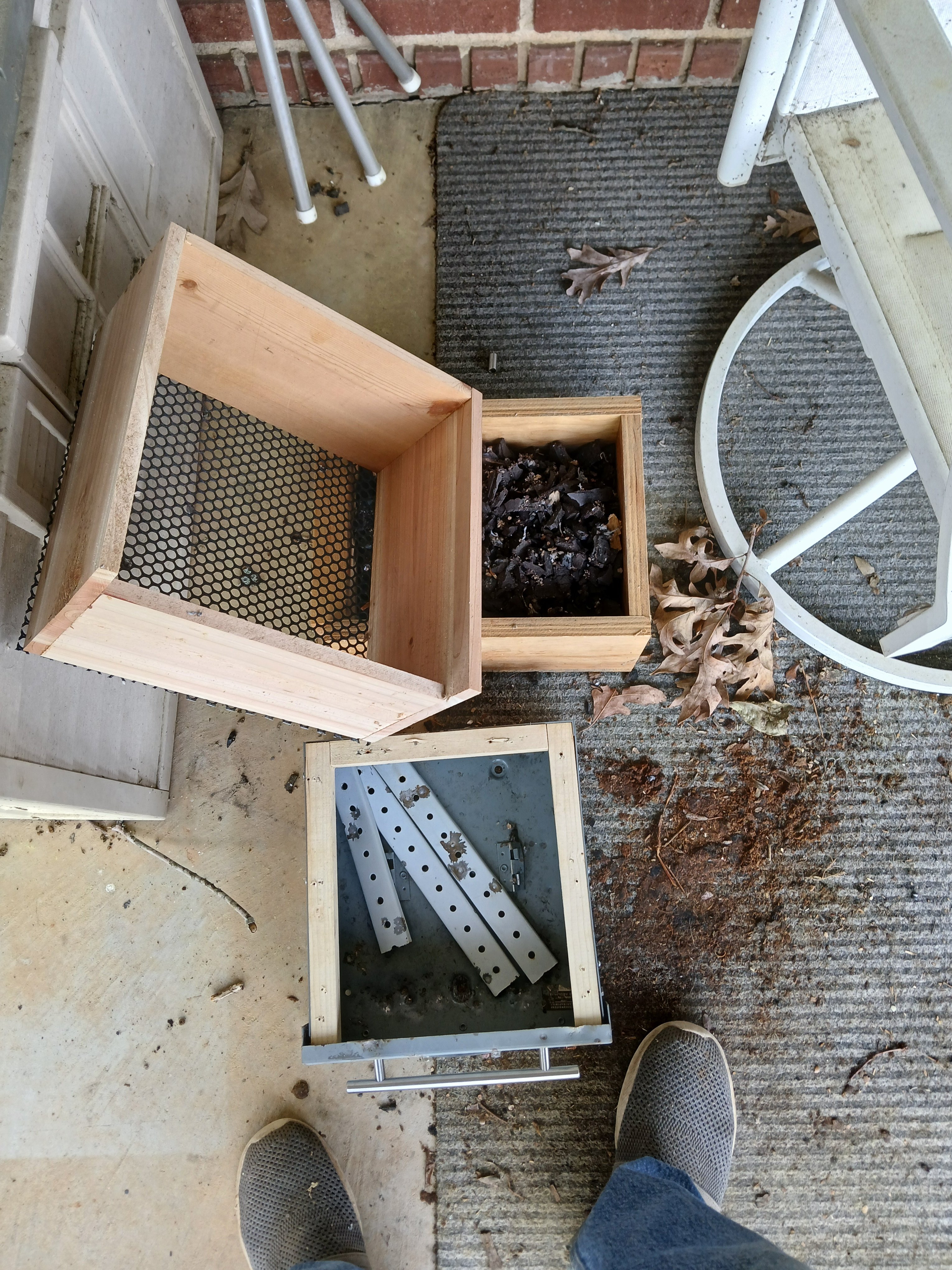

Ever since I started making pellet traps filled with rubber mulch I've been wanting a good quick way to separate the mulch from the pellets. I made an improvement today using plastic fencing that has 8mm openings. It's about the right size to let pellets through without letting significant sized mulch pieces through. I made a 12x12 inch frame and stapled the wire to that. I then put it over a drywall bucket and poured some mulch in. It works well but I may staple some cardboard in the corners, the mesh is a bit big for the bucket. But the other issue is all the little debris comes through with the pellets. I just dumped the mess in an old saucepan and tried burning the debris off as the lead melted. That works but is smelly and takes awhile. Next time I will pit some water on the pellets and see if I can't reduce the amount of debris. But the filtering through the mesh works well and greatly decreases the volume. The picture has the filter, the trap, and a box of the filtered mulch.

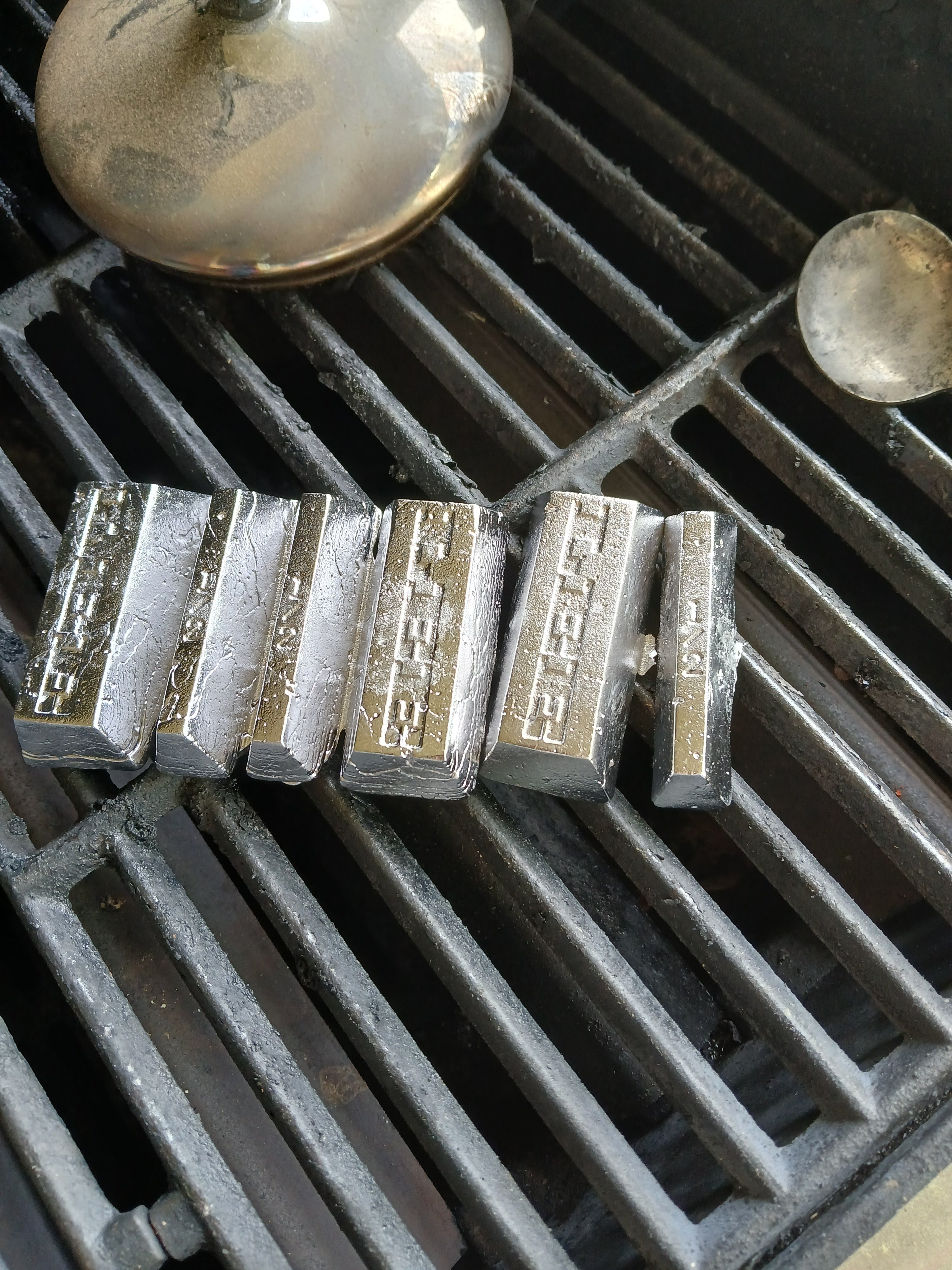

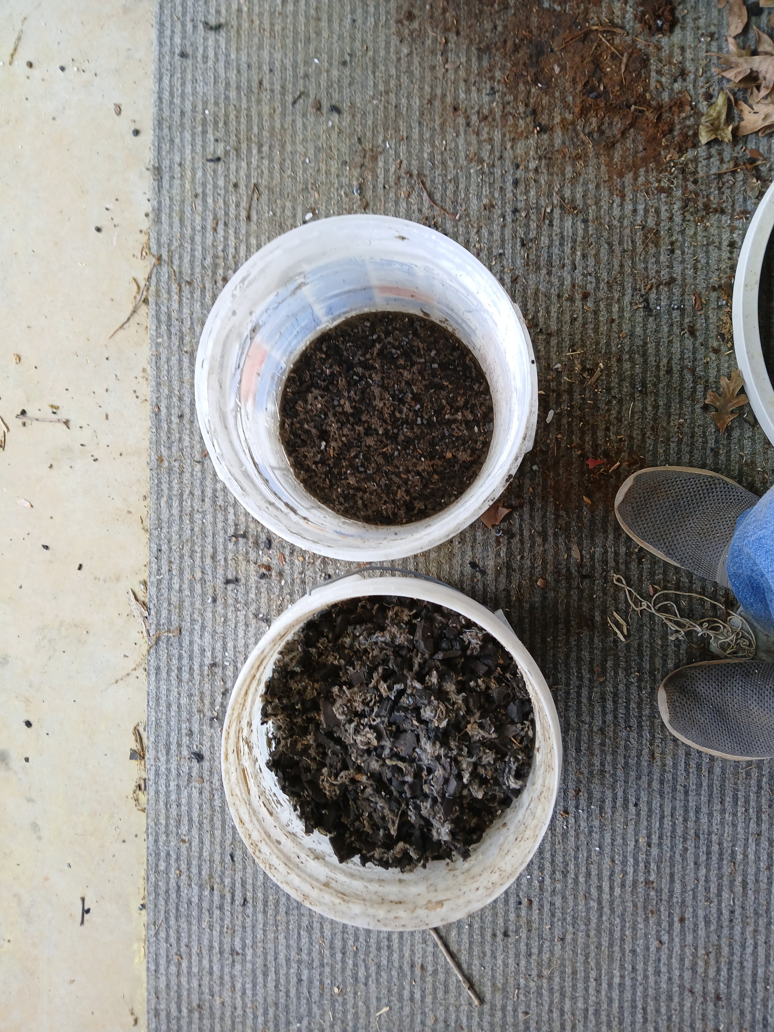

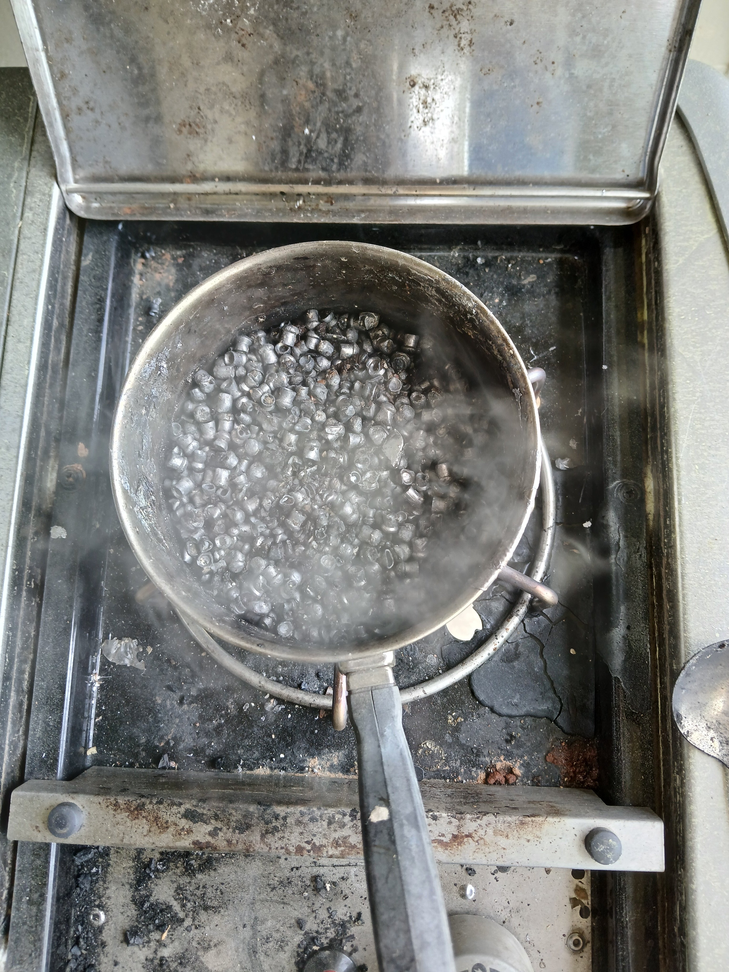

I did another trap today and improved the screen with cardboard in the corners and I filled the bucket with the pellets with several inches of water. It worked pretty well. In about half an hour I had the pellets on the side burner in a pan to melt them. The mulch did not float but other debris did. I poured the water off and that took a lot of the mulch with it. Doing it slowly let the pellets stay behind. I still had mulch in the pellets but much much less. I removed it with a spoon from the molten lead the way dross is normally removed. I got about 4.5 lbs lead out. That is less than I typically get but this trap is built of 3/4 plywood and deeper so it weighs 21 lbs without pellets. I might refine the process further but it is working well.
The pictures are of the separated mulch and pellets, the pellets on the burner and the lead ingots.

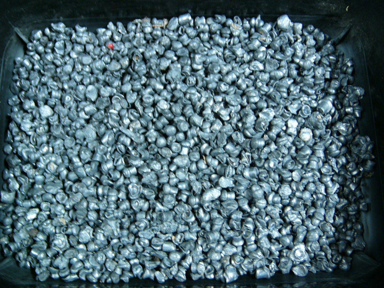

@JimD I like your screen idea, and may try it myself. I've just been dumping the whole mess from the target box into a large storage bin (the big black ones from Costco) and shaking it to get the lead to the bottom and the lighter stuff on top. I then hit it with a blast of air from a leaf blower (the battery ones make this easier, as I work my way down in layers, and of course do it outside) and this gets all the cardboard an paper bits to blow away. Then I scoop out the good clean mulch and put it back in the target box.
I simply repeat this a few times working down in layers until I get to the last layer of mostly pellets but also some small rubber mulch bits mixed in. After a good blast of air, I pour the contents into a five gallon pail and then switch to the shop vac to get out the rubber mulch leaving the pellets behind. I have found that what works best is to use an extension tube on the end of the shop vac hose, but to hold it in place a with a small gap to leave a leak path to reduce the suction some at the working end of the tube, and then I can put the tube right on top of the pellet and mulch mix and the pellets end up being too heavy to rise up but the mulch does go up and is removed. Someday I may make a "tool" out of PVC pipe with a hole in it, but the gap method works great. I typically have to shake the mix around a bit and do it a few times, but the result is a collection of really clean used pellets.
I've been keeping my lead with the thought of melting it down and casting it some day, but have not yet as I pretty much just shoot .22 and don't see much point. I'll probably end up selling it for scrap or giving it away some day. The stuff from the rubber mulch trap is clean but the stuff from earlier in the duct seal trap is messier.
Anyways, you could do a mix of things and do what you do now, but add a blast of air and then the vacuum to the results of the sort to clean it up a bit more before melting. Here is what my results of the method above typically look like:

I may sell or give the lead to a recycler eventually but I melt it down into bars using the side burner of my bbq grill on the back porch and an old pot I ruined years ago. I have a Lee ingot mold. I fish too, however, and keep thinking I should get a mold for fishing weights. So for now I am hanging onto it. I did melt some down for a block of lead for the front of my P35s (I've made two) to allow them to better fit into my "Rock BR" bench rest and to help stabilize the guns from the weight. I made a crude mold from scraps of steel and aluminum I had on hand. I also might use some to make an anchor for my smaller boat.
