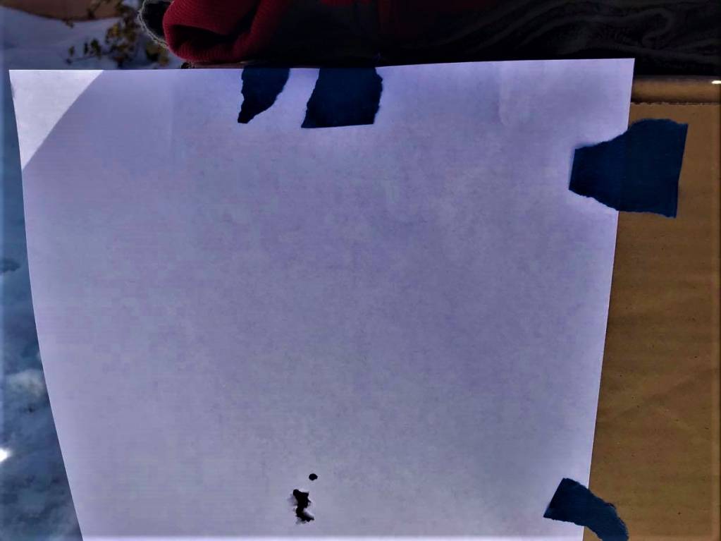

This is 8 shots at 25 yards:
I have advanced the hammer striker to 3 full turns but the hammer spring has no preload.
The transfer port is the silver one (medium); red having the smallest hole.
The pellet path is like an arc at 25 yards 😁

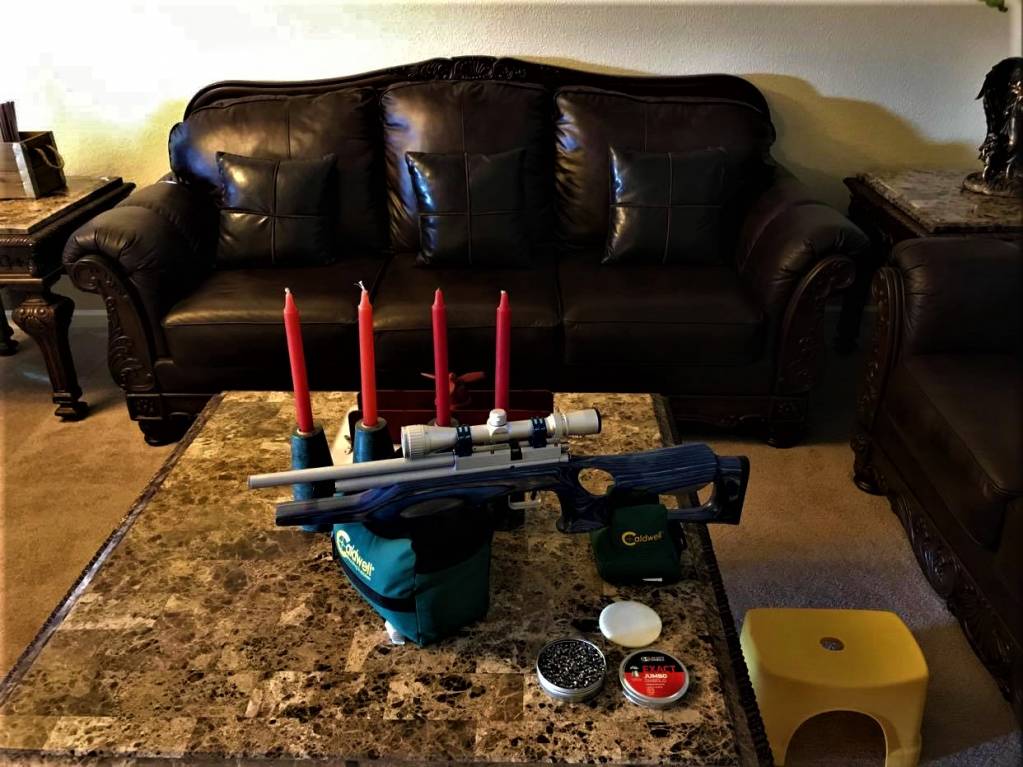

My man I'm liking that stock! Who made it?

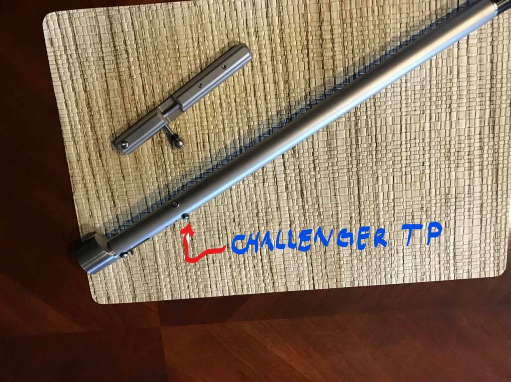

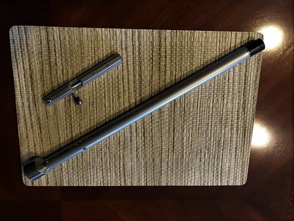

I assembled my stainless Don Cothran 2260 PCP right away to test it against the PROD.
The barrel is a 14" LW in .177.
No hammer spring preload.
Hammer spring is a Magnum Air Power .038" WD as well as the stainless valve torx screws (very tight fit on the DC tube I had to polish and grease them).
Transfer port is a that of a Challenger, so the hole is very small.

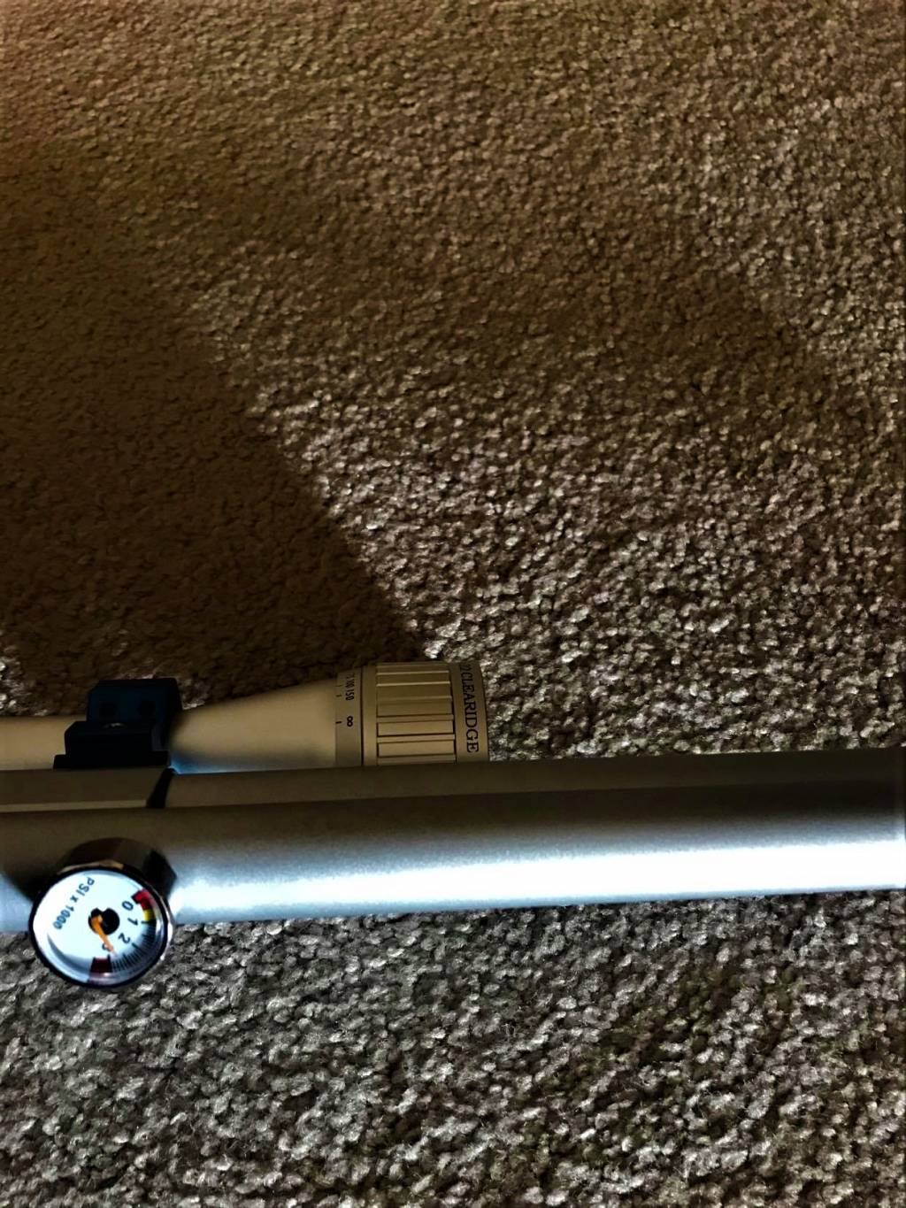

Starting pressure (tube has no gauge) was 2k PSI based on the hand pump's reading:

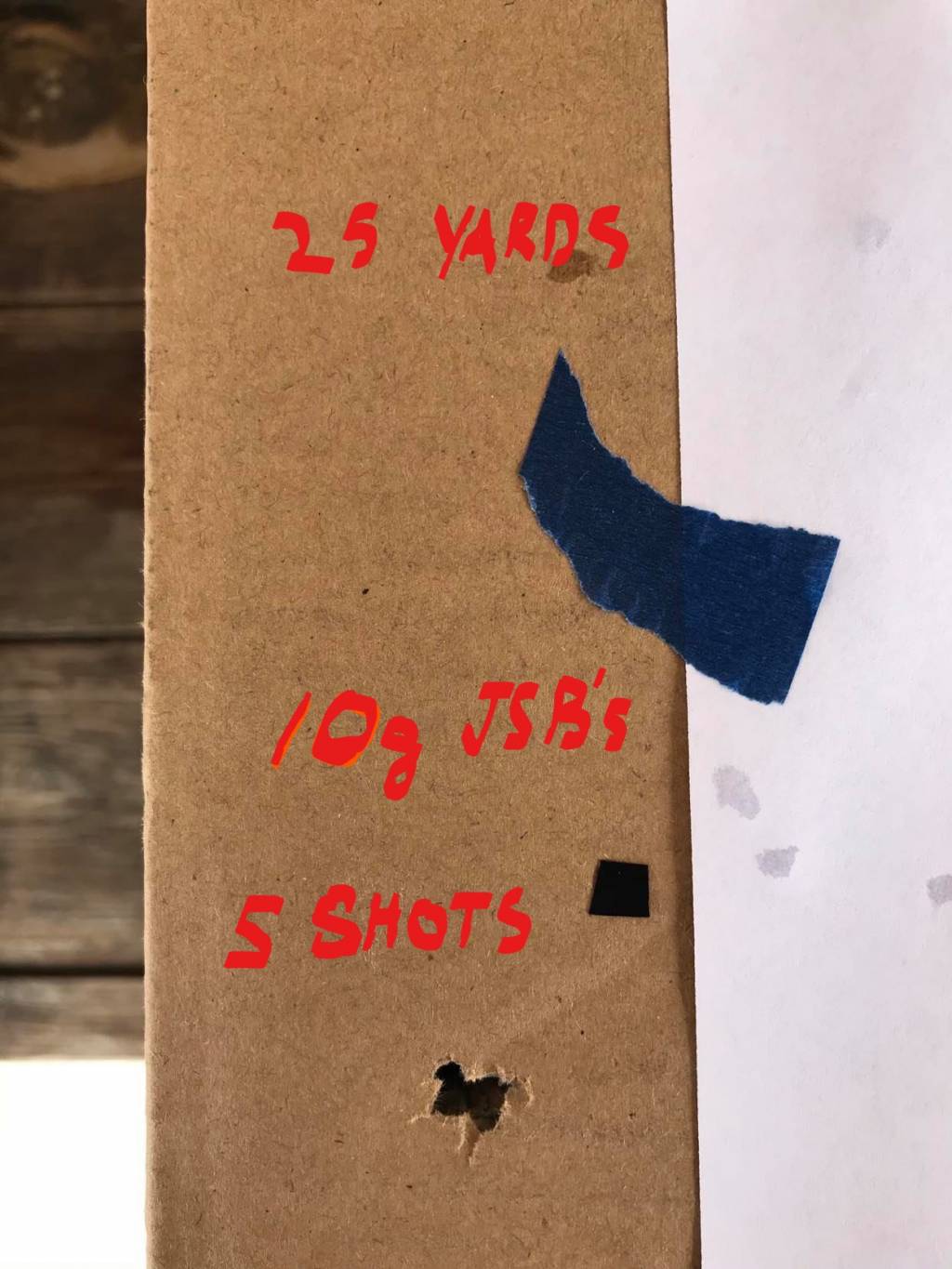

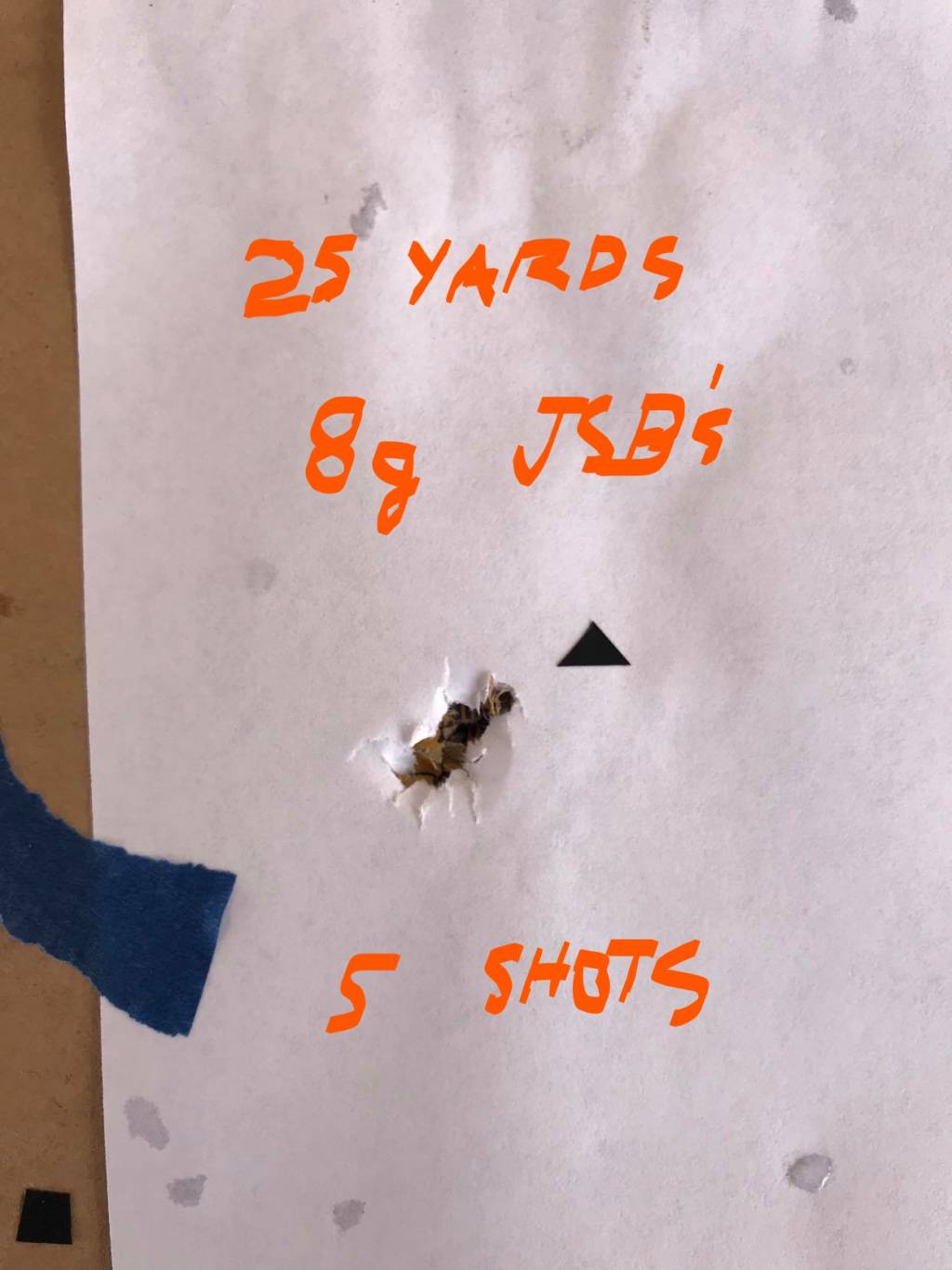

In reality, this is really 8 shots; 3 shots are strays from 10.34g JSB's, which made the hole a bit bigger:
I did over 20 shots including my sight in ones and did not notice any drop in the POI.
I built the stainless DC 2260 to emulate the 1720T/1701P, or even the Challenger and it seems to do just that.

There is no doubt in my mind the 2260 will beat the PROD in accuracy, as it was already showing signs of dominance when I pitted them against each other.
It is a Boyds Barracuda stock for the Disco.
The trigger assembly is a Magnum Air Power, so it is aluminum with stainless and steel innards---it is crisper than my KIDD single stage 10/22 trigger.
I did change the PROD tube to that of a 1701P's that is why it looks shorter.
The 1701P and Disco share the same gauge location, hence my decision to replace the PROD tube.
The PROD/1720T has its gauge farther from the trigger frame, you know.
Lastly, I had it Cerakoted in silver.

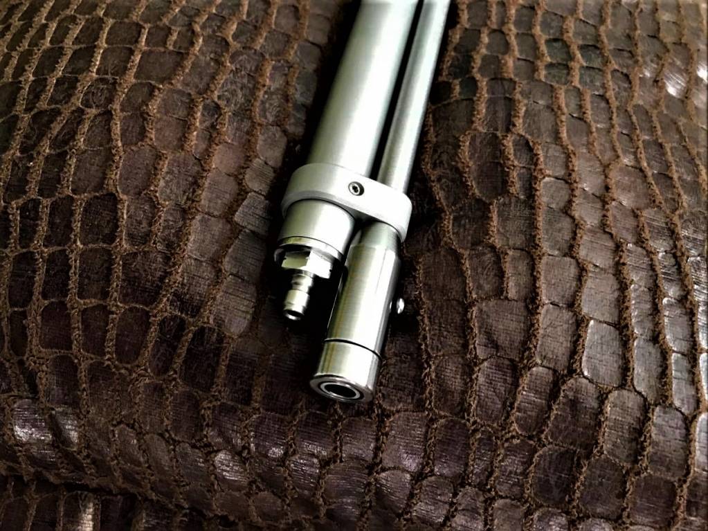

Excellent fit (very tight!) and finish (no wobble but it is a heavy and solid steel piece), so you may need to sand the ID your tube, as they differ circumferentially--don't ever sand the adapter, no sir 😁
I have 2 of his AR adapters (offset and non offset) and the one on top is a hybrid to fit the 22xx and PROD/17xx breech/tube, so there are two 8-32 up and down and two 4-40 threaded holes.
It has a built in spring adjuster.
