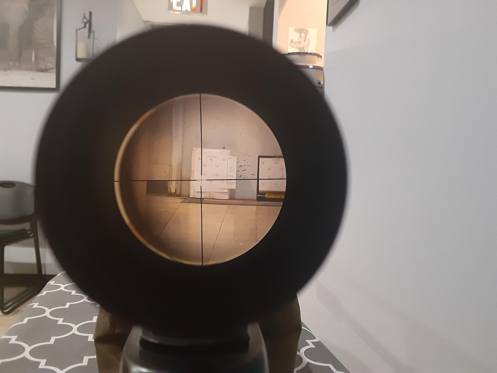

It held up to near 6,000 rounds, but broke tonight shooting at my indoor 25 yard range (notice the bottom upright connection)
I know they'll cover it, but I've been considering upgrading to one with parallax. I shoot mostly under 40 yards, so probably don't need to overdo magnification. Have medium sized mounts and would like to still utilize them. Money is not much of a concern, sooooo suggestions?

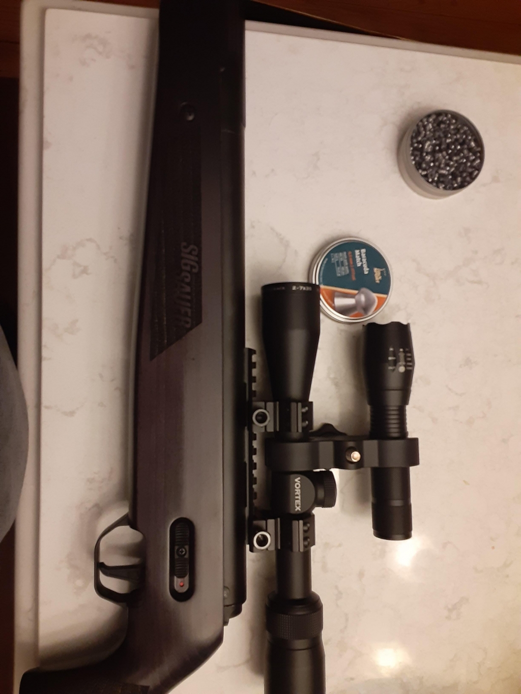

That's my plan. I know they'll replace it, but I want parallax now. The scope is the diamondback mounted on my asp20. I was using the asp20 and Diana 48 to do the ten dimes challange indoors.

How did the crosshair break? I've been shooting guns with a scope over 15 years and the only time it happens is when I took the scope apart to expose the crosshair and I was curious how tough it is so I poke it up with my fingers and bent it then try to use a toothpick to bend it back and break it lol. Unless you poke it or drop it from 100 ft I dont see how just shooting it normally would damage the crosshair.
Never dropped, opened, or mistreated. Just sat atop that gun and just shot it normally over 6,000 times. It broke on the 5th shot at the target you see I'm aiming at. Just simply broke while shooting. The scope has NEVER been opened, or dropped. Just shot under. Never even taken off once mounted.
Literally broke just shooting it normally.
I had Hawke Airmax 4-12 40 ao and after about 1000 shoots stoped holding zero on hw 97 kt. It was replaced on warranty. I have several different Hawke scopes and I think they are good for the price but I would not mount one on the springer again.

The broken crosshairs can be a problem with any scope with wire crosshairs. There are many brands that have glass etched crosshairs which won’t break.
This is the most prudent advise, switching to an etched reticle scope. And be sure to get one rated for the Springer's scope killing recoil.
Yup. I thought the vortex diamondback was etched reticle. Found out the otherbday it was not!!
