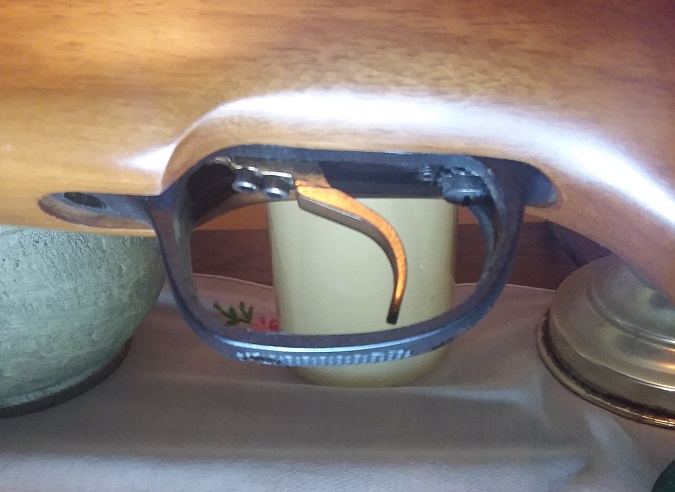

Finally I got the Webley Tomahawk.
"Sorta" looks like a cross between the UK trigger and a Quattro so maybe Hatsan's first try at cloning that AGR mentioned ?? I know they were making airguns before Webley's new owners came along, made whatever deal they did to build guns for them and about when Hatsan started copying the Webleys with enough changes to skirt the copyright laws and make their own gun lines

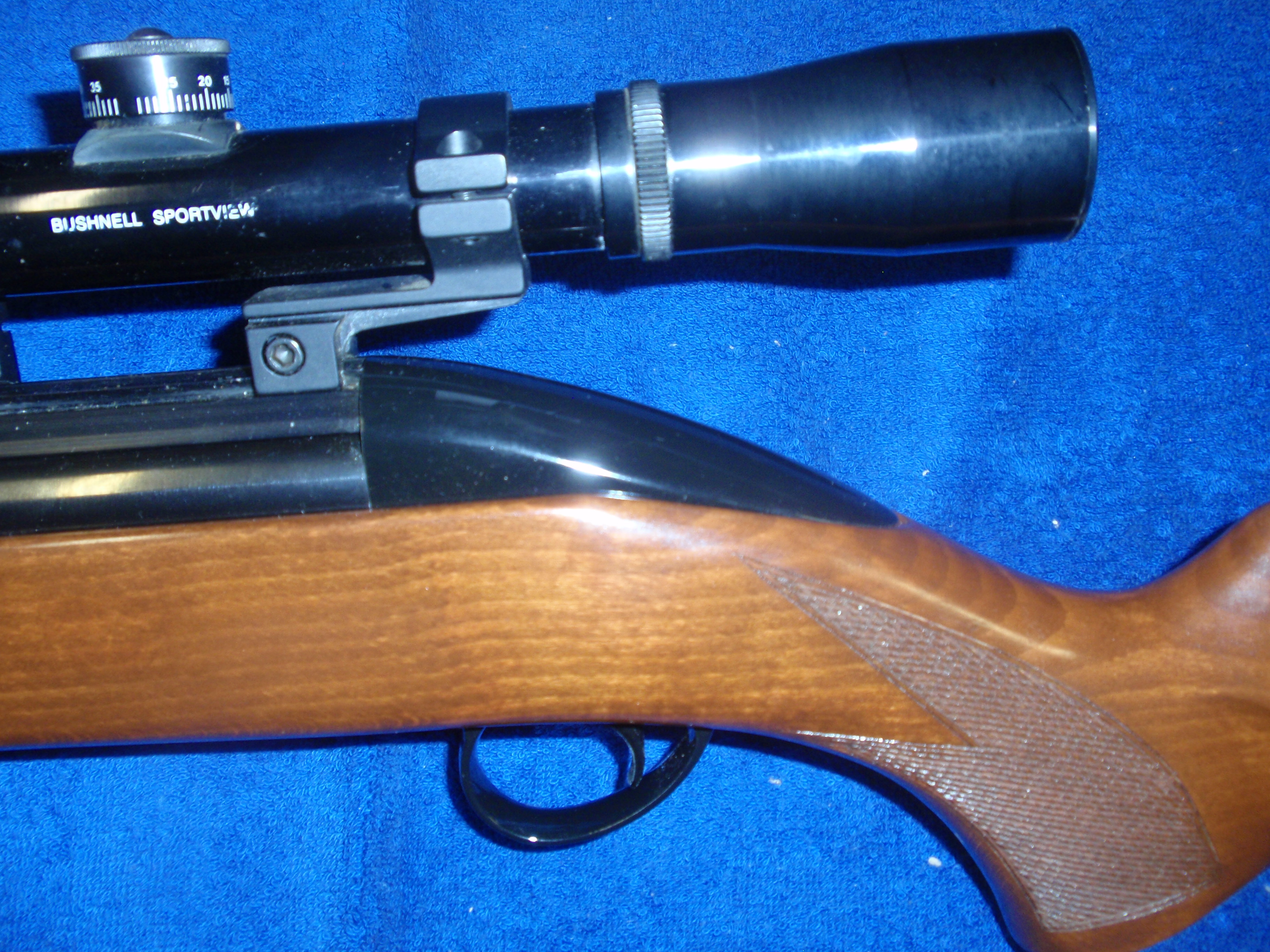

Don't "sand it down". Use stripper and then go over it with 220. Wire brush the checkers. Chased them out very carefully with a curved needle file. I stained one of mine before finish coats. Don't sand too smooth before stain. That's wrong. Use Minwax Antique oil. See some videos. Webley walnut can be beautiful. I wouldn't "plastic coat" it with tru oil. First picture is how I got it. Top rifle (a .25 cal 23 ft lb) is stained with Minwax red oak. Washed it down with mineral spirits then because it was a little too dark. Bottom pic is my other Tommy .22. Good luck!View attachment 288390

The wire brush works fine if you're not a butcher with it. A small stainless brush. Follow the lines. Then I chase out the checks to get the brand new look. Cleans the grooves out like new wood. Doesn't take me long. It's not that hard but you need to concentrate. These were wire brushed too but the resolution isn't great.

The wire brush works fine if you're not a butcher with it. A small stainless brush. Follow the lines. Then I chase out the checks to get the brand new look. Cleans the grooves out like new wood. Doesn't take me long. It's not that hard but you need to concentrate. These were wire brushed too but the resolution isn't great. View attachment 288911
I am certain you did it gingerly and perfect. It shows. There are “very fine” wire brushes out there but hard to find when needed. I just worry about a course wire brush and a newbie. Trying to avoid a disaster. Sharp checkering is very easy to destroy. Especially “hand cut” checkering. Nice job.
Well, well - the 15 year old lady came out well, and is looking brand new now. I made a Wildcat stock from Turkish walnut some time back, and have to say that the wood structure looks very similar. So I take it for granted that this tomahawk is a Turkish product. But it shoots well, and for me that is most important in the end.
Might have been assembled in turkey by the serial number but looks to be all Webley parts! That definitely isn't a Quarto trigger! Nice find and great work on the wood!
+1 since I really was hoping when he showed it all together, it didn't have some form of Quattro trigger. Very nice job on the stock and getting hands on the rifle. Definitely not easy to find.

It’s a transition gun. Early on they made some with the Uk trigger design. They were hit or miss as sears and such were not always Uk made. Some were actually Uk trigger units as time went on they were running out and that tooling was probably not Webley owned.. The Quattro trigger was then implemented.

Random guess would be yes an early stage of what ended up as the Hatsan Quattro. Gunner's rifle was built in 07 07. I have 4 Turkish built Tommies all with build dates of 03 12 from when AoA was dumping the stock they had left for $100 each, so somewhere in the 5 years between his and mine, Hatsan got what they decided on as the final version settled on and all 4 of mine have them. Pics of one of my 4 and the trigger are below.
