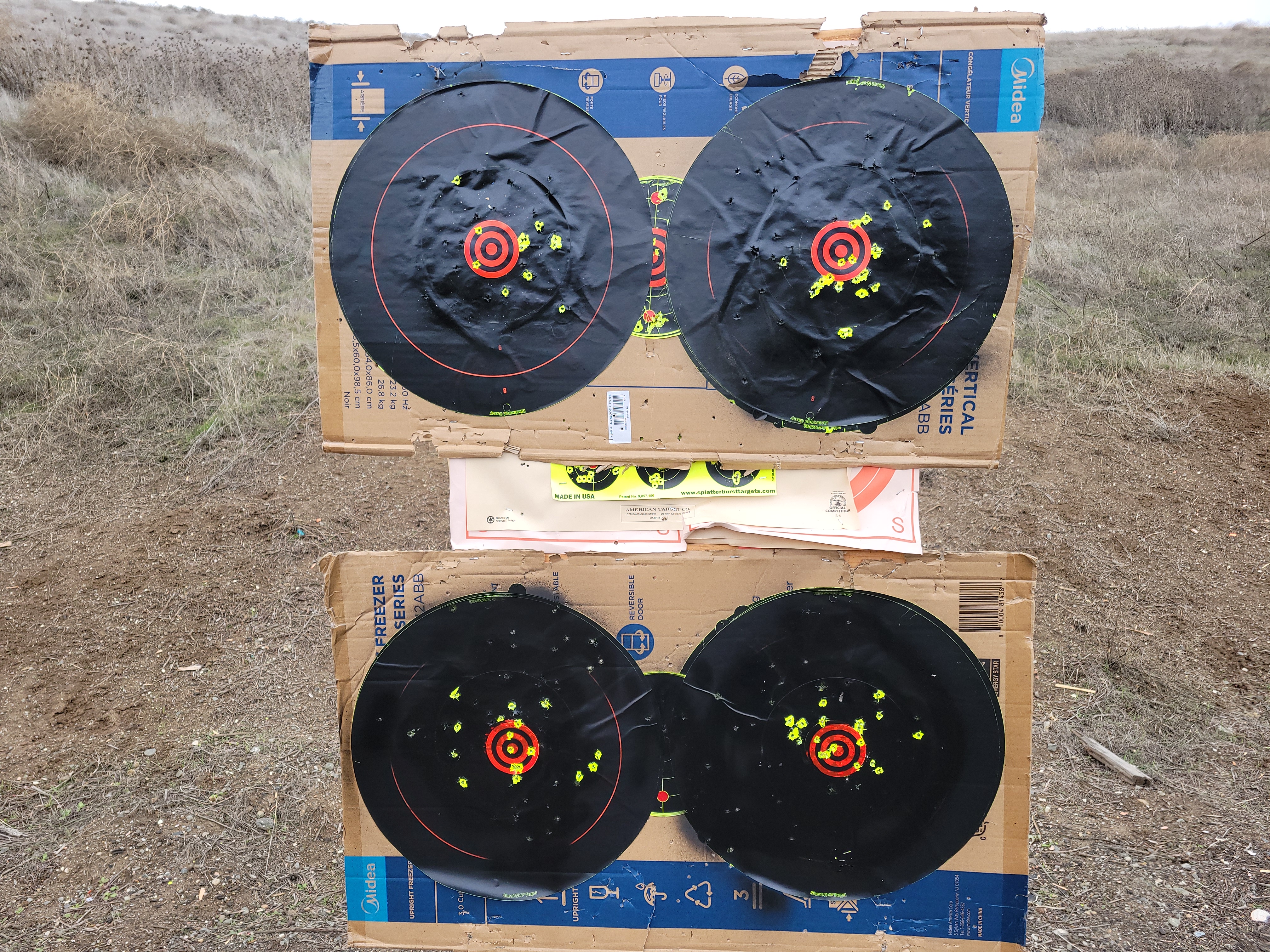

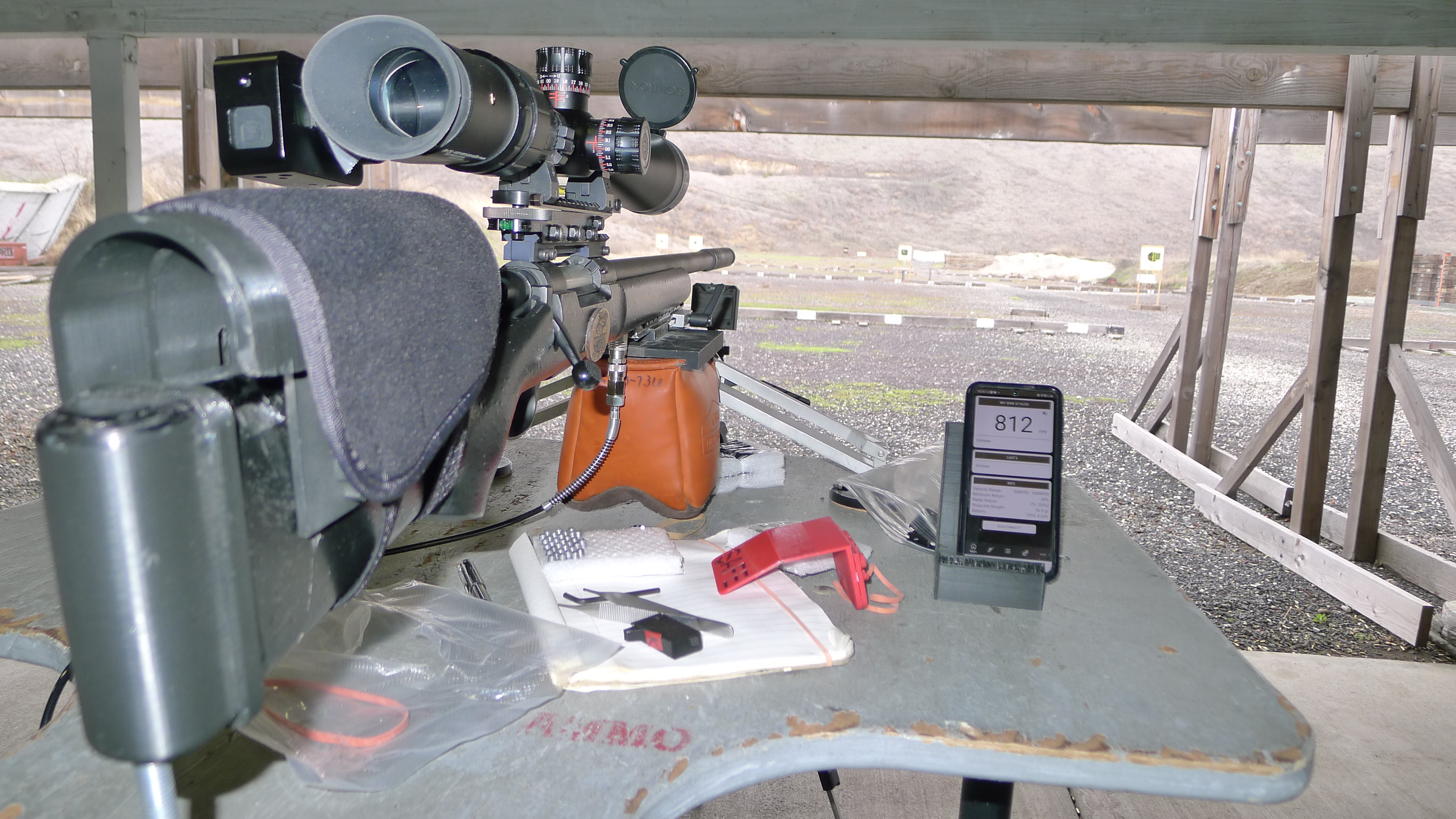

- once tune it can be extremely consistent I had 10 shot ES of 7 and 5 consecutive shots that were same exact speed
- very accurate, easy sub MOA, we were hitting soda can sized targets at 330 yards and 10 inch disk at 400 yards

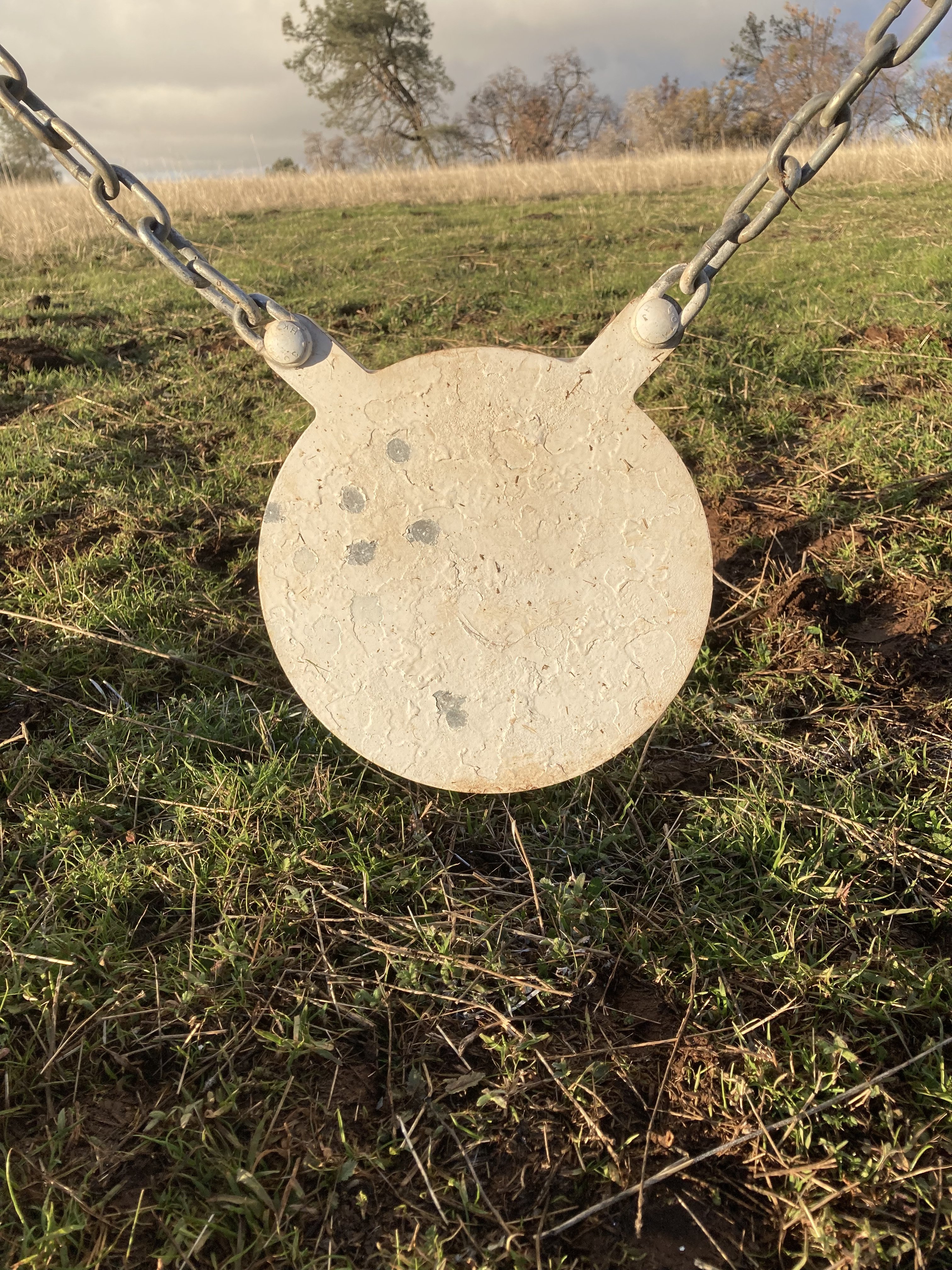

This is the 10 inch disk at 400 yards. Missed a few times too but the fact we can hit it with relative ease as long as wind does switch is impressive. Those Altaros slugs are amazing.
