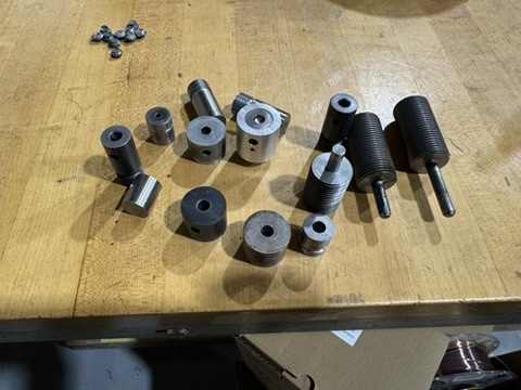

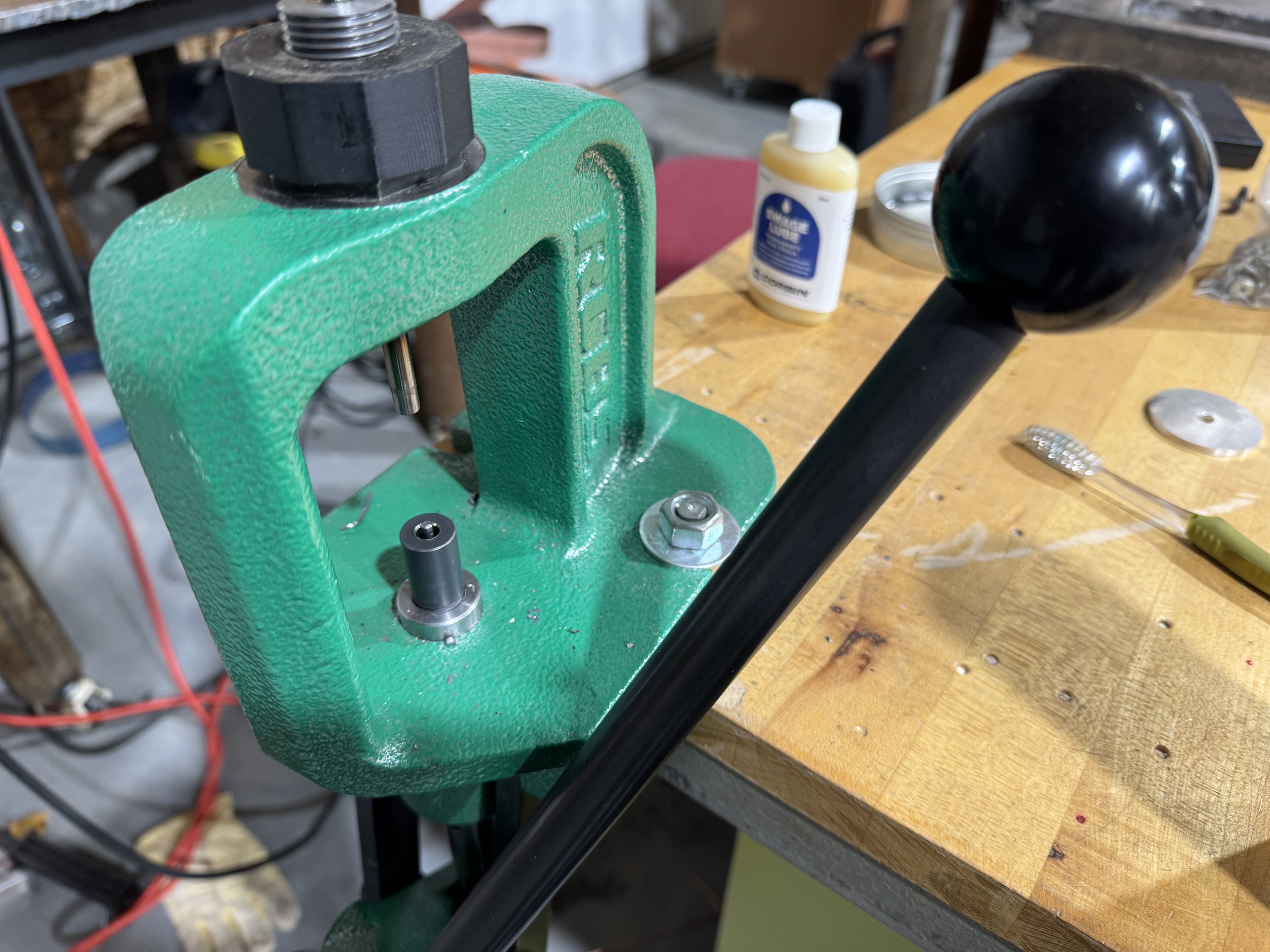

Finally made a swaging die that doesn't stink...very much

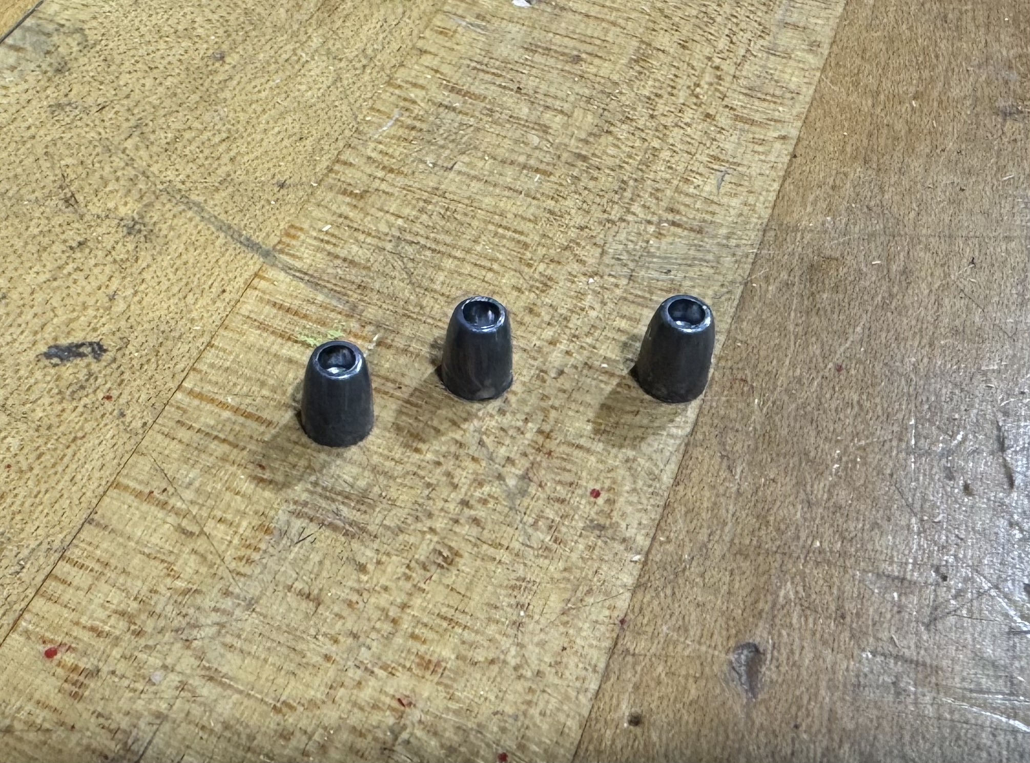

Turns out die making is hard! who would have thought. I think I finally have a die that makes half decent slugs. Definitely not going to give any of the really slugs out there a run for their money but a big win for me. I can get about a 1.5" group at 50yrds with my airarms Krait. Baby steps.
Couple of my takeaways:
  • The diameter of the slug mattered more than the profile or general shape
  • Deeper hollow points tended to do better
  • Taking the time to harden the dies properly was well worth the time as it made them much easier to polish. (will likely help with longevity as well)
  • The overflow extrusion hole should be no bigger than 3/32 to create enough pressure to fully fill out your die.
  • Making a slug that shoots well for everyone is probably not possible. Barrel bore, and the tune need to be factored in when designing a die/slug.
  • If you use swaging lube its worth the time to washing your slugs after.
I'm not experienced enough to state any of the above with confidence but they tend to be true with my limited experience.
These are all the dies that I made before I got one that makes half decent slugs :cautious:
