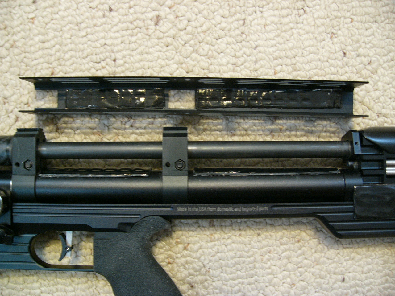

I've been struggling with a decision on my Sidewinder for some time, and it has to do with quieting down the action. I had been thinking that if I put some mastic over the sides of the action it might help quiet down the gun some, or at least improve the sound quality of the gun when shot. But I knew it would not look good, so I had not tried it until today. It turns out it works great, and both quiets the action AND improves the sound quality!
I find the gun to be a great shooter, but the action is so loud and jarring (in terms of sound quality) that it really is not pleasant to shoot without adding hearing protection. I found that I was just not shooting it much anymore, so I decided that I should either go ahead and try the mastic or just sell it to somebody that would shoot it more. I also have a .22 Huben K1, and it has been so much more pleasant to shoot - to the point that it was getting all the use and none was going to the Sidewinder. This despite the fact that I had tamed the muzzle sounds a lot with a Huma 40 moderator on it - but the action noise remained, and it was very loud and unpleasant to shoot (at least to my ears).
So I put some on both sides of the action, cutting it to not cover anything functional, and tried it out. The results are fantastic! It now is in the situation where the impact of the pellet is far louder than the gun, and it was nowhere close to that before. In fact, the impact sound to the shooter was barely louder than the ringing and vibrations coming from the action before.
Sadly, I have to admit that the result is that the gun looks like it was hit with an "ugly stick," but the acoustic results are too good to pass up. For me, the choice is one of having a nice looking gun that I don't really want to shoot, or a gun I can enjoy shooting even if it looks no where near as nice . . . I gotta go with "form following function" in this case.
Here is what the action looks like now - it looks ugly, but sounds great:
