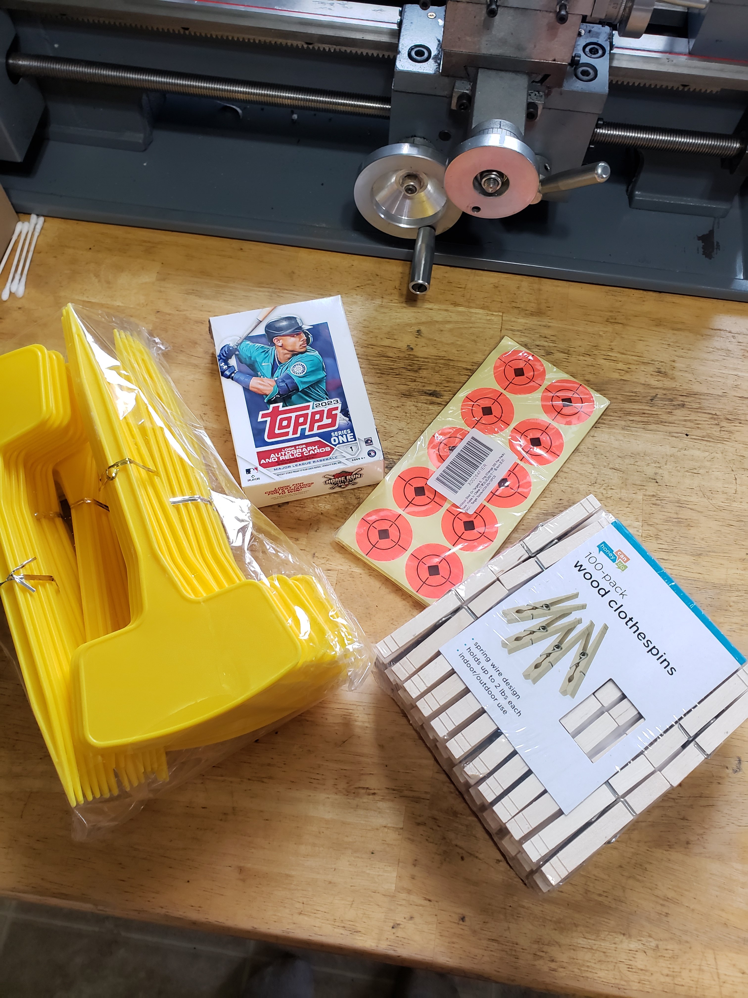

I got to setup my X50 for the upcoming season finally. Mid 50s, light breeze, and not a cloud to be scene. I modified/stole an idea from @oaks1450 for my target/ranging practice this year. I took these supplies:
....and made ranging and target carts out of them like this:

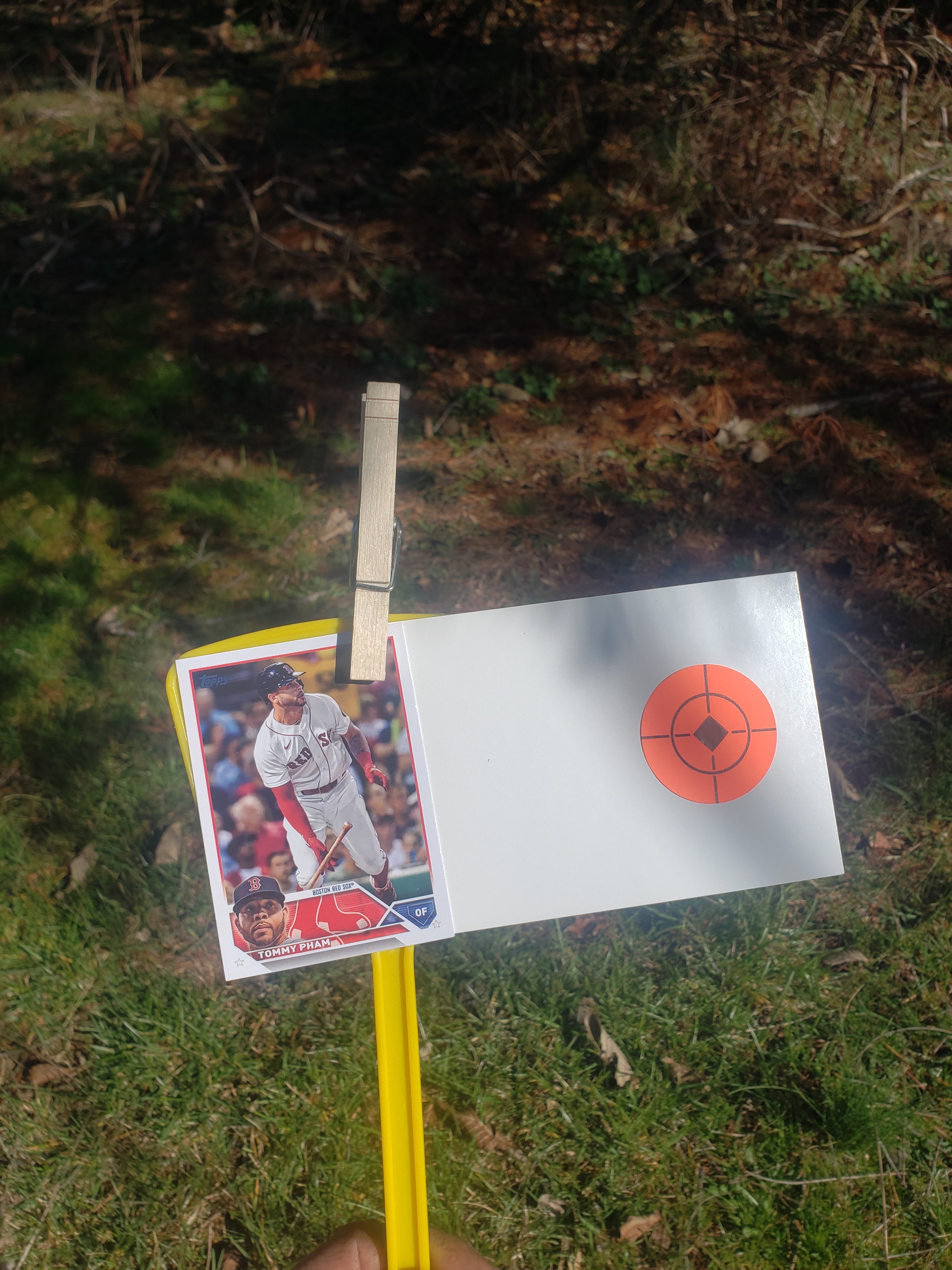

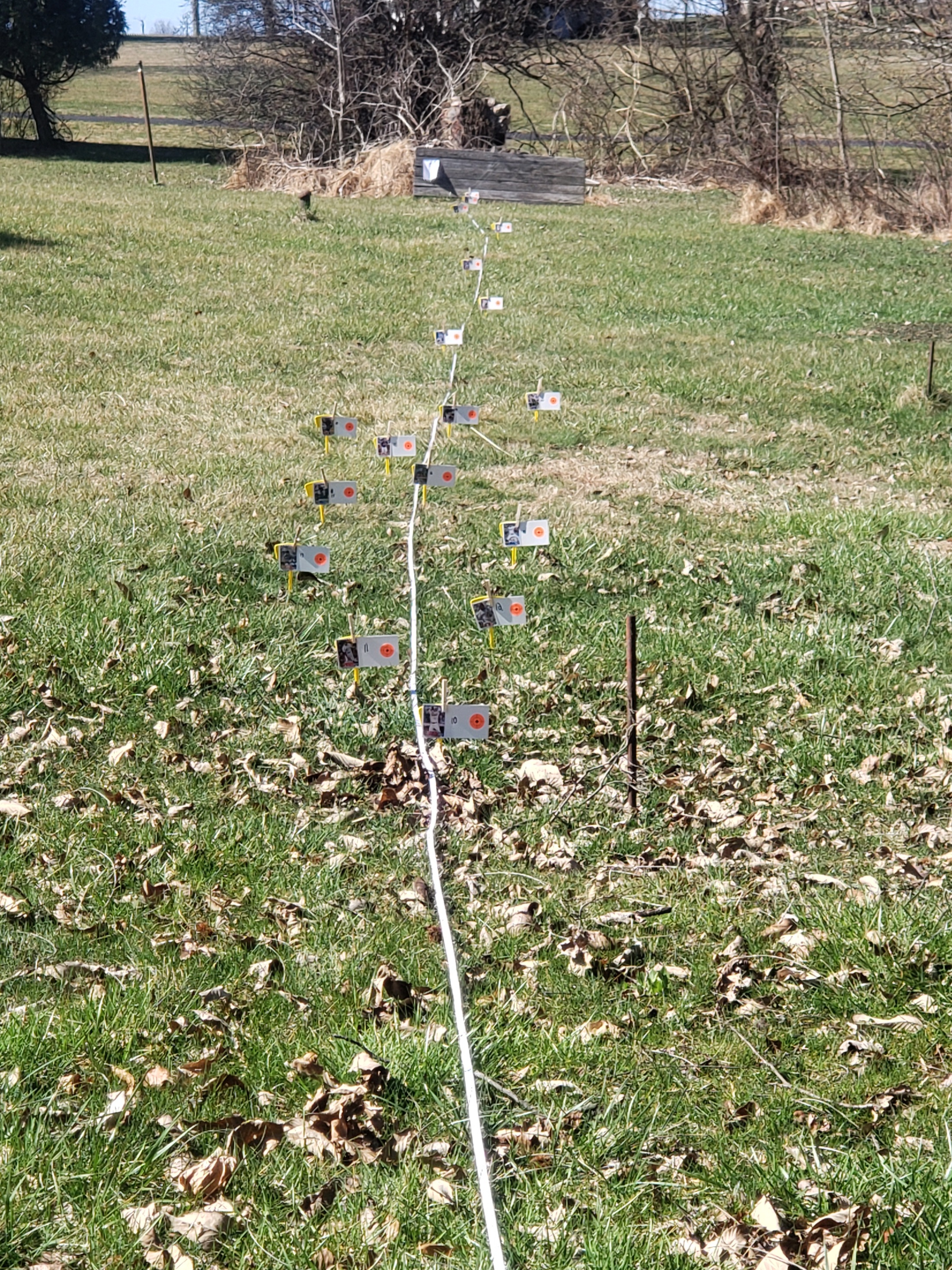

and then jammed them into the ground every yard from 10-20yds and then every 5yds out to 55. It worked great for getting my wheel setup and figuring out approximate DOPE at given ranges. This time around I did mark the cards for whatever range they were placed at but in the future they'll be completely random. Only a couple more weeks until the first match here!
🤔could you explain the use of your supplies to me? I think i get the concept...but still confused as to how this helps 🤷‍♂️
I'd honestly like to know more about how people use what they use and why. ... curious as to what others do that I could also benefit from🎩🤙
Basically the baseball card is just something to focus the scope on for ranging reasons. I got a new scope so had to setup my parallax wheel and this seemed like a good method, and it did work well.
From there I just had to holdover and take a practice shot at the target. The goal is to hit the 1/2" diamond under 20yds, the 1" inner circle at 20-40yds, or the 1.5" outer circle at 40-55yds

The other part I do similar to most, marking every yard from 10-25 and then maybe two/three yard increments. So 40, 42, 45, 47, 50, .... My Competition 40 has over an inch between 50 and 55, so it is very easy to extrapolate between 2 and 3 yard marks.

Once you get your wheel solid, I would get markings for 37, 43, 47 and 53 yards. I used to do everything past 20 at 5 yard increments, but the extra precision is worth the effort with a 12 fpe gun.
